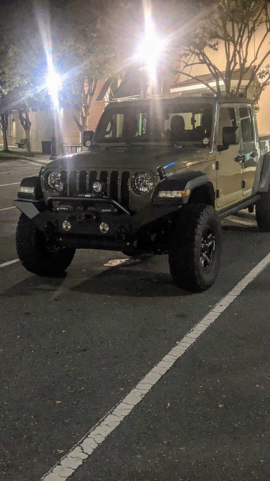

Mines drives great I got no issues or do I have to over correct. I can take my hands off the wheel at 70 and it will drive straight as a arrow. I'm at 15,000 miles on mine and unless it gets bad I'm not messing with it. I'm currently on 2.5" lifted and Rubicon take off suspension added to the front and the Rubicon fox shocks on 315 70 17 BFG KO2s. Also added the fox steering stabilizer up front. At is sits it's riding like and driving like a dream
