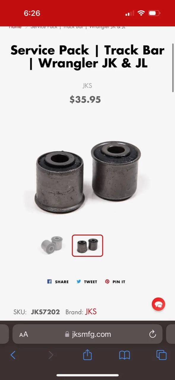

I had a nice conversation with a forum member last weekend about their JKS setup and how happy they are with it.
In the video on the link you provided they mentioned how they use the OEM style bushing. But, it's confusing because they call it a durometer bushing. Durometer is a measure of hardness (or softness?). They do talk about it being 'spongy' like the rubber clevite bushing of the OEM track bar, but a 'durometer' bushing is typically referred to in regards to a polyurethane bushing, from everything I have read thus far.
It sounds like they also make a HD version with a heim style joint on the axle side which is cool for those in more hard core stuff.
I would be interested in hearing some clarification on their OE style joints and if they really are a factory OEM style clevite joint or if it's just a softe durometer poly type joint.

Durometer seems like it’s just thrown out as some technical jargon with all these manufacturers.
The JKS looks like a normal clevite bushing if I’m not mistaken. The bushings are replaceable, interestingly, and look to have an outer metal sleeve. So I’m not sure if this functions a little differently than a stock bushing where it’s bonded to the housing, in other words can the jks bushing rotate slightly? Probably not due to friction?
JKS seems perfectly good quality btw so no knock on them.
I agree with you 100%. There is a lot of jargon out there, and very little specifications - which is why I made this thread because I am not satisfied with "just buy this it's great". I want specifics to ensure money spent is valid for my use case - and the same should go for others as well. So I tried doing some digging and kinda is the purpose of the original post to try and outline various types of joints in different manufacturer's components - hopefully it helps others also.
Which reminds me to add JKS to the original post!!
Maybe I am wrong but it's the OEM arms/track bars built with a press in clevite bushing? Or is the bushing actually bonded directly to the arm?
Seems to me JKS offers a solid product as well and kinda seems like they are overlooked some.
I like how you do your homework!
The OEM arms have the bushings bonded to the housing, they are not replaceable. So as your suspension cycles the rubber twists and limits flex. Which makes me wonder if there would be any rotation of the JKS bushing (and more flex), or if it’s pretty immobile once pressed in like OEM. Doesn’t look like that’s a designed-in feature though so I’m guessing it doesn’t really rotate.
All the freely rotating aftermarket bushings like teraflex IR, Clayton giiro, metalcloak, etc. flex more than the OEM because they don’t have that torsion build up, and they market it as such.
As someone said, does that matter for the track bar??‍♂
Interesting I haven't looked at the OE arms close enough to see if the bushings are removable or not. But still seems to me it would be easier to find a OE part to replace a worn OE part in 10 years than something else. Maybe not but just my assumption.
I think rotational force for a track bar is actually there. The track bar will move up and down as the suspension cycles, so the bushings will need to pivot. I certainly see how having OEM style bushings, with having restrictions there, will prevent maximum movement as the bushings won't want to rotate as the suspension droops or compresses. But that's a compromise in order to have low NVH I think. The only way to truly know would be to have two vehicles outfitted side by side and do a functional test. But like you said - maybe it's not even that big of a factor? I guess it depends on how much rotation of the bushing is even necessary and if the OEM bushing rotates enough to allow the suspension to fully cycle.
