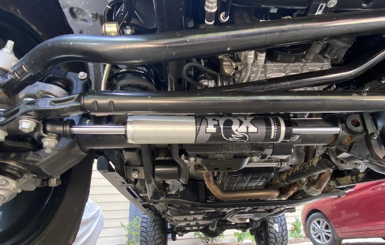

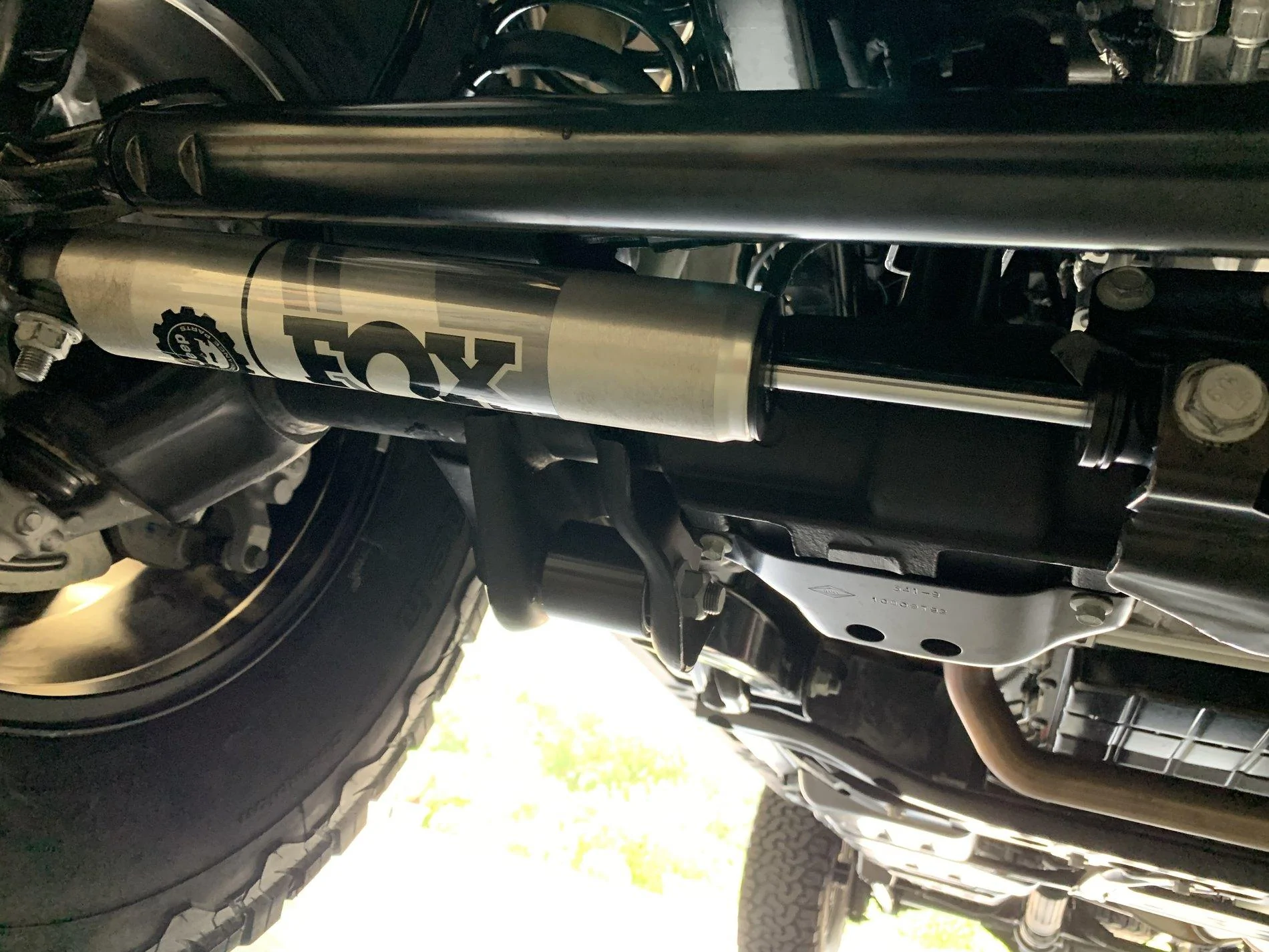

Installed my Fox 2.0 TS steering stabilizer this afternoon and I have to say, it’s night and day difference!!! Worth every penny! It didn’t take out all the slack in the wheel, but it did take out a good bit of it, and it stiffened up the steering, handles bumps and ruts on shitty roads without snatching the truck into them (like it did before) took out ALOT of the over-steering issue (because it is a stiffer stabilizer), drives WAY better off-road, and allows me to drive on road with 1 hand, without constantly adjusting left & right. It now drives and handles like a normal vehicle. I'm not saying it's a cure-all, but it damn sure helps out! I could imagine how much better it would be if I installed the Synergy steering sector brace, too. That would be like driving a stock car (compared to factory steering).
Those worried about the mounting bracket design need not worry, that sucker mounts so precisely, I had to tighten the bracket screws down a little at a time, alternating, just to get it to go down over the machined-in swage on the shock mount bracket...There is beyond ZERO play, it fits so snugly. You also remove the factory bracket from the axle and use the 3 factory 13mm bolts to mount the new bracket onto the axle, and reuse the factory carriage head bolt, and 18mm nut on the knuckle-mounted side.
Very quick & easy install. Make sure you have a 1/4” Allen wrench. If you have one for your impact, it will make things even quicker.
Here's the one I ordered from Amazon... The first picture on the page is wrong, that is the JK mount (tie-rod mount) version, which is not the correct model for the JL & JT... The other pictures show the correct one. And the one you order in that link IS the correct model for the JL/JT. :like:
