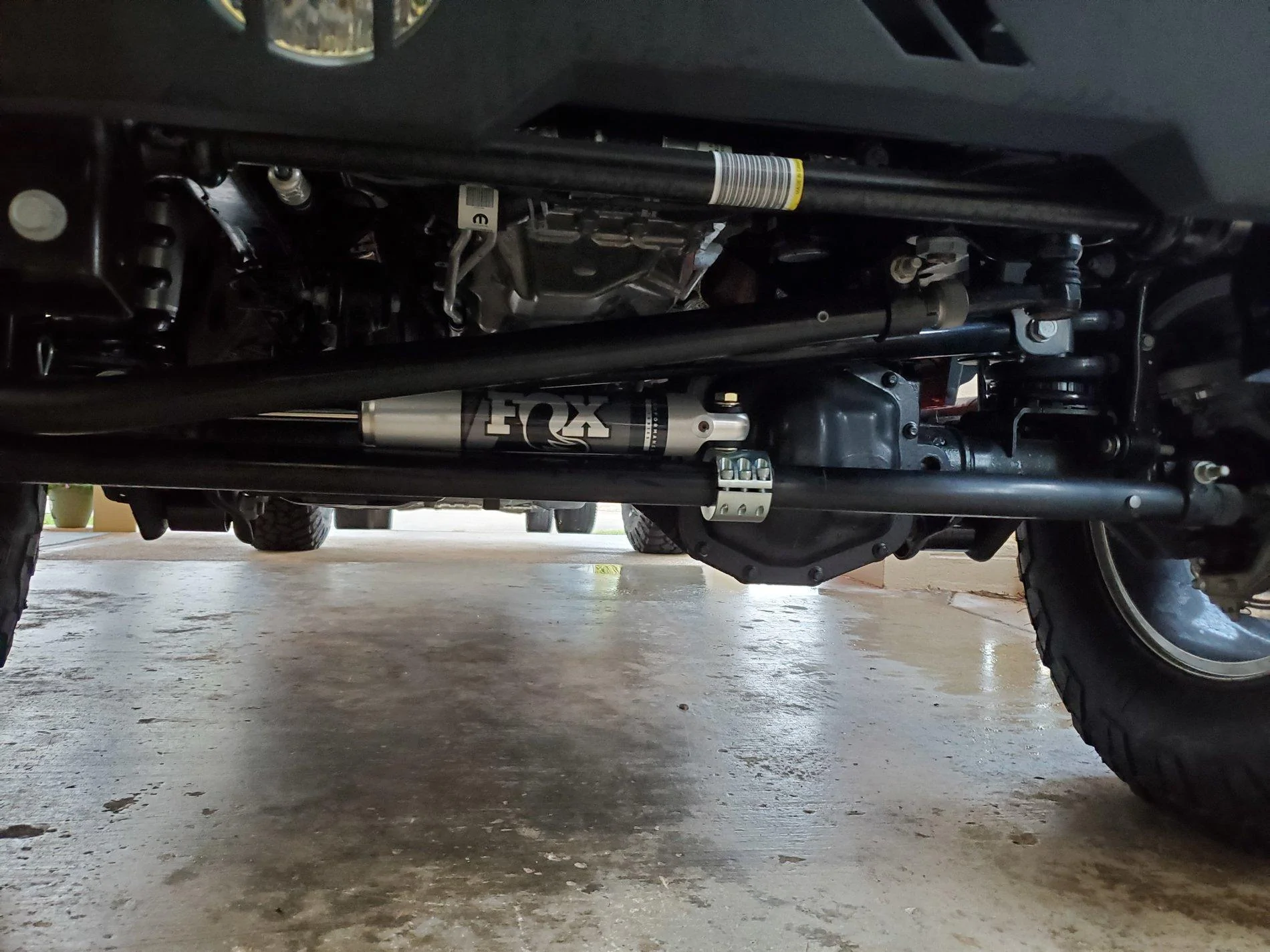

Just be aware they all hang below the axle. If you do any off roading you need to look into a relocation kit. Those shocks have brackets made for the stock location.

Here's a picture of mine... I have the TS model ($300 model). Same as the ATS, just not adjustable.
