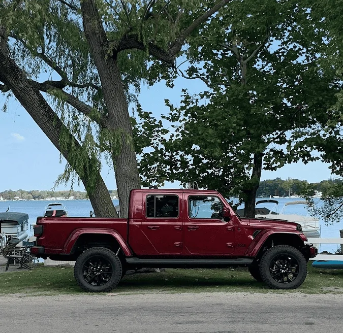

I don't think you have to be too concerned about the towing capability impairment from bigger tires and a lift since you are well under the max.
I did a 2.5" Clayton lift and 35s on mine. Just for looks, it's not going to be wheeled. I wanted more lift than a leveling kit.
