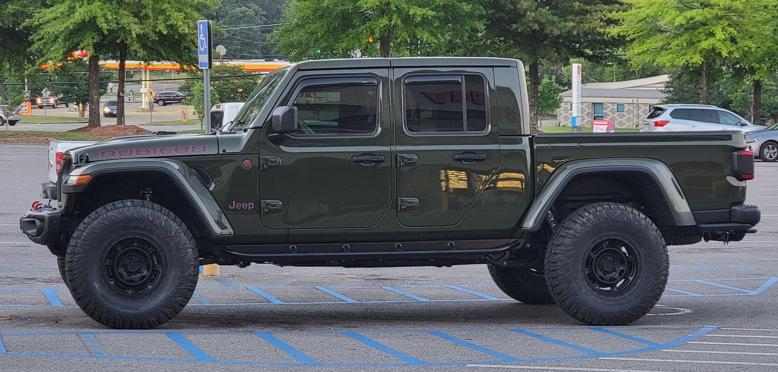

Hey bud, going through this now with my diesel on the Mopar lift. I was left with a rake of an 1"+... I really want it level, but I dont want to deteriorate from the ride or cause more issues. So maybe as long as I have the MP lift, will I have to live with it ? Did you ever figure anything out or am I stuck with a rake ? Thanks
Edit: I read to the bottom of the thread.. great idea.. right.. lol seems adjustable control arms and a adjustable track bar and possibly different bump stops is the cure to add a leveling kit...to a Mopar Lift... is this correct ? At this point, I might just call it a day and enjoy my JTRD.... I think it looks pretty good...
