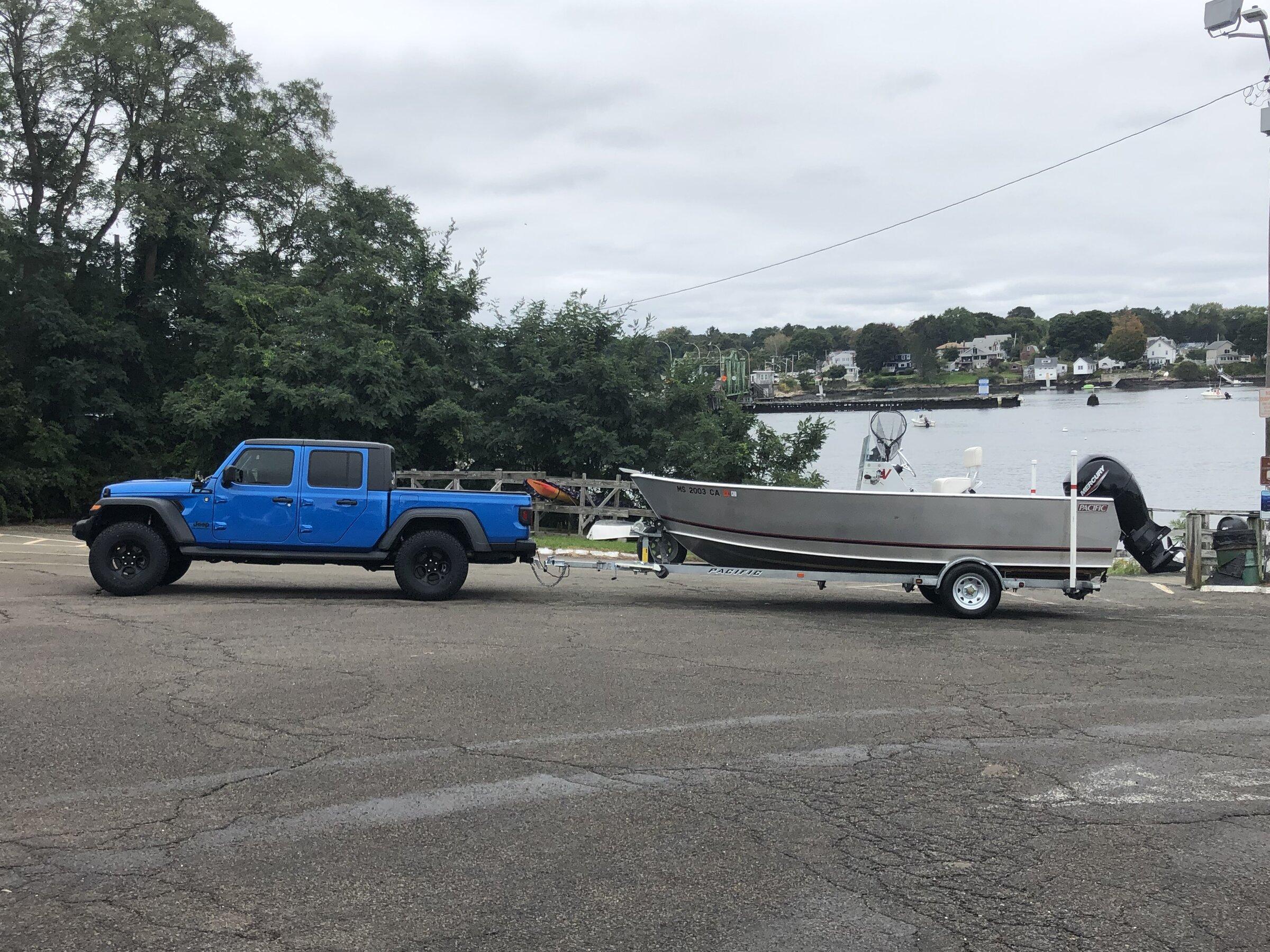

I have 1.5” spacer front .75” spacer in back, the boats I tow are around 3000-3500lbs, around 10% tongue weight. Still looks pretty level IMO with the trailer attached.
