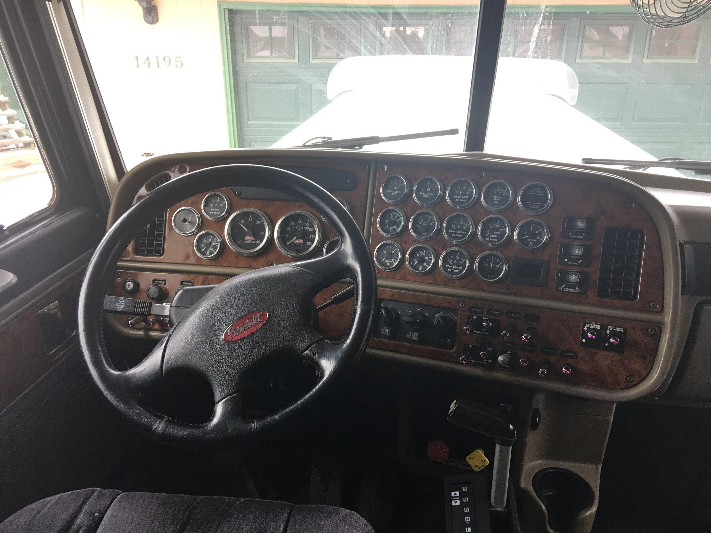

Gauges, if you pay attention to them and drive accordingly will save you a lot of heartache and money in the long run. "IF" a person could buy the Gladiator with the V8 now being offered in the Wrangler that would make this whole topic mute, "IF" your willing to pay $75K+ which I am not.
As an example, this is the dash of my Pete, 22 gauges and everyone of them has a purpose, I can tell long before it becomes a problem if something is not right in the engine, transmission or either drive axle, fuel system, air intake system, electrical system or air system, it's ALL easily monitored BUT only if you read the gauges and drive or perform maintenance as indicated.
Jeep Gladiator Introduction and towing question. IMG_2632
Gauges, worth their weight in gold but only if you pay attention to them.

Thats a busy dash! There is a Bluetooth module on amazon with an app for extra gauges. Trying to figure that one out - just got it yesterday. Someone on the forum also sells a dashboard that might be better. To your point going to learn to use it first before upgrading.
I lurk a lot on the wrangler forum and the derating issue isn't as front and center as it is here, at least feels that way. Obviously different use of the two trucks, but same motor.
