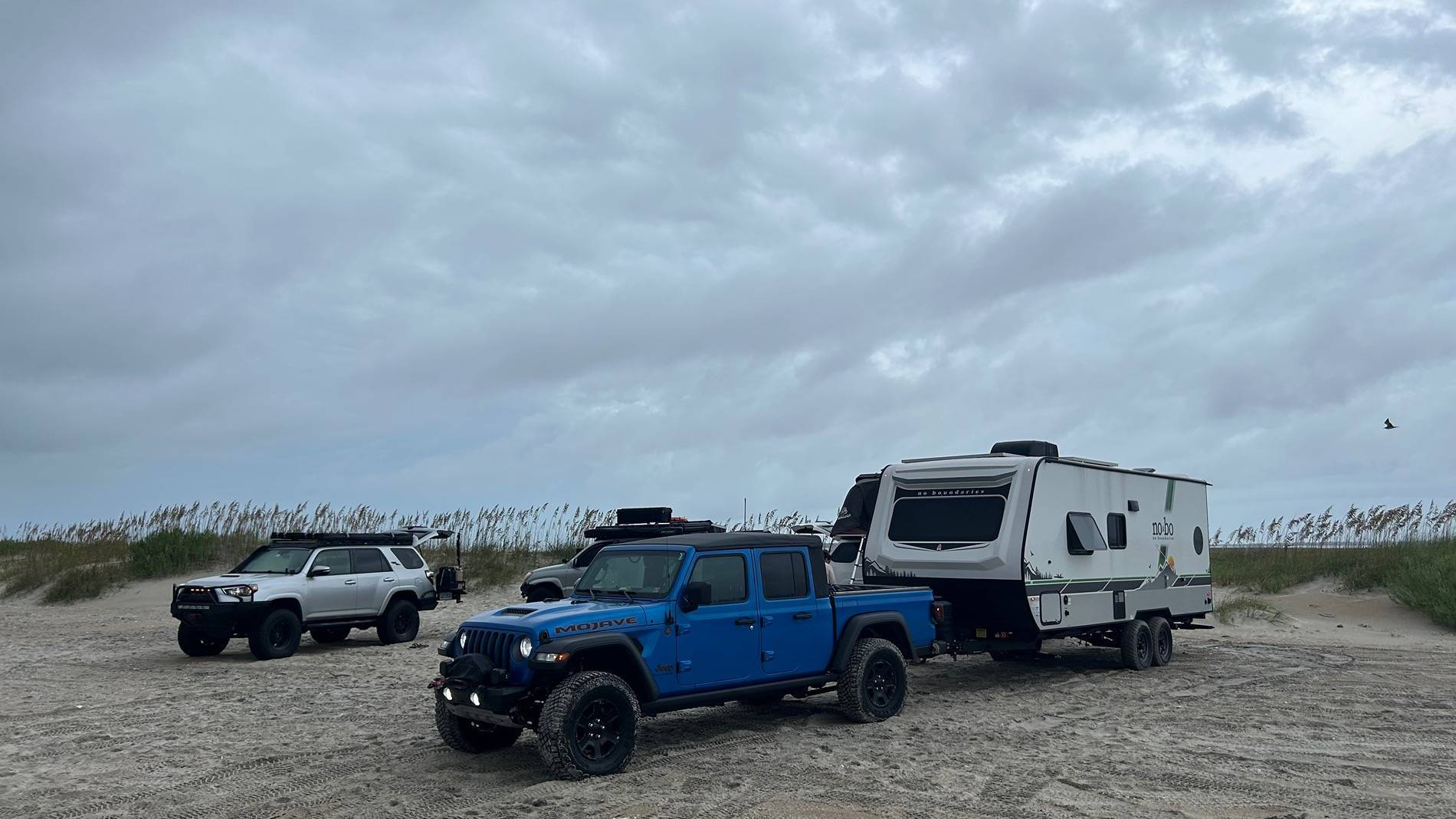

I have the Vantage Sonic SN220VRB. It's 27' long and around 5,100 lbs with all we want or need loaded in...food, clothing, living things like dinnerware, pots/pans, etc. It has a stated 425 lb tongue weight so I am estimating around 525 lb tongue weight with all in the front pass through. I do tow dry in that the tanks are empty. Sometimes I'll put a few gallons in the FW tank for in case we need to stop somewhere and use the toilet and it's not a suitably equipped rest area, so we can flush but otherwise...plus, my FW tank is right over the twin axle so it really doesn't contribute to tongue weight, just overall towing weight.
I have the BlueOx WDH set up which also does well with sway control, and the Tekonsha Primus IQ10 brake controller. As far as rear droop, I once measured the bottom of the receiver to the ground, then hooked up the trailer. Droop was ~1.5". Hooked up the WDH and remeasured. Droop was only around 3/4". The front end feels just as planted as if I wasn't towing anything.
As far as driving, I shift the trans manually and never see 8th. It does remind you that it's only a V-6 but it does it's job. I typically run the interstate at not more than 65 MPH in 7th at around 2,100 RPMs. Going up a grade, when speed drops below 59 MPH, drop a gear at around 2,800 RPMs until I crest the grade and am back up to 65 MPH. Steeper grades, sometimes I'll need to drop to 5th and am around 3.500 or more RPMs. I really don't care who is behind me as if they don't like it, they can go around. It's MY drive, not theirs. Temperatures, even when it's 95 degrees out, temps don't go higher than 220 (as seen on the off road page in my display, I have the 8.5" with Nav).
As far as carrying in the Gladiator, it's generally a beach umbrella a couple of lounge chairs, me, and the Bride (and of course snacks to nosh on while driving).
I typically get between 12 and 13 MPGs towing. Overland, ordered 5/19, delivered 7/19. Most of my driving has been east coast so, relatively flat. Eventually will head northwards like the Poconos or New England like Maine or something. Would like to see Acadia National Park sometime.
Good luck with yours and enjoy.
My rig :) :) :)
Jeep Gladiator Towing question 2021-Venture-RV-Sonic-SN220VRB-Travel-Trailer-Floorplan
Jeep Gladiator Towing question Front Yard Pic

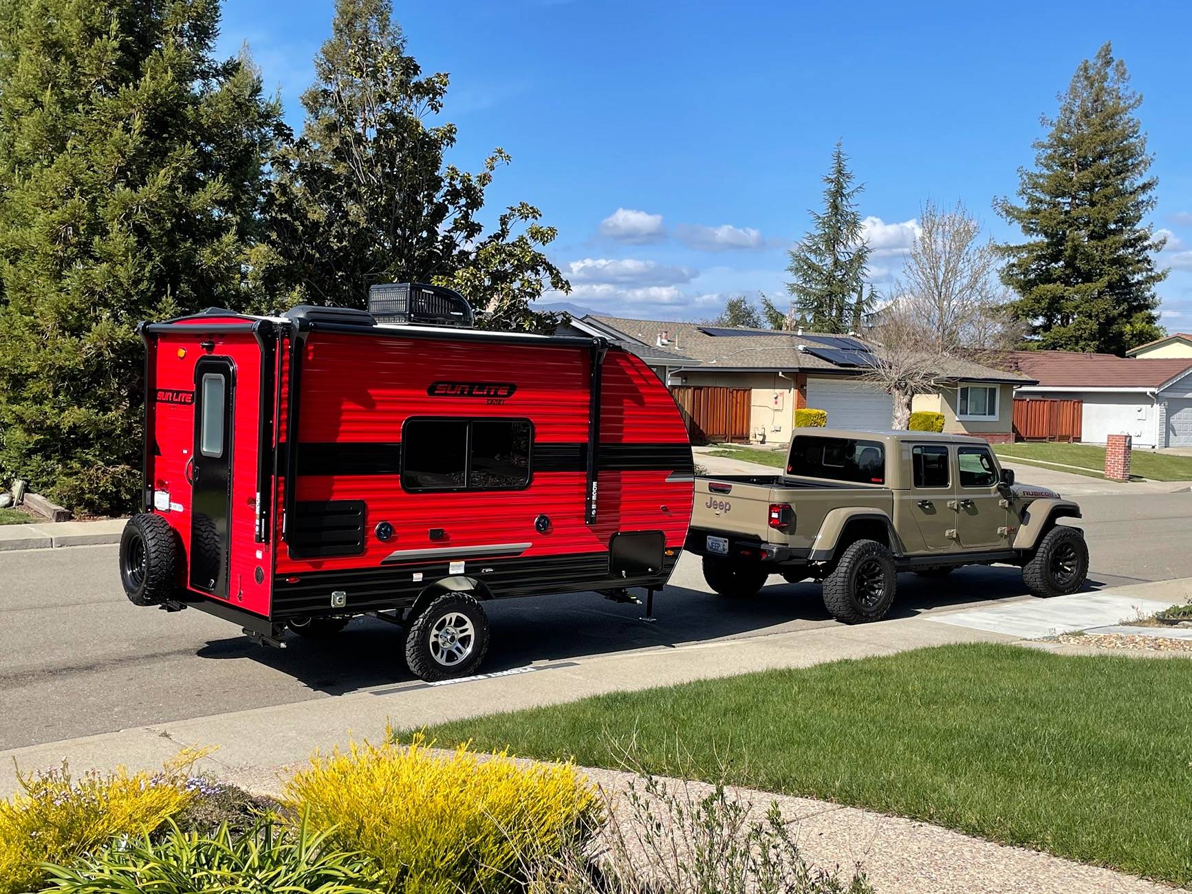

I pull a sunlight at 2500 dry weight. Lot less so can't comment as much but the gas mileage! Yikes! lol I am running 35" tires and lift. If the gladiator gas mileage was bad it's way worse pulling. I think I get about 9 miles to gallon. Probably not your concern as much as if it can do it or not.

Its fine. depends on you're tolerance and towing skill for sure tho.
How well does your JTM haul that camper? I'm looking at a Intect Flyer Explore which is like 1600-2100lbs dry
for me? GREAT!!!! its the little blue truck that could. for everyone else? 9 mpg avg, 5-6th everywhere at 3k plus doing 55mph tops. probably not a fun time. I don't expect my truck to be a towing beast. I just expect it to actually tow when i ask it too. and thats enough for me. Its on 4.88s now so i'll have to see how much better towing the nobo gets. 2100lbs isn't light but easily achievable and comfortable in my book.
