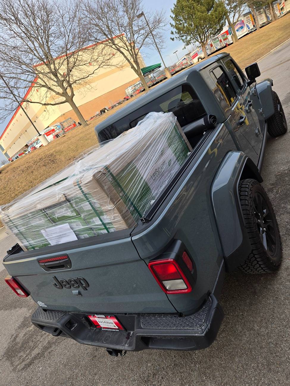

On a somewhat similar note , I just put a pallet of hardwood flooring weighing 900 pounds into the bed. Sticker on door says my payload is 925. Maxed out and didn't really feel it. I had my f150 at max before and felt every bit of it. The jeep at max (925) didn't feel sluggish, didn't squat that bad , turned fine , etc. I think jeep was a little conservative with their payload numbers .
I brought home, the first time, ~900 sq.ft. of 3/4" Oak hardwood flooring. Filled the bed, completely plus around 5-6" over the top, well strapped in with gate down. I guestimated it was around 1,200 lbs. My Gladiator (Overland, ordered 5/19, delivered 7/19) didn't even know it was there. Later on, I bought more of the same to finish the house (2,600 sq.ft. home). Two trips with the bed full PLUS, a 5' x 10' utility trailer full of the same. Zero issues handing all that.
There was another time I brought home some stockade fencing, 6' tall, and I needed 6 panels. Laid it over the bed rails and strapped it down. Got it home, no muss, no fuss. Had to drive about an hour and 15 (each way) because that was where the closest Lowes to me had it.
