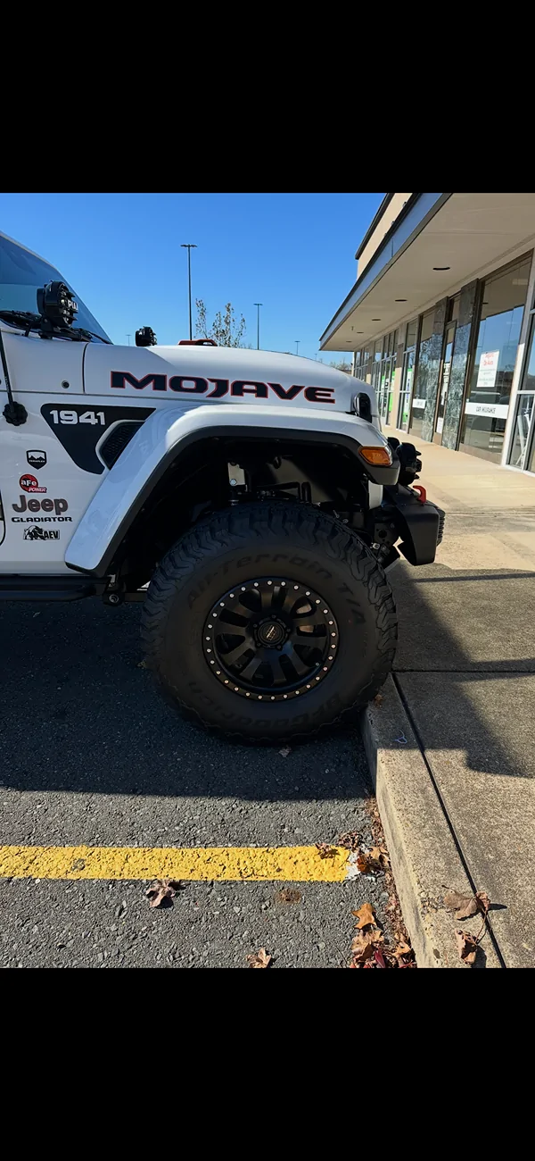

I was in the same situation. 1.5inch or rake on my Mojave after the AEV 2 in spacer lift. I replaced the spacers in the front with Teraflex 3 inch spacers and removed the 2in AEV shock extensions and replaced with Metalcloak 3 inch spacers extensions.
Thanks for the direction. I like this idea better, because I originally wanted to go with a 3.5" lift, but wanted to keep with the stock shocks. This is a great alternative.

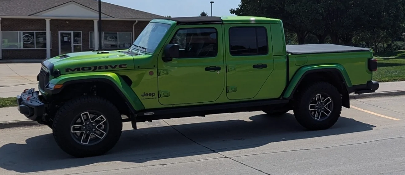

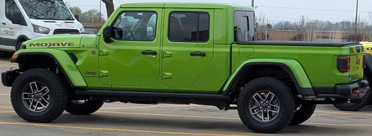

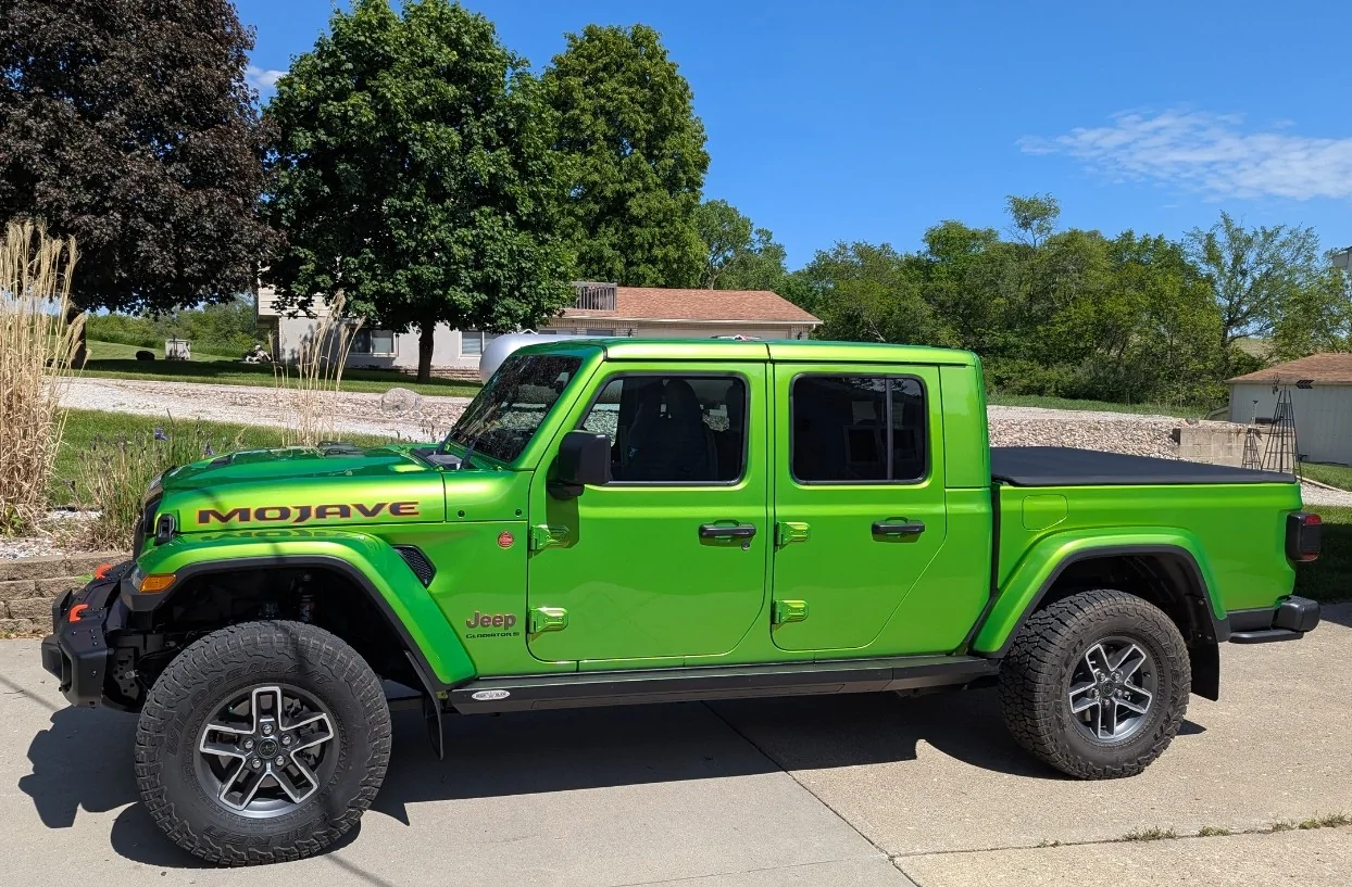

Jeep Gladiator Leveling Mojave with a AEW 2" Puck Lift 1758844979357-mc
From Motortrend -
Jeep Gladiator Leveling Mojave with a AEW 2" Puck Lift 1758845031107-y6
Jeep Gladiator Leveling Mojave with a AEW 2" Puck Lift 1758845072205-ni
Jeep Gladiator Leveling Mojave with a AEW 2" Puck Lift 1758845104588-fr
I have to stand on steps to get to things that can easily be reached on a Rubicon.
A Mojave sits very level. I'd say mine was perfectly level before the winch and other stuff got added.

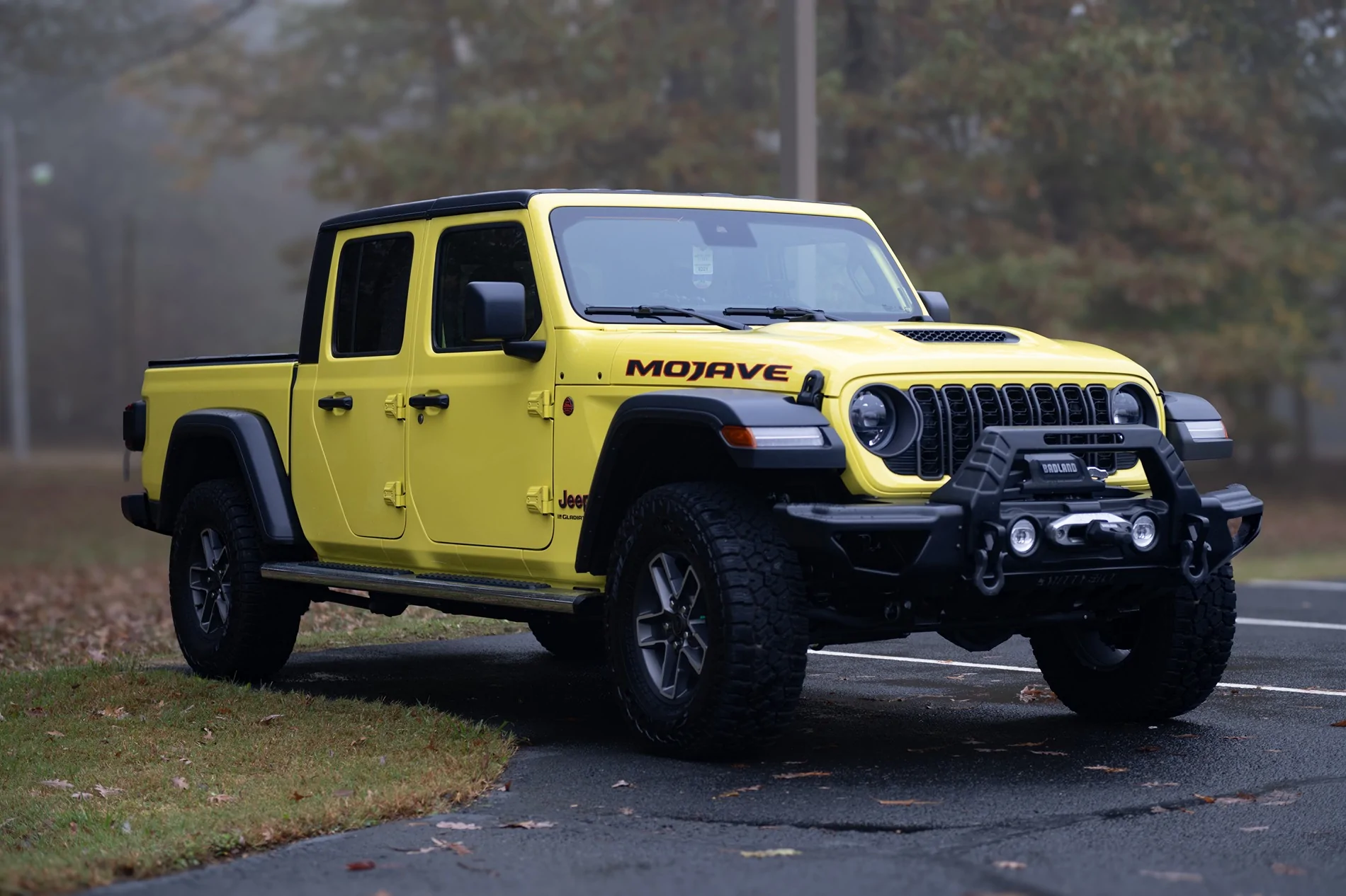

I installed a 3.5" lift on my Mojave that had shock extensions and allowed me to retain my stock shocks. Obviously, this limits suspension travel a little, but I was okay with that. I found that after the lift, the front of my Mojave sat higher than the rear, so I added a spacer to the rear to bring it up to level. I've been extremely happy with the results.
Jeep Gladiator Leveling Mojave with a AEW 2" Puck Lift DSC_1158 (1)
40,442
53,859
Dang, that looks sharp! Colors and all.
Makes sense - my Mojave stock had 0 rake.
