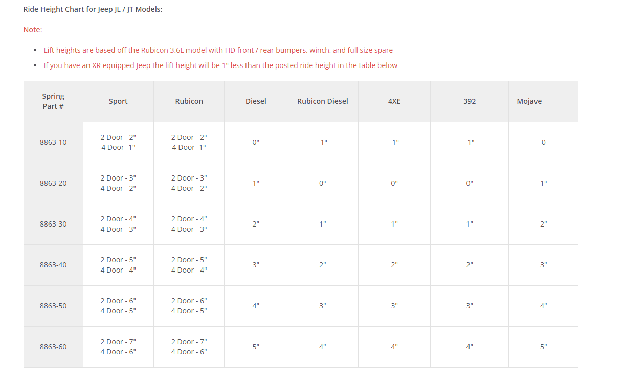

This is Synergy's chart for the front and it makes sense to me.
Jeep Gladiator Mojave 2 inch lift with synergy coils 1722430291731-nm
I don't see why the 2" lift coil won't get the job done if it's based on rubi weight like they say.
Personally if i ever lift, I'm getting the PRO-X Rocrawler with quad rate springs and Fox elites. Till then a revalve for my specific weight and tire size is about all ima mess with cus the stock stuff is pretty dang good. If you do get springs and swap em out, I'd would do extended mopar LCAs while your in there. the caster gain is so worth it.
edit: just realized you are on a 2in lift. I'd concur with Synergy's recommendation
