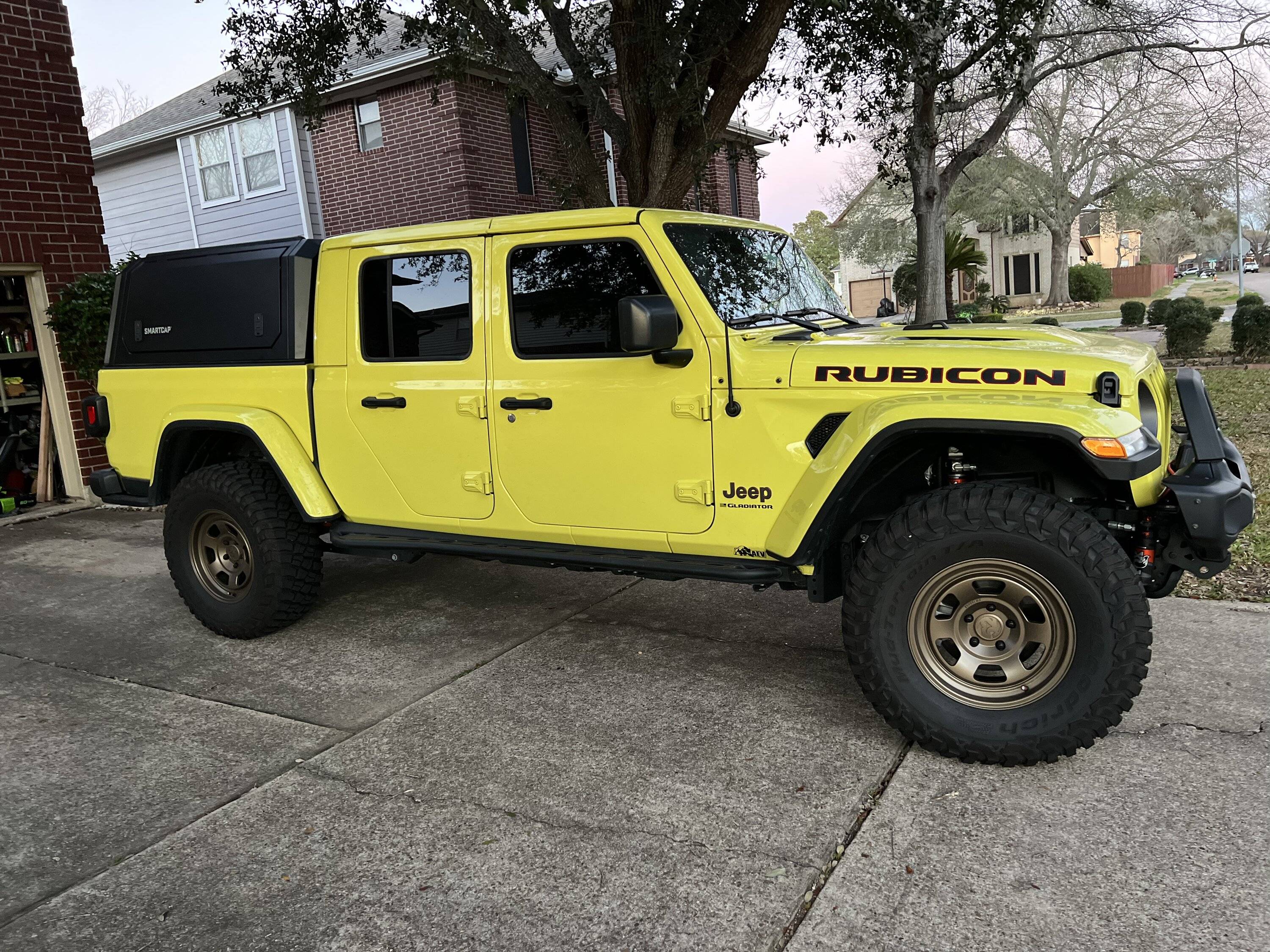

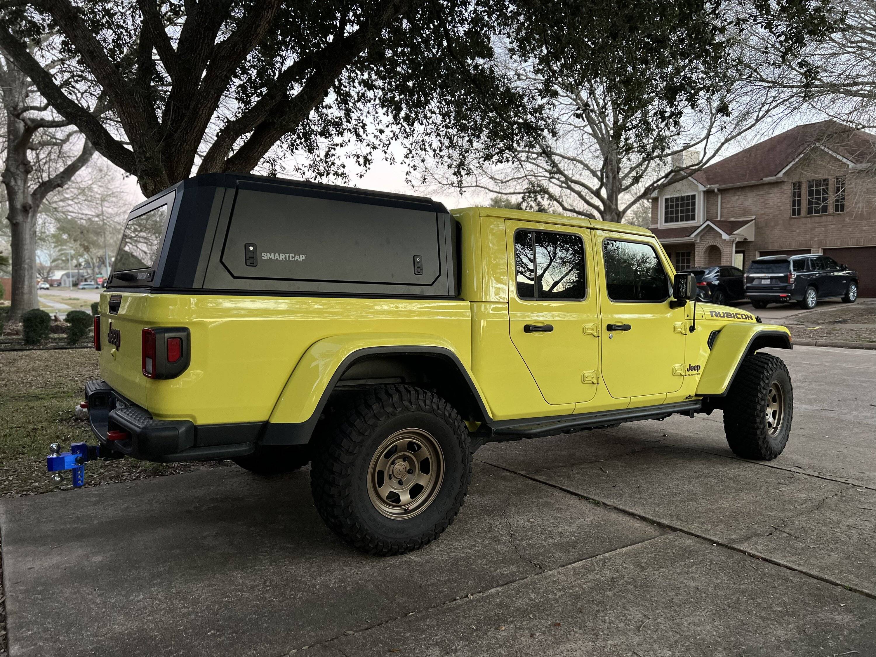

It’s not a Mojave but my Rubicon i just put 1.5” spacers in the front and didn’t have to do anything else because a small level. Then i put Fox 2.5” adjustable shocks for 0-1.5” lift all around. 35/12.5/17 BFG KM3’s and that’s all i want.

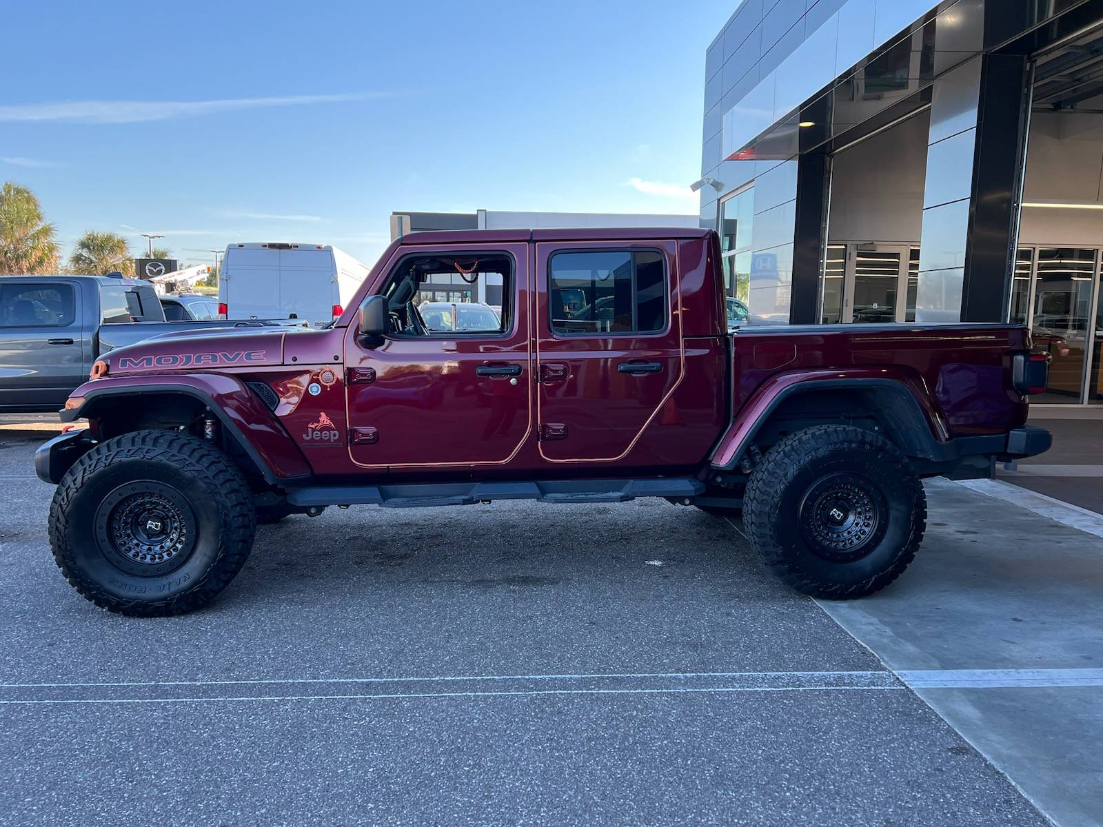

I don't get this mentality, you aren't saving anything by running the 33s until you have to pay a disposal fee for them. I sold the 4 falkens off my 2023 mojave with 2000 miles on them for $600 in 2 days on marketplace. I was lucky enough to score the $94/tire 37s from the Walmart sale so I actually made money going from 33s to 37s. I think it looks perfect with the 2" aev kit and 37s.

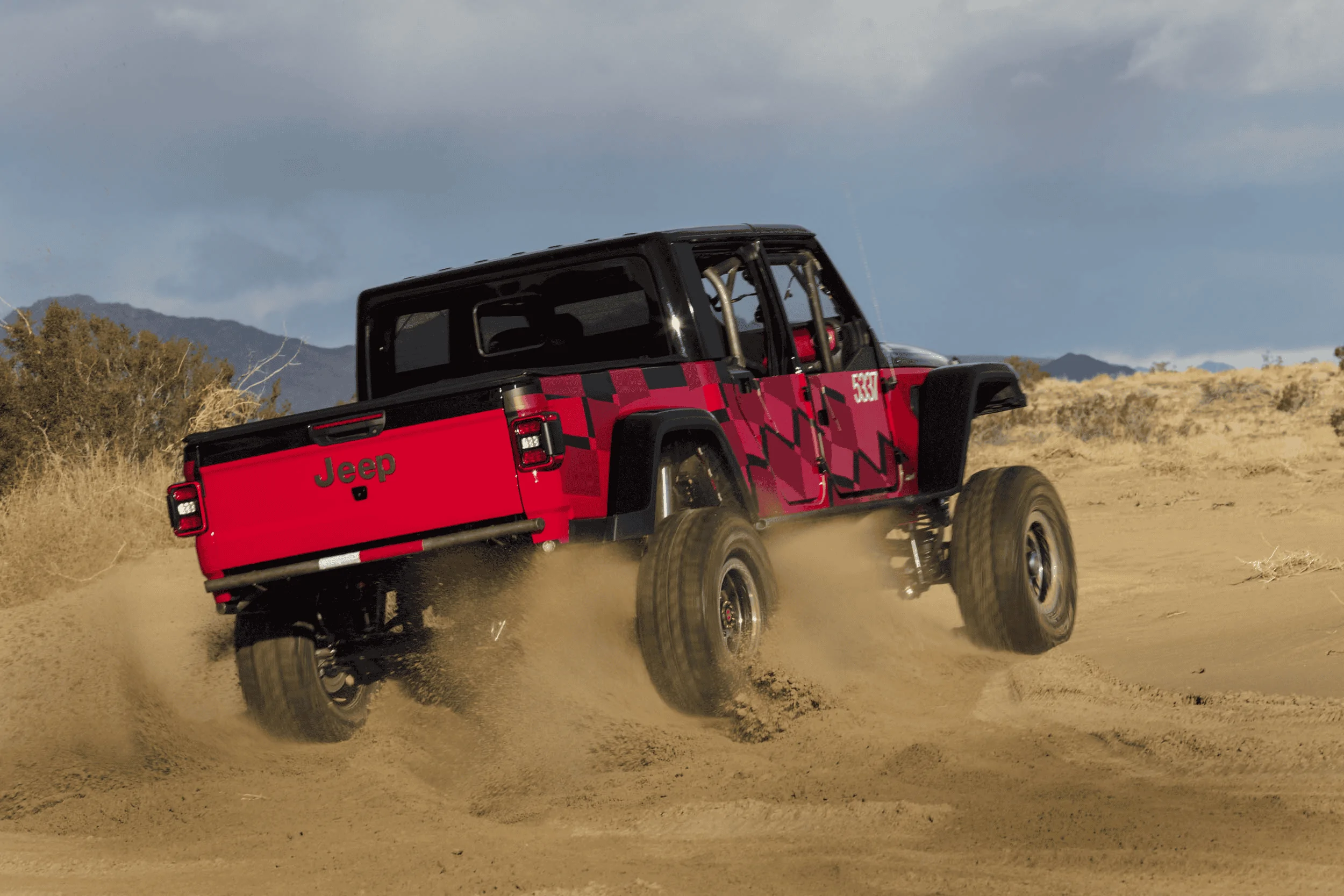

Some might then ask, what about the gladiator that finished KOH a few years back:

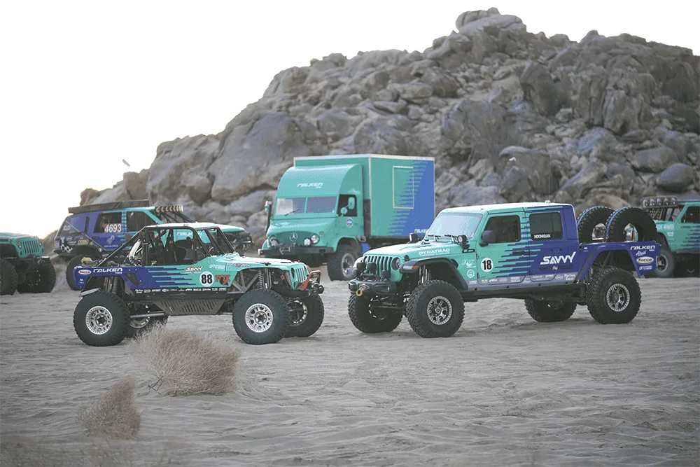

Or this one:
Class limited to 35" tire, but the trucks are sky high. "Bonanza, wouldn't these race cars know more about this than you?"
And you're right. They are tall race trucks. But, part of the reason they are that tall is for the purpose of having uptravel through the fast desert sections. Ideally, without the tire limitation, a 37-40" tire would be ideal, with a concession made for uptravel in the desert.
if this was done today, i would expect the factory race offering would be equipped with Weld74 portals and a much lower lift.
I think you have conflicting ideas? They run extra lift for uptravel, running portals gives the lift and 0 extra clearance for uptravel. Why would you want stock uptravel, 4" of lift, and only 35s? I see 0 gain in the desert there. Add the massively increased torsional forces on axles and control arms when the tires impact obstacles and portals are about the worst idea for desert racing in my opinion. The wheelbase on the JT is massive and breakover is terrible even on 35s. In my opinion they ran that much lift because the rocks in Johnson Valley are BIG and they needed the extra clearance and the extra uptravel for the high speed sections.

Savvy builds some cool rigs. They have been pretty successful at KOH and JV. You are right on why they sit a little taller.

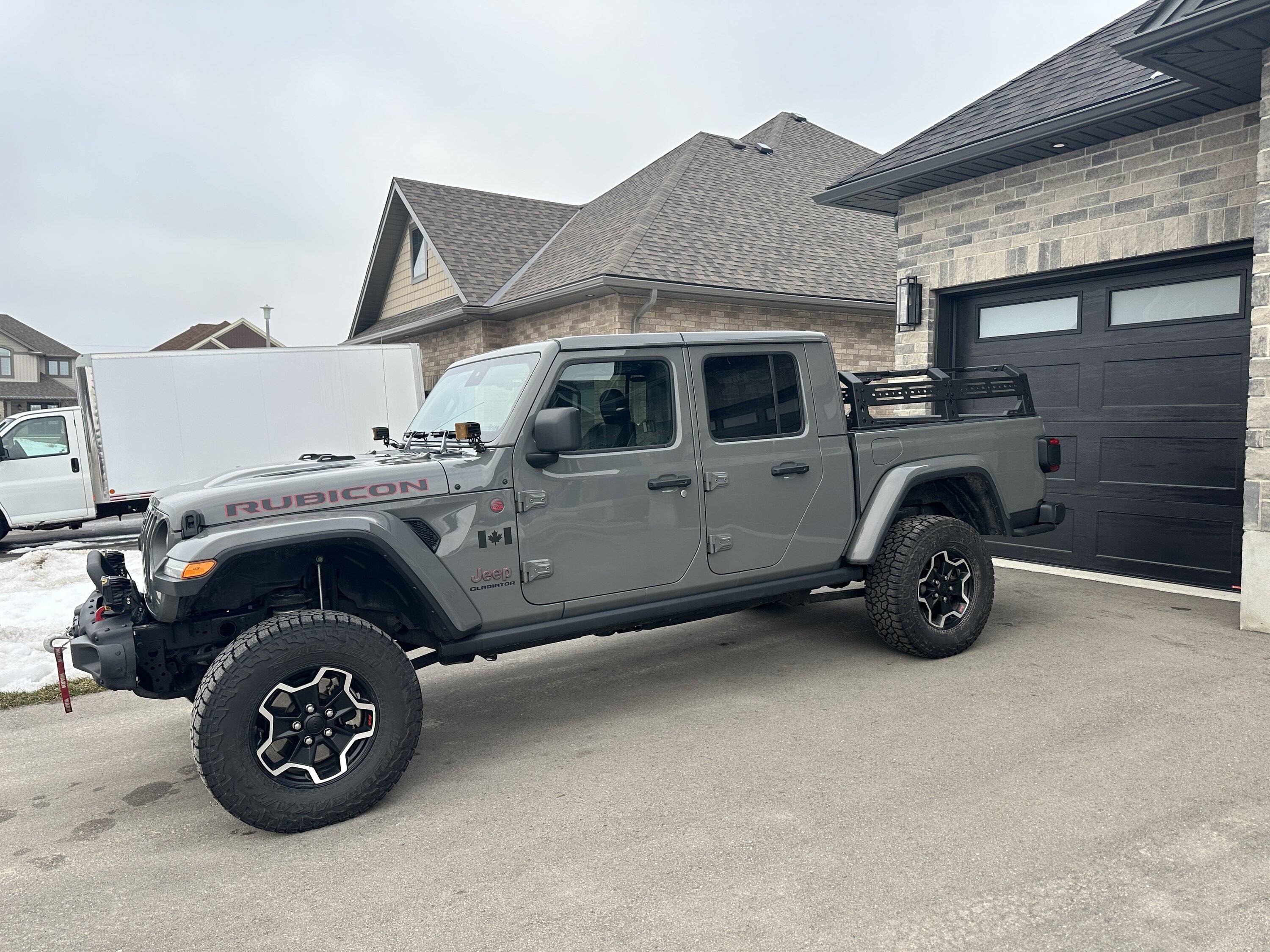

I’m running my stocks for the winter on a 3.5” lift. Got 37’s for the summer. I’m not a huge fan but I’m not going to waste these tires either

What tires are these, your truck looks great with them on it.
I have to upgrade to 37" tires, I have 35" and I am lifed about 3" in front and 2" in back and it looks like I am on Donuts ?

Kanati mud hogs. Only lifted the truck and went to 37s because Walmart had that ridiculous sale last year at $94/tire. Run the same tire in a 39 on the wife's JLUR but they were $400 each.

Thank you. I am tossed between them and Geolanders G003. The best price I found for the 37 Kanati mud hogs is about $1200 for 4. The Geolander G003 are about $1000 more... So the Kanati will probably win.
