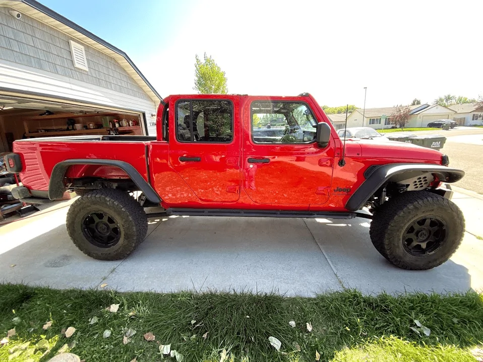

Gotta take into account my bushwacker fenders... But 35's with the Clayton 2.5" lift

Yea I get that they would fit stock or without much. I just want to eventually move to 37's and would like a bit of a lift before having to do gears. Payload probably is a concern but towing is not really an issue. I was thinking I could get away with a mopar lift maybe with a small spacer and be good. The adjustable track bars would have to be added. The mopar does the lower arms but the clayton does the top. Not sure why you would think the lowers would have to change a bit if you are dropping to keep the axle forward.
