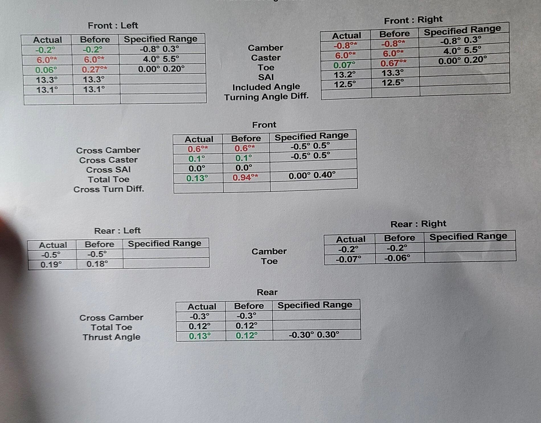

I installed a 4" readylift lift on my Gladiator Mojave this weekend. Today I had it aligned and I have some questions. The tech said that my Caster should be between 4 and 5.5 degrees. I believe he was using stock numbers (I know he was). My actual number is 6 degrees which I believe is perfect for a 4" lifted gladiator. The readylift Mojave kit I installed came with new control arms specifically to get the castor to 6 degrees. Can anyone confirm the optimal caster angle of a lifted Mojave? I've heard 6-7 degrees is what I should be shooting for.

Hi there, my Rubicon Diesel is in the alignment shop as I write this, It has a 4.5 front and 3.5 rear Clayton lift kit with all arms done. We are shooting for a 7 degree caster angle. 5-7 will make your truck work well. Enjoy.

In my experience with Wranglers, any recommendations for caster was purely for pinion angle. The stock caster number is usually the best the steering with ever be. Sometime you will fine a Jeep that likes something different, but for the most part, factory is where the steering wheel is the happiest, but the driveshaft is not. You must fine a degree where both work well. All of the vehicles that I have worked on for this issue have been Wranglers, so the Gladiator my be slightly different.

6 degrees should be good, it will have less wander and bump steer than 4-5 degrees, the range of stock caster JTs varies as different models have different spring heights but all use the same control arms, a Sport may have 5.5 degrees stock and a Mojave 4 degrees.
Are the control arms adjustable? if not there is nothing you can do about it without changing them.
