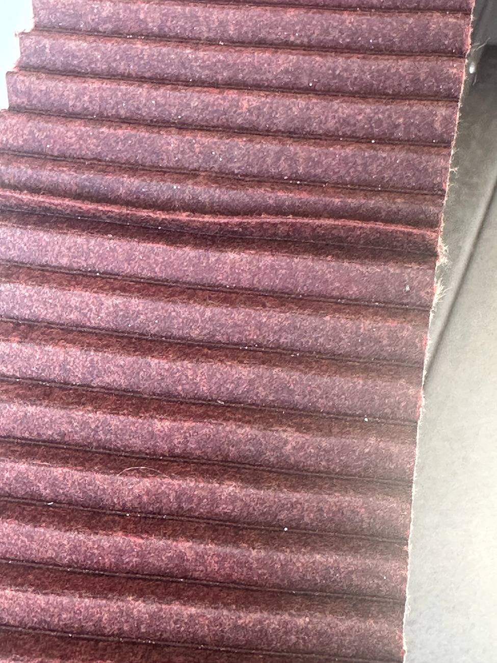

I think I am in the same boat as you. Bought a 2024 JT Rubicon Unlimited X back in January of this year. I think I started hearing a tick around 500 miles. I went on a prolonged trip back in June/July and put about 3000 mile on the truck. As friends came and took a look at my Gladiator, almost everyone asked is that a diesel? Went on another trip, but because of the tick, took a different vehicle since I would be in very remote locations. I have a service appointment for the Gladiator on the 29th of July. I have 7999 miles on the truck at this point. My second oil change was at 5100 miles, so the filter has been on 2899 miles Today, I decided to cut open the oil filter and metal flake is apparent. Also attached a video of what my Gladiator sounds like. Hoping my dealer is able to fix this soon, as planning on taking the truck cross country. Had the same issue on my JK at 60,000 miles and repaired it myself. Hard to believe this Gladiator has this problem so early in life. Have to wonder what is going on at Jeep, at least I am under warranty.
Jeep Gladiator Lifter tick? IMG_4503
