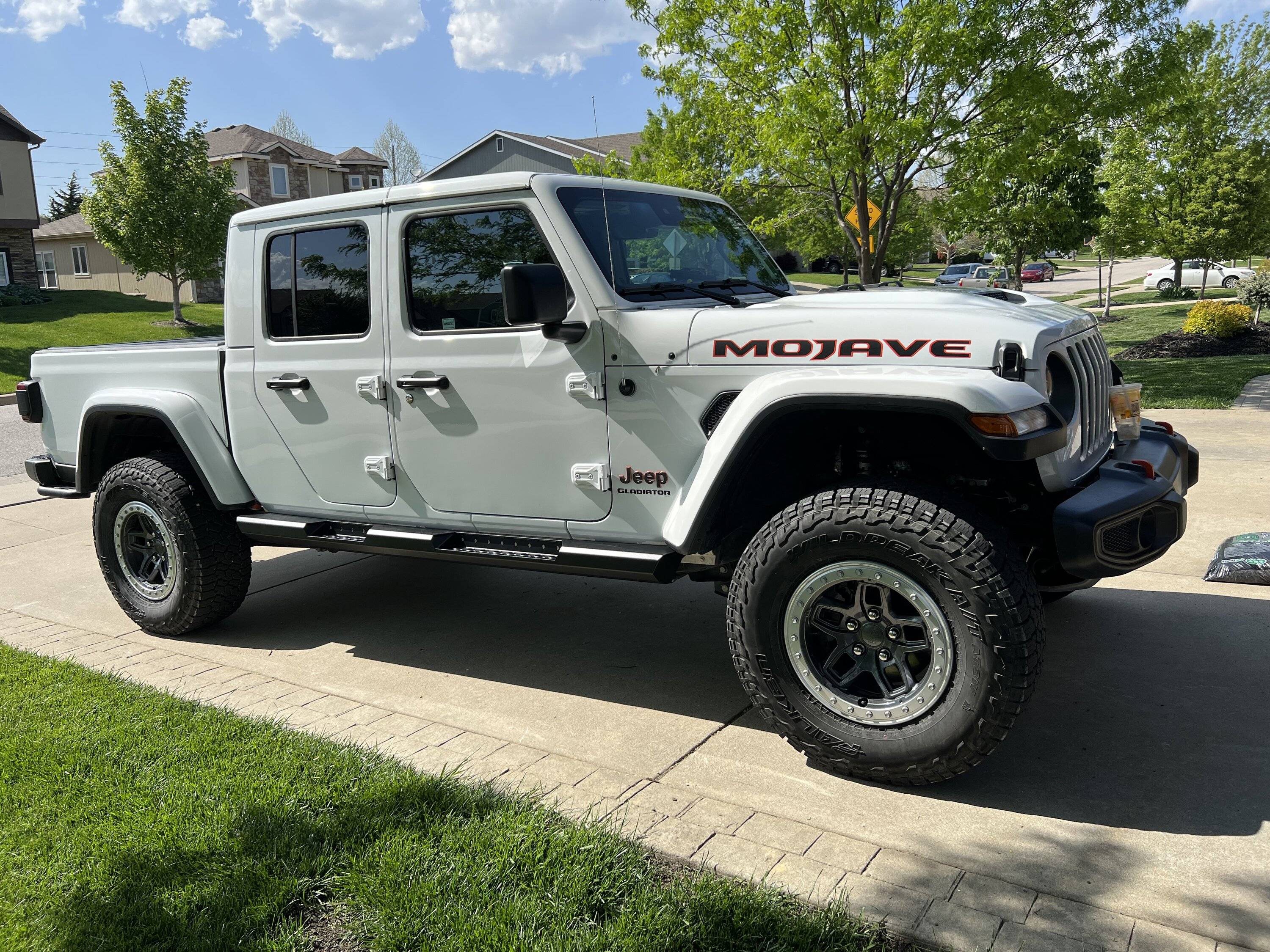

I just finished installing LOD's Destroyer Sliders on my '21 Jeep Mojave. I had been looking for something to replace the stock (bodymounted) sliders that came with the jeep. Thanks to everyone, this forum has a wealth of information! I tossed the body mounted vs frame mounted argument around in my head for a while. Although I am not a hardcore offroader, I did want something that could perhaps take a whack on occasion. I have slid sideways in the past into a tree/rock formation in my JK. And, my JK has aftermarket body mounted sliders, so...why not try something different this time.
Things I was looking for were more protection and also some sort of step. My jeep has a 2" spacer lift, so it is sometimes awkward getting in and out. Especially out - as I was worried over time my butt dragging across the seat cushion side bolster as my foot reached for the ground was going to damage it :)
Thought I would share some pros/cons and overall ease of installation. It may be just me (sure it is), but the install was a little more of a pain then some folks have reported. I certainly liked the end result, though.
Pros:
  1. Very solidly built and excellent finish
  2. Frame mounted - feel like you could perhaps use them to raise/lift the jeep in a pinch
  3. Look fantastic (IMO)
  4. Steps are very "grippy" - felt like a mud covered shoe would not easily slide off
  5. Steps allow you to easily access the top/roof area of the jeep
  6. Sliders stick out far enough to help with protruding trail objects - including car doors in parking lots!
Cons:
  1. Although frame mounted, some of the attachment points are flag nut assemblies which are fed through some frame holes. I wonder if that is as strong as perhaps a direct bolt on where you would drill and tap the frame? Or welded on sliders. Think this may be a good compromise. Probably for my use; stronger than I need.
  2. Steps are great, but since my jeep is lifted, I almost wish they hung lower (which defeats the purpose, I get it!). It is still a bit akward getting in and out, but in a different way. I get up on the step and then have to scruntch to get under the roof into my seat. Thank goodness for the grab handles on the A-pillars.
  3. As others have noted, the gap (1/4" to about 3/8". Really towards the back is where they get a little tight) between the frame and the body may not be enough if the body flexes and contacts the back of the slider during off-road maneuvers

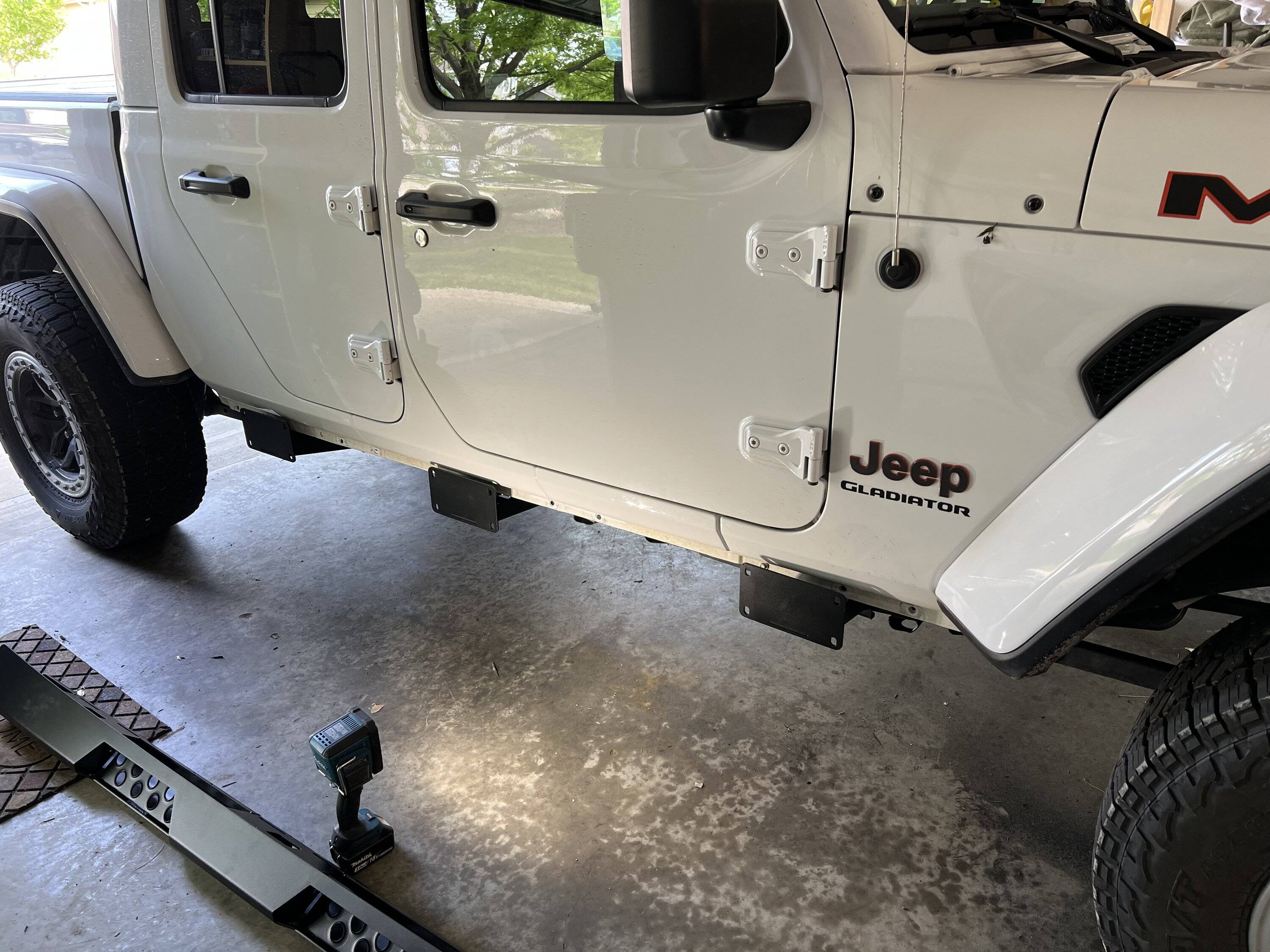

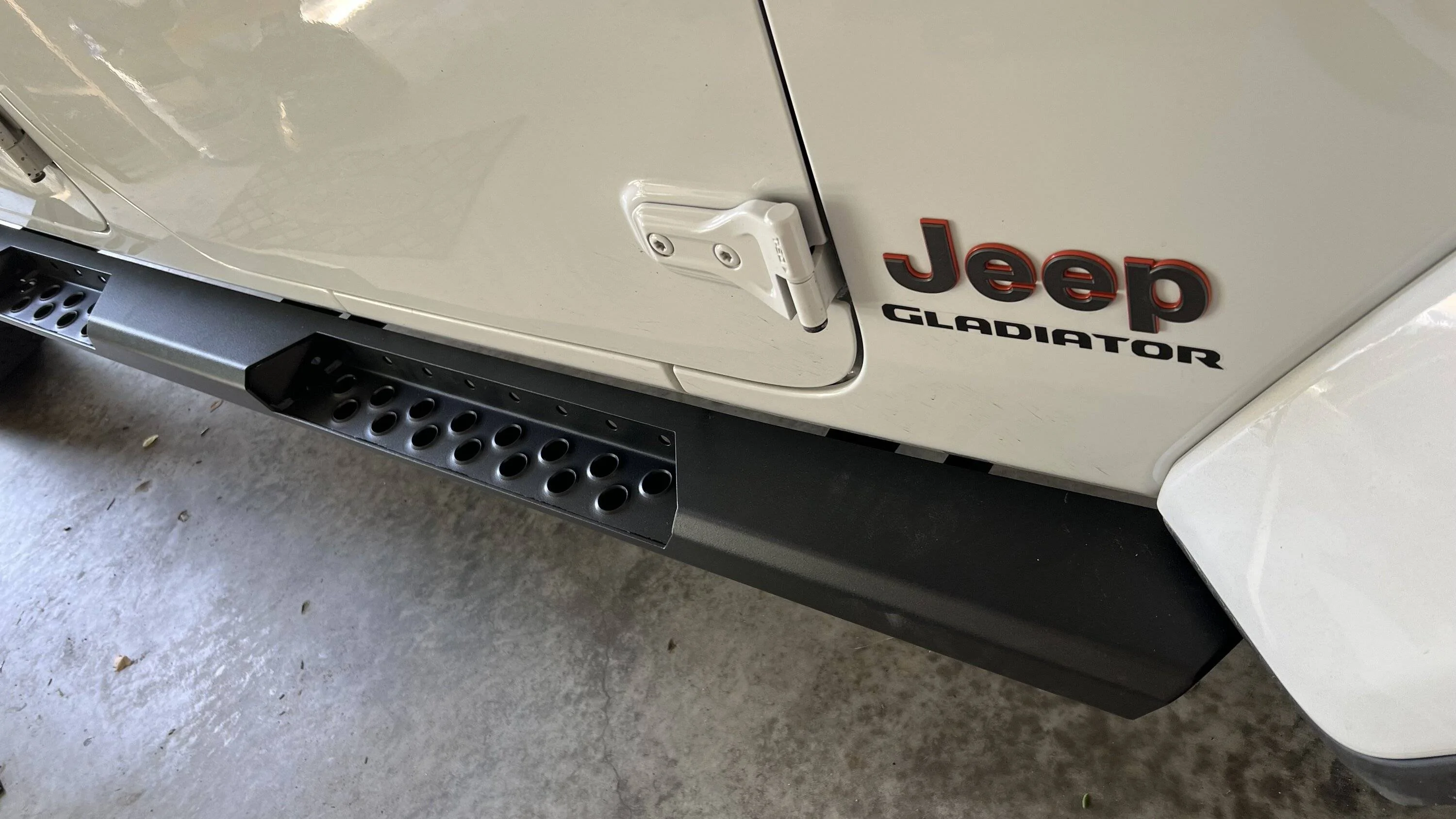

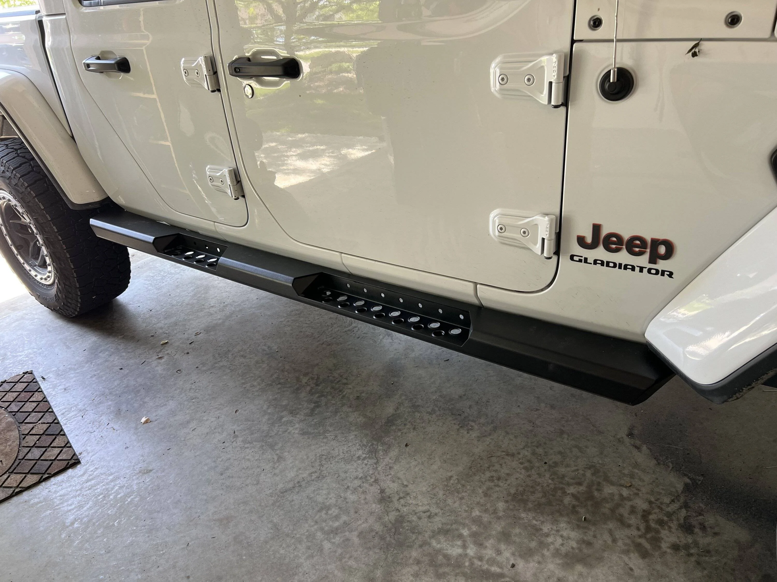

Some finished pictures:
  1. Jeep Gladiator LOD Destroyer Sliders Install/Review IMG_4140.JPG
Jeep Gladiator LOD Destroyer Sliders Install/Review IMG_4128.JPG
Jeep Gladiator LOD Destroyer Sliders Install/Review IMG_E4129.JPG
Jeep Gladiator LOD Destroyer Sliders Install/Review IMG_4133.JPG

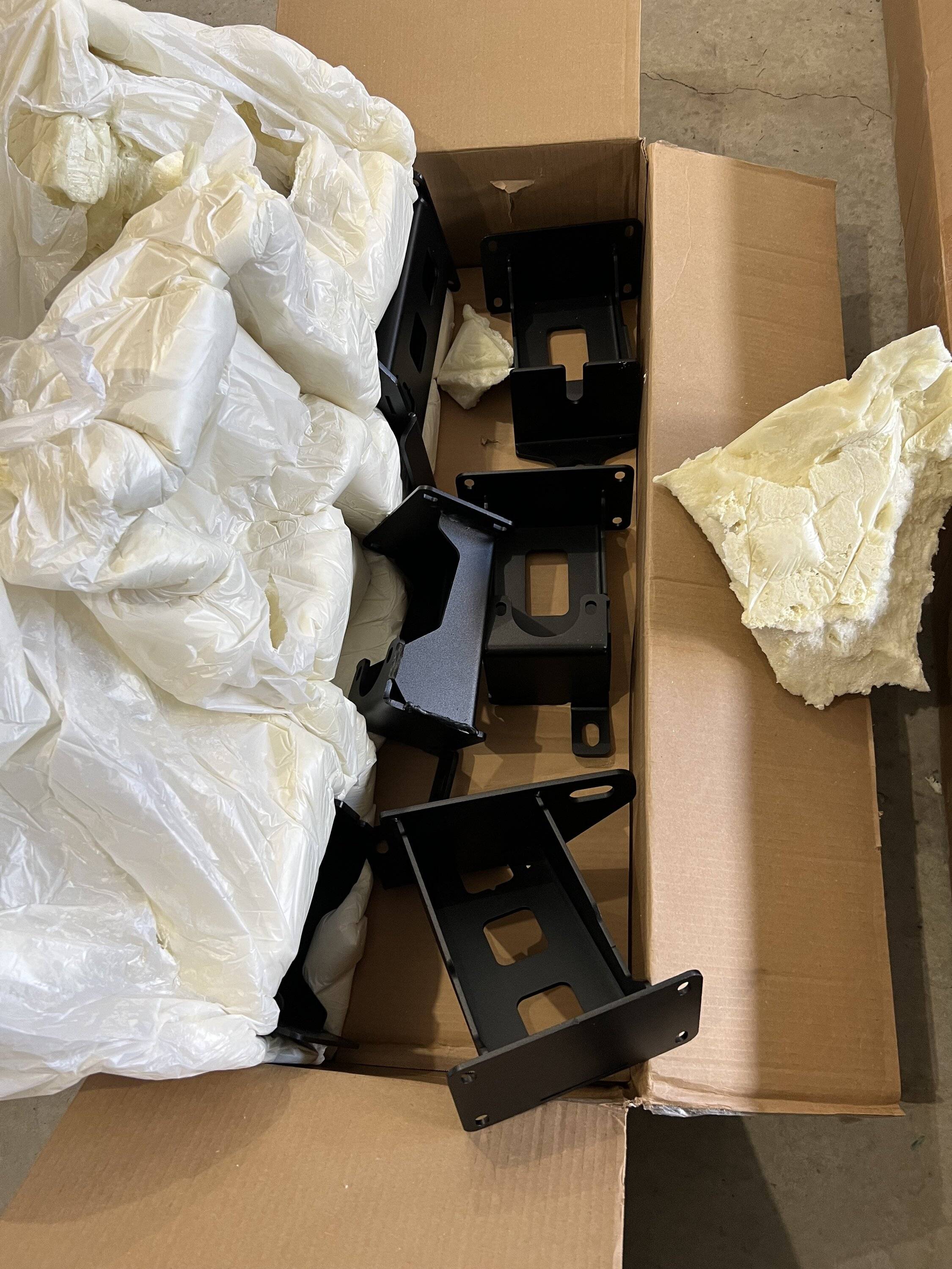

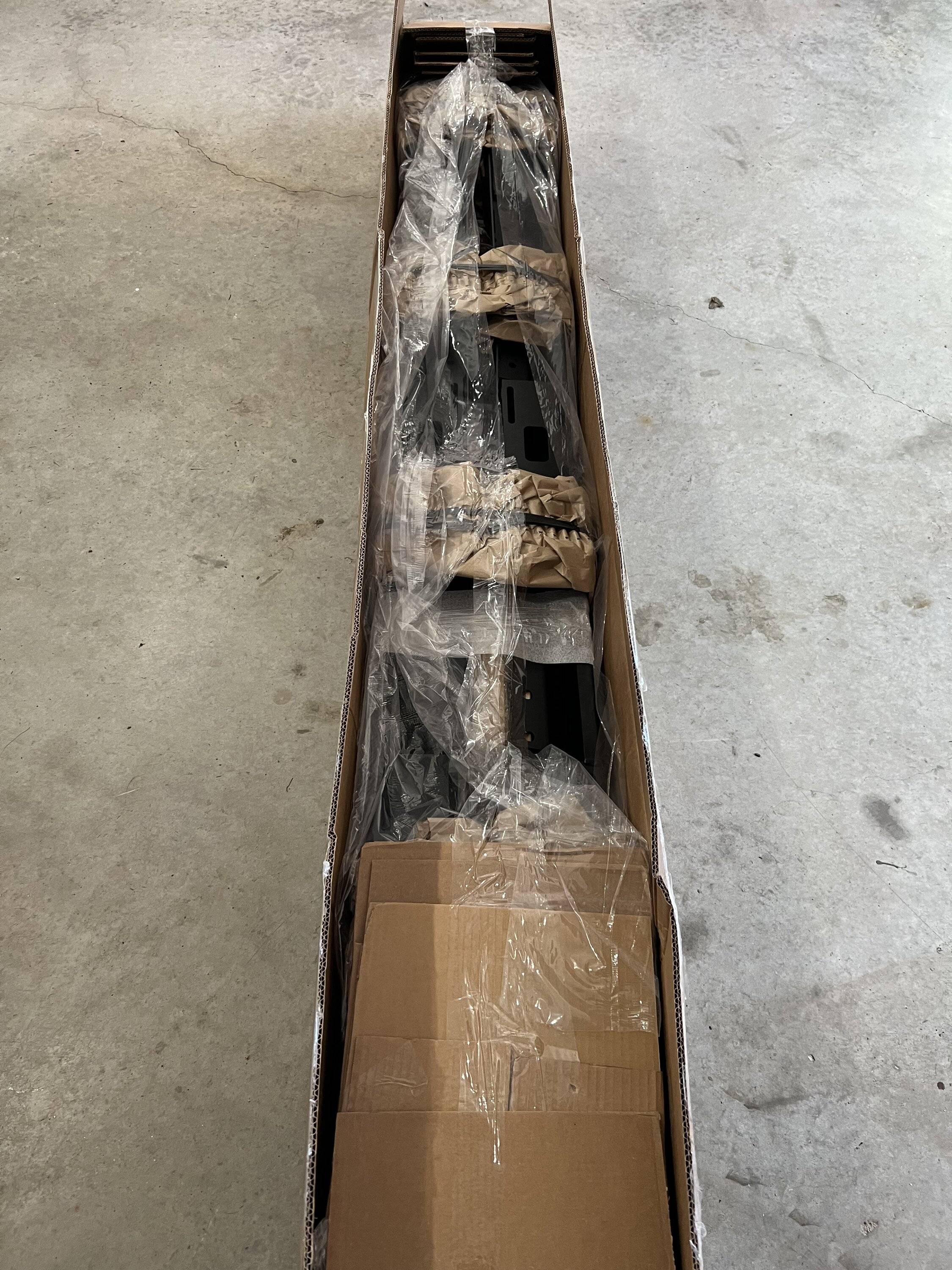

LOD did a great job with packaging. And free shipping!
Jeep Gladiator LOD Destroyer Sliders Install/Review IMG_4101.JPG
Nothing poking out of boxes like some other things I have ordered from other suppliers:
Jeep Gladiator LOD Destroyer Sliders Install/Review IMG_4100.JPG

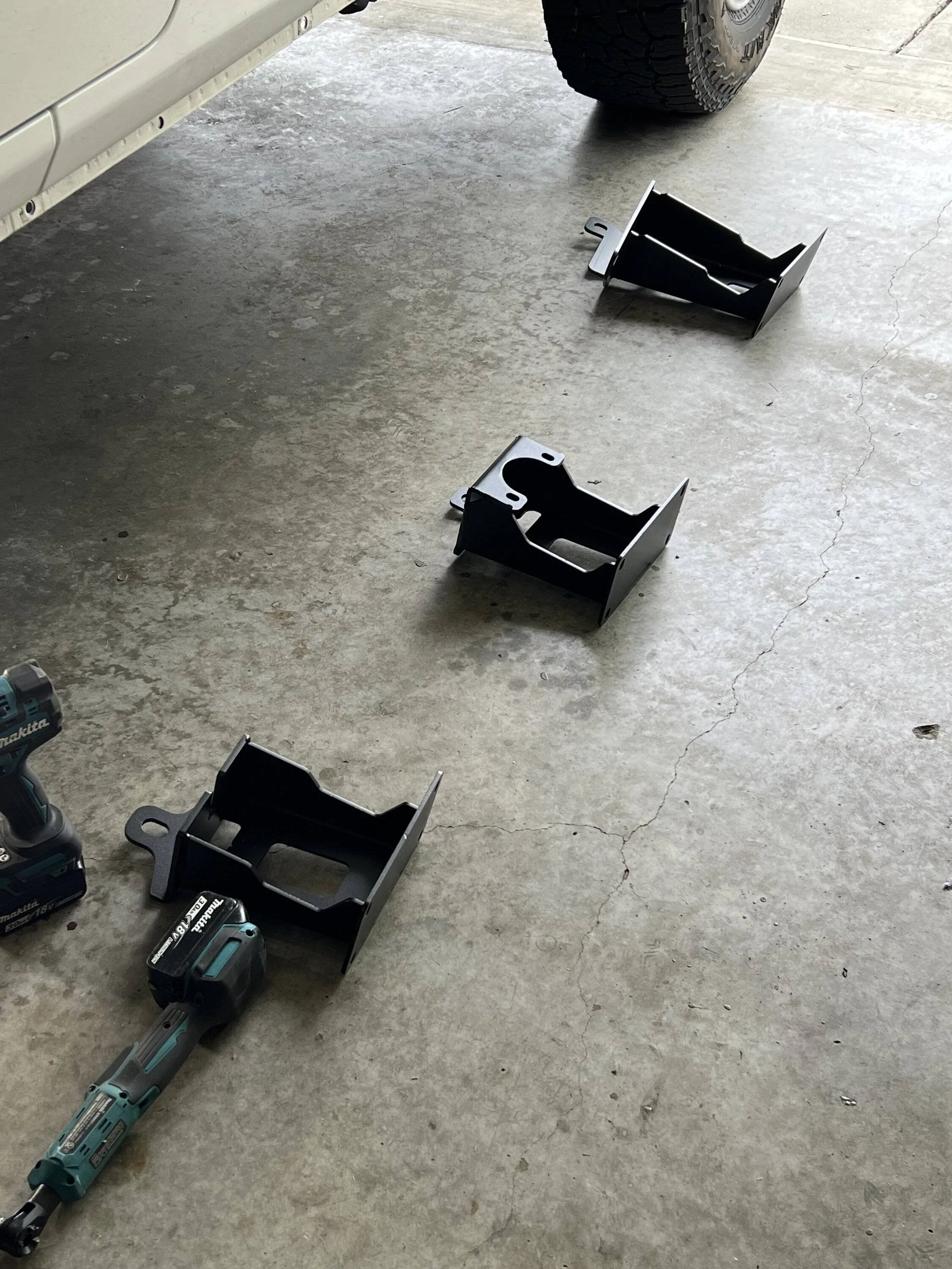

Brackets laid out. They are really beefy!
Jeep Gladiator LOD Destroyer Sliders Install/Review IMG_4105.JPG

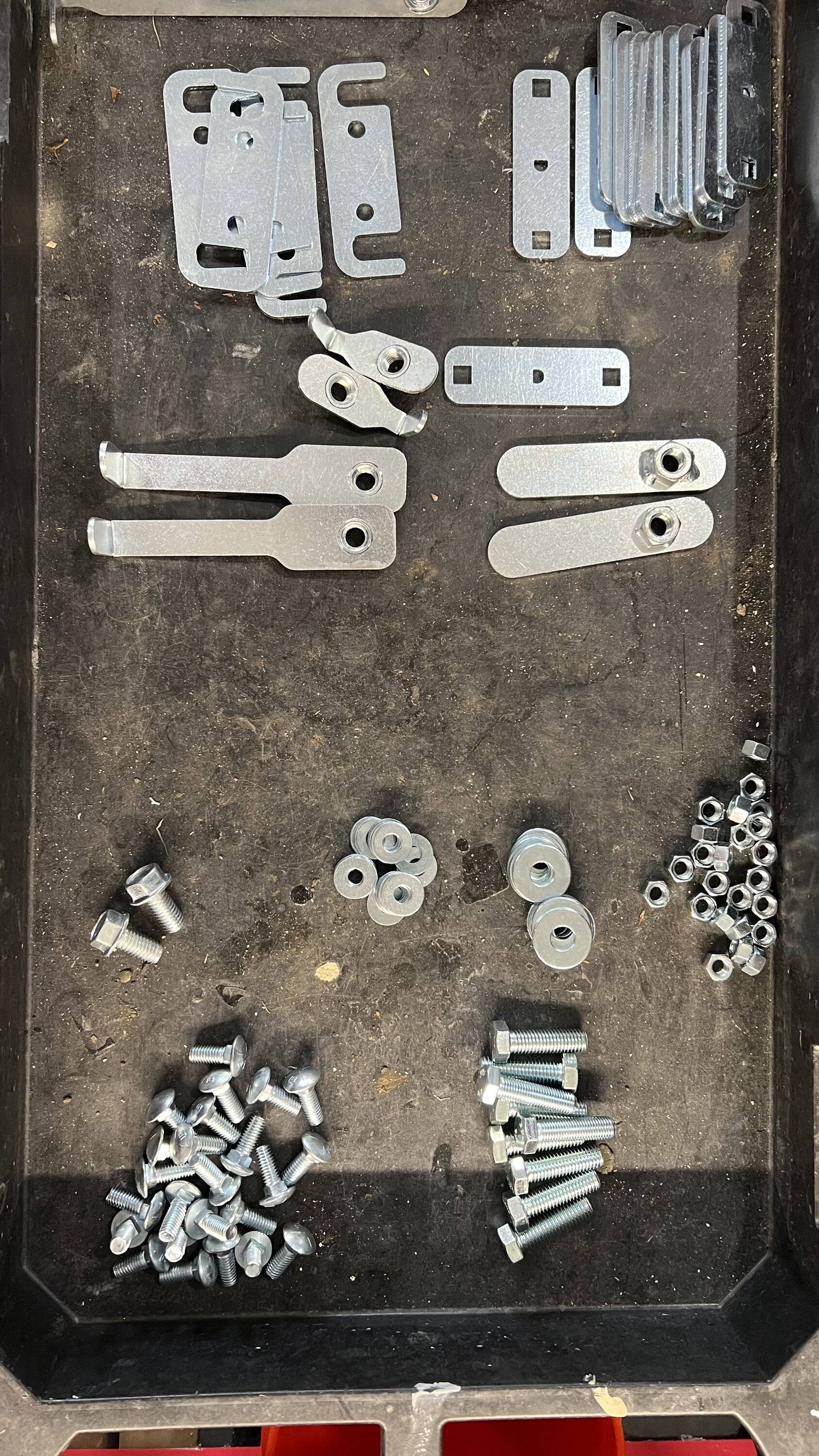

Hardware included:
Jeep Gladiator LOD Destroyer Sliders Install/Review IMG_E4109.JPG

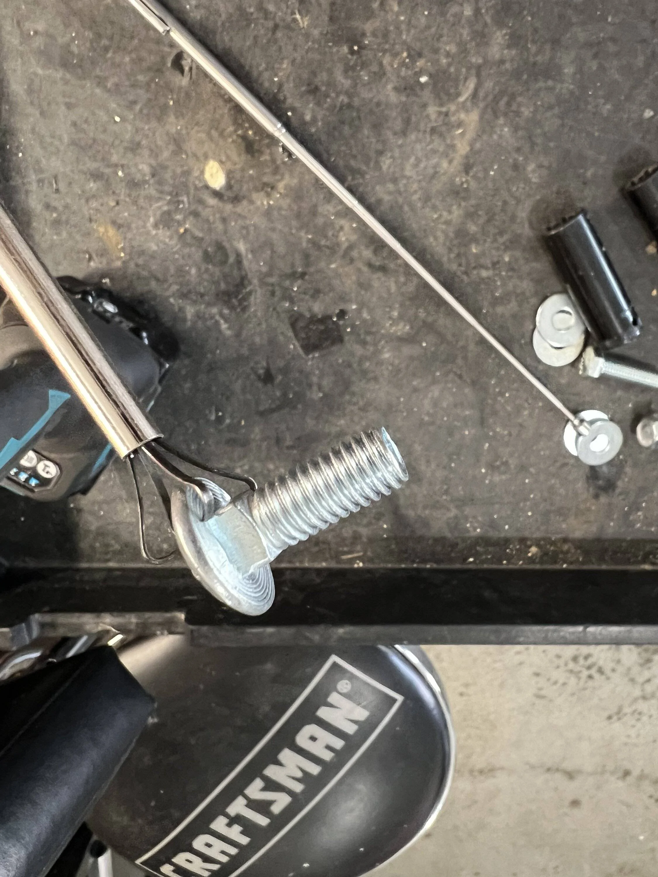

This is how I did it. Six of the bolts on each side had to be threaded through small openings on the bottom of the sliders to get to the hole to pass through. I think someone else mentioned they tack welded these onto the sliders before install. Too bad I don't have one of those!
Jeep Gladiator LOD Destroyer Sliders Install/Review IMG_4126.JPG

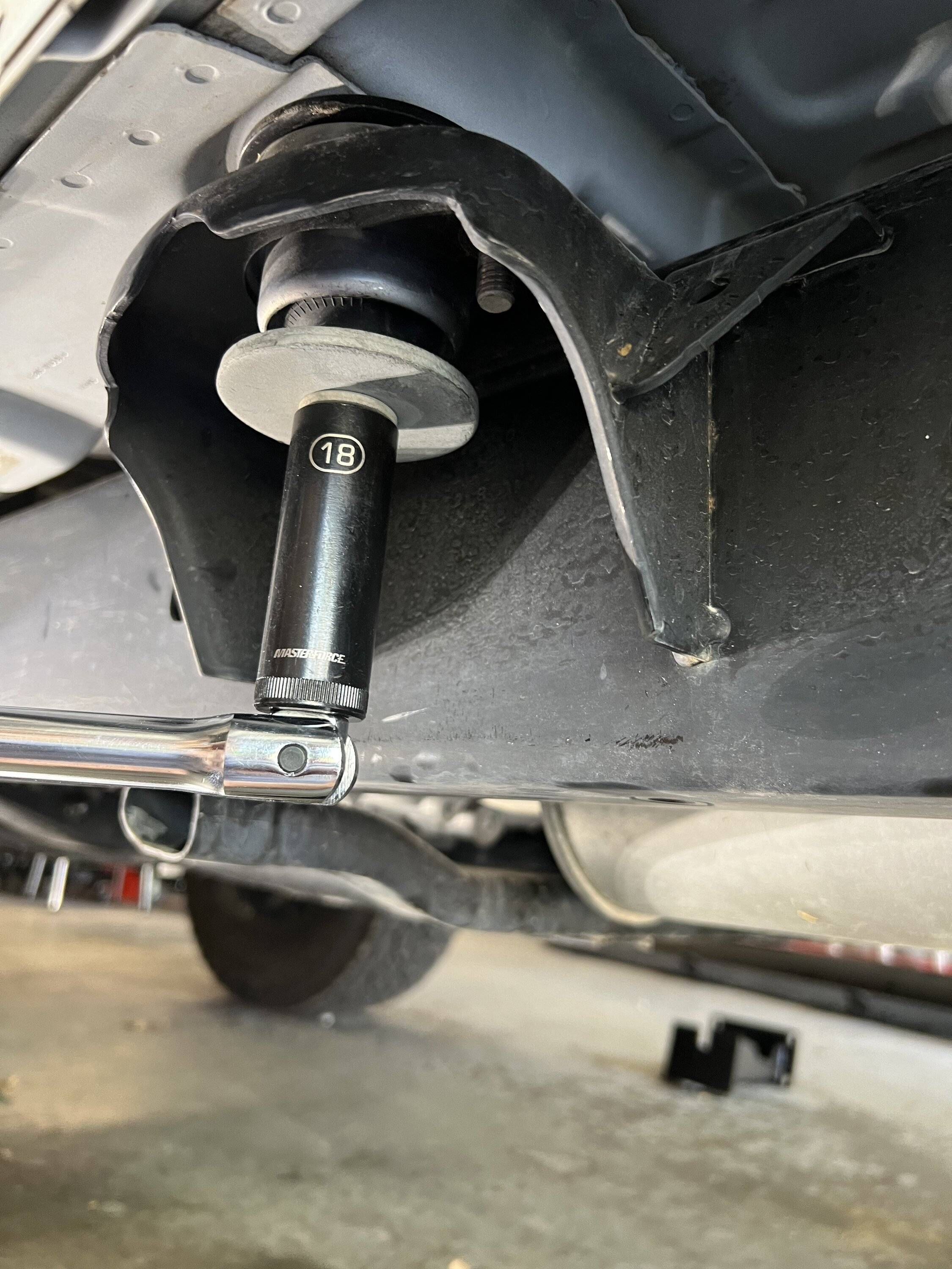

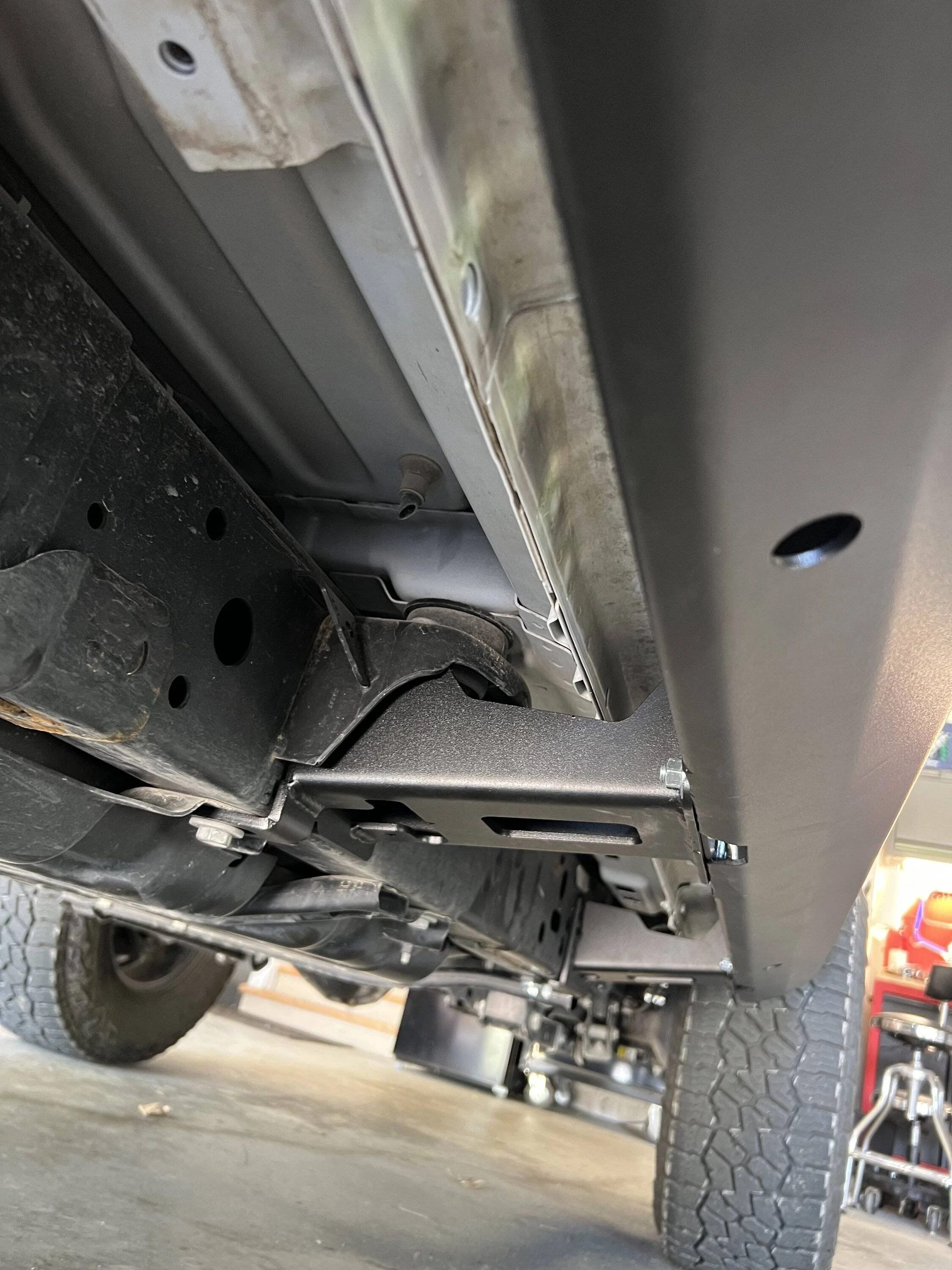

Issue #1 (for me): had to loosen (the center ones), but not remove the dreaded body mount bolts to get the bracket to slide in. Luckily just one side. The other fit fine. I was seriously worried I would snap it or something!
Jeep Gladiator LOD Destroyer Sliders Install/Review IMG_4116.JPG
Jeep Gladiator LOD Destroyer Sliders Install/Review IMG_4115.JPG

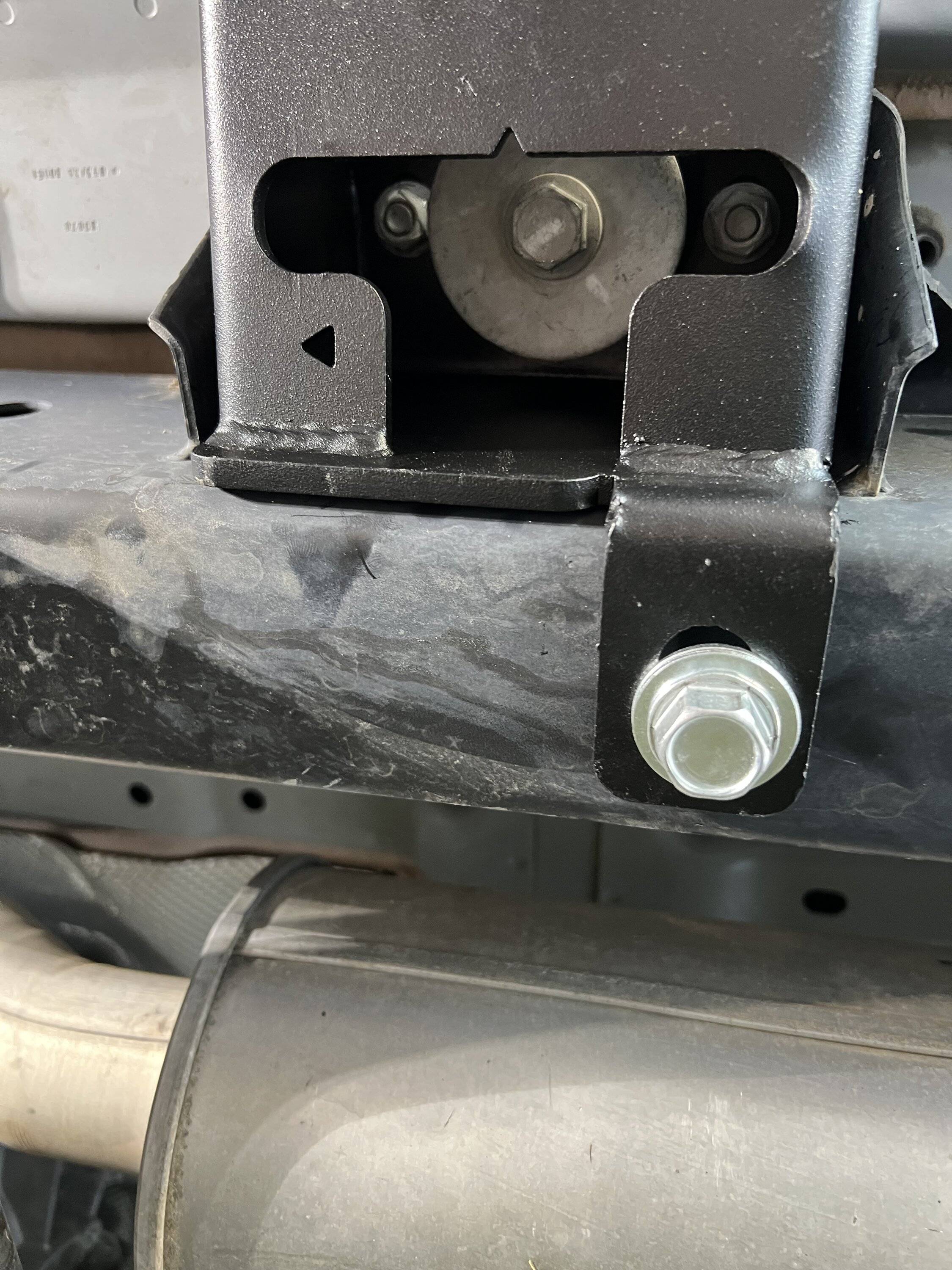

Biggest issue I ran into was confusion on my part and also instructions that were not super clear. I used the wrong bolt in this hole (center mount on passenger side) and ended up cross-threading the bolt/hole. Wouldn't tighten and wouldn't come out. Had to cut it off. My options will be to drill this out or take it someplace to put a few beads of weld around that lower bracket attachment.
Jeep Gladiator LOD Destroyer Sliders Install/Review IMG_4136.JPG
The instructions said to use the self-threading bolts - but this is what I got and used. I should have slowed down and paid more attention...
Jeep Gladiator LOD Destroyer Sliders Install/Review IMG_4112.JPG
I had a hole already there in the frame and used a bolt with the wrong thread! The #16 bolt in the instructions ended up being one of two supplied but mixed in (and I did not notice the difference) with the other thicker threaded bolts. So, again, my bad for not really thinking this through. One of those bolts would have screwed in perfectly, I suspect!
Jeep Gladiator LOD Destroyer Sliders Install/Review IMG_4111.JPG

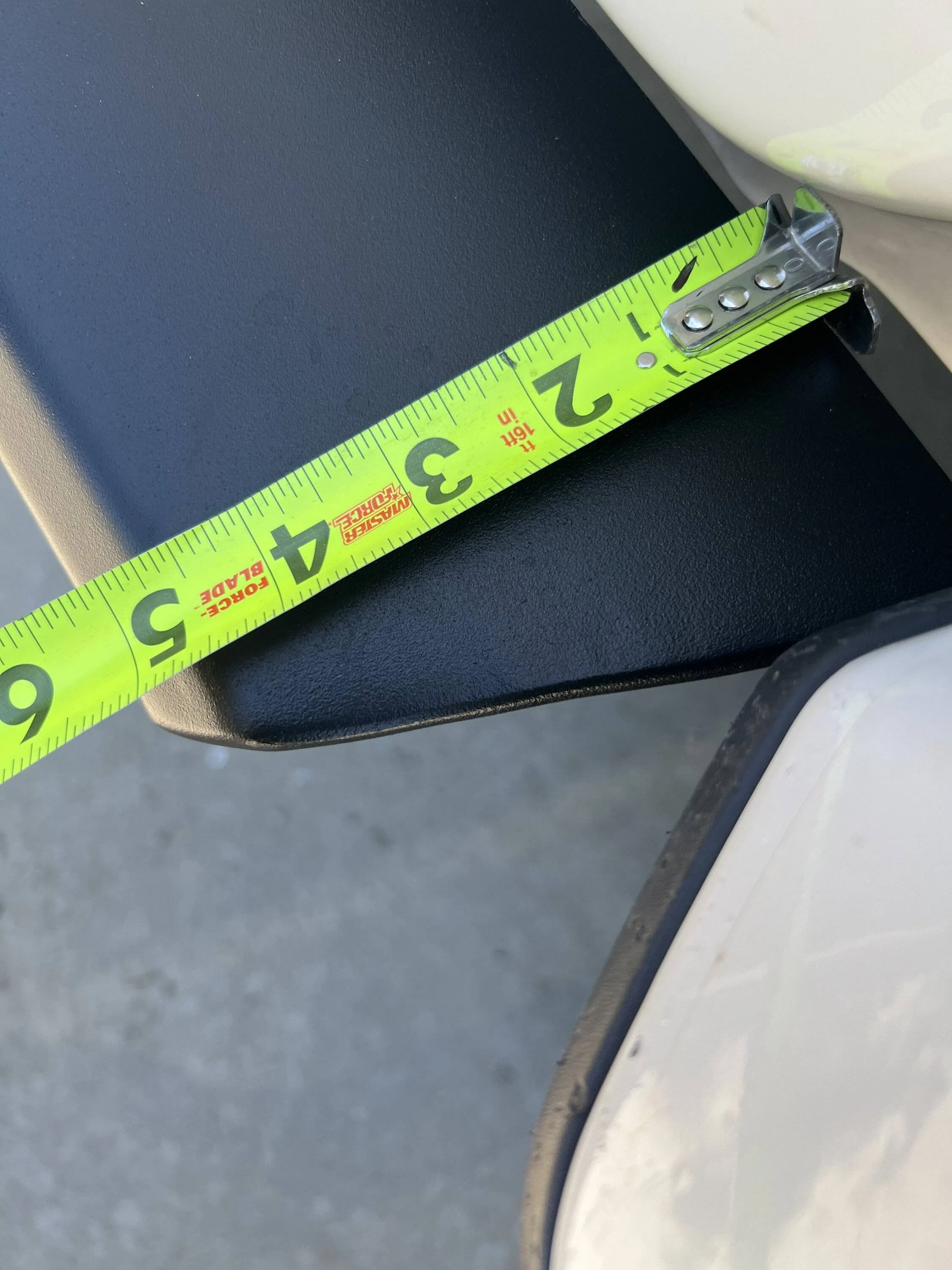

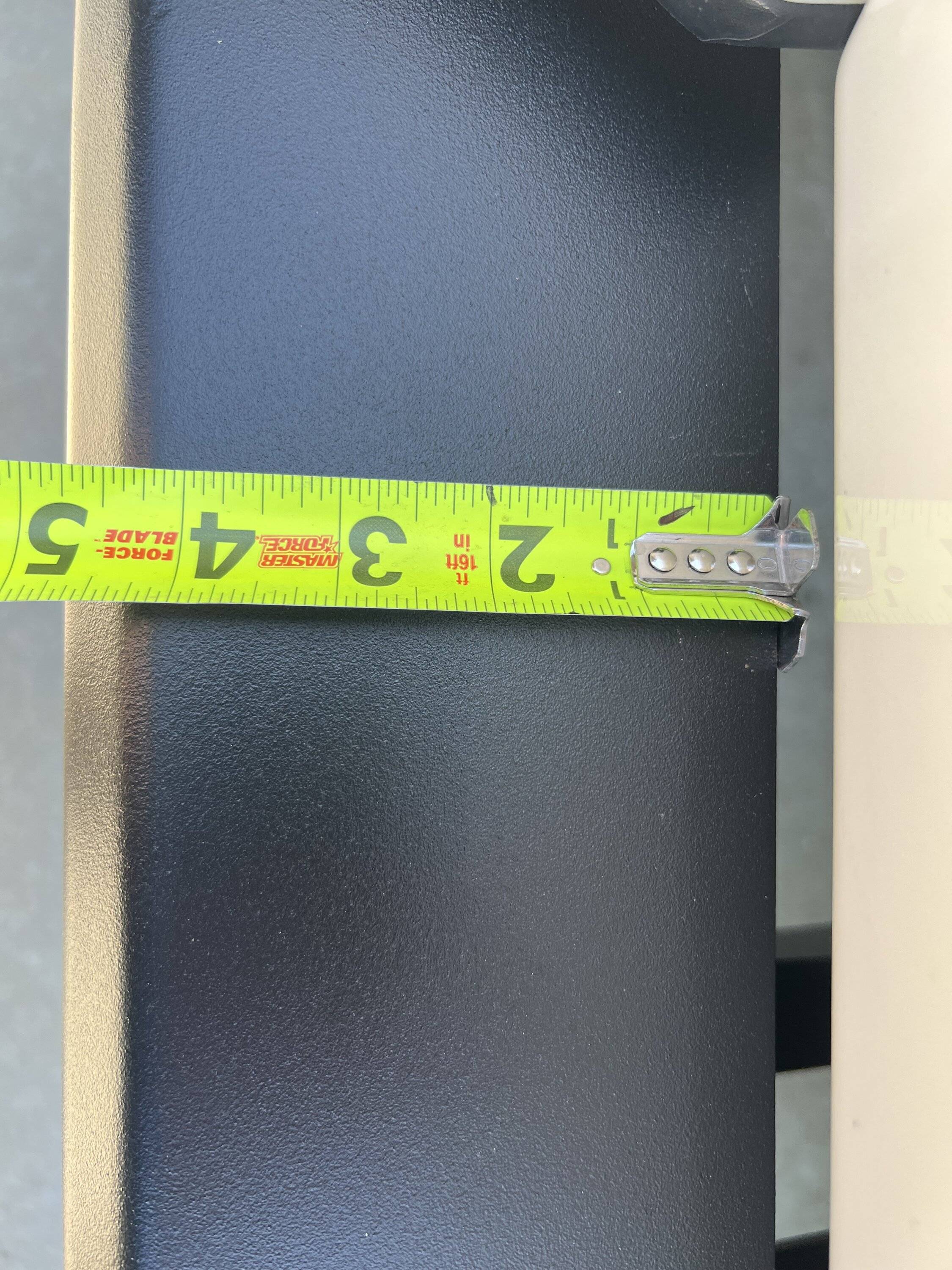

@Not2Late, are these steps/sliders contoured and follow the body line? The pictures appear that way, but wanted to confirm. Most aftermarket ones appear to be straight, leaving wide gaps near the rear portion. Would you mind measuring the width at the upper flat part (near front fender)? I'm trying to see if it is wide enough to step on to reach across the windshield. Thanks. Looks great, by the way!

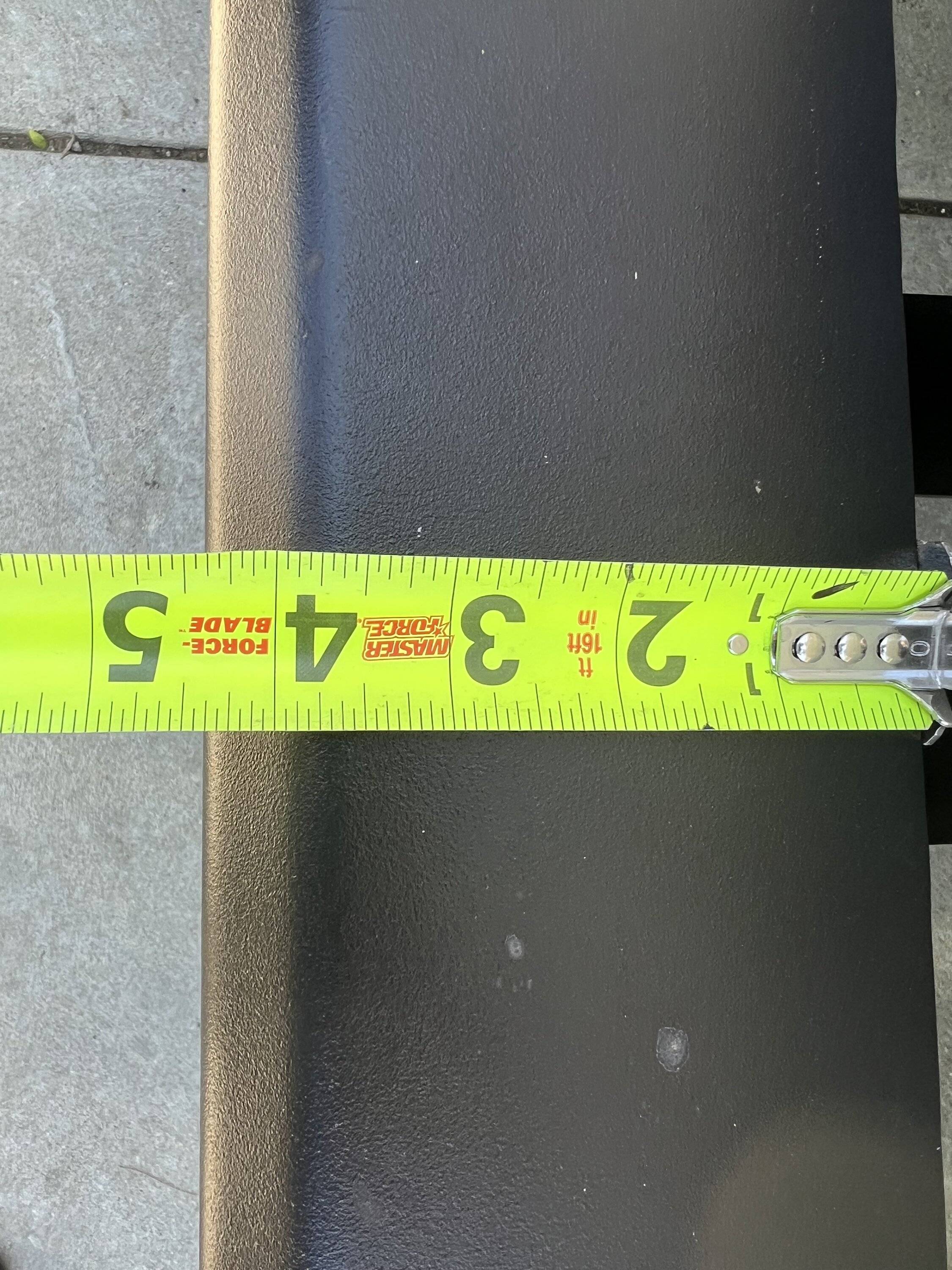

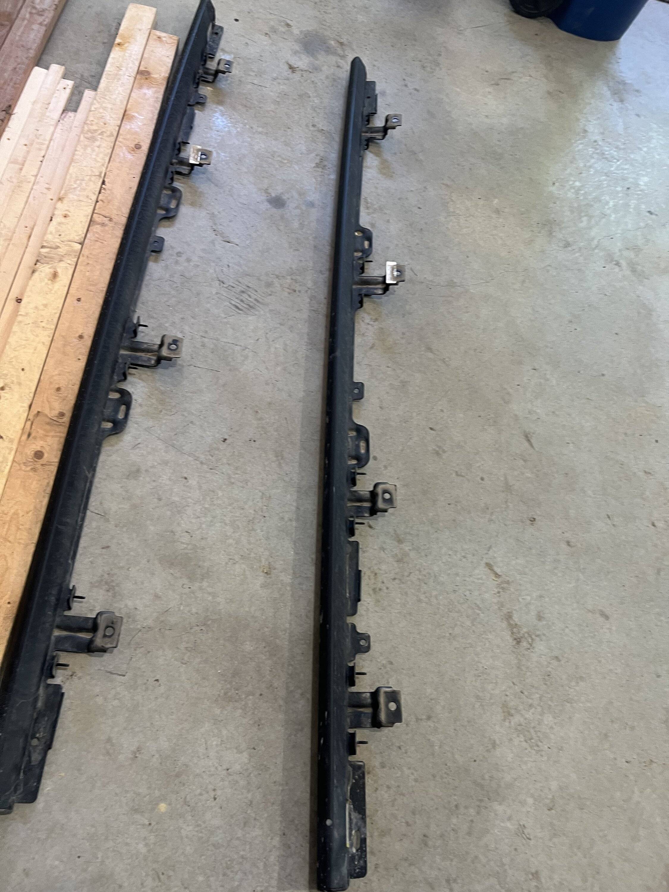

Thanks, they do look great!
Here are what came off. You can definately see the "curve" to them. Yeah, I don't think most people know that there is a contour to the body:
Jeep Gladiator LOD Destroyer Sliders Install/Review IMG_4159
The LOD Destroyers do have the contour as well. Here are the measurements at front, middle, and rear. So nice design that some other sliders don't have. And there is plenty of room to step on them and I was able to reach way past the top/middle of the windshield and onto the mid roof area.
Jeep Gladiator LOD Destroyer Sliders Install/Review IMG_4155
Jeep Gladiator LOD Destroyer Sliders Install/Review IMG_4156
Jeep Gladiator LOD Destroyer Sliders Install/Review IMG_4157
Thank you for the quick reply! I also got a confirmation from LOD's Sales (they were also quick to reply). Your pictures really show the curvature well. I may go with these. I currently have the Mopar Performance Sliders, which have a bit of a ledge that can be used as steps, but they do not come out far enough. I think my family will be much happier with these. Thanks again!
