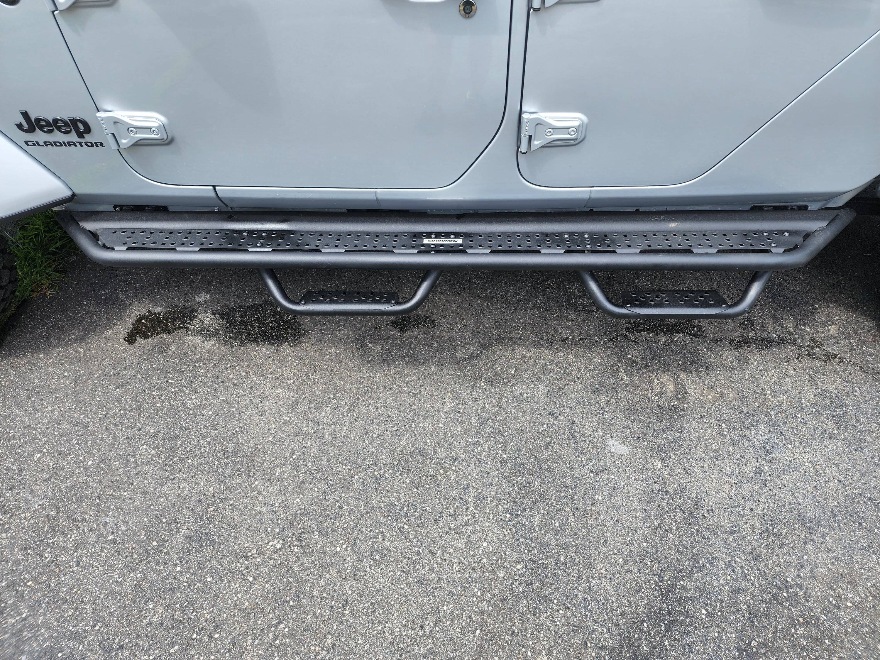

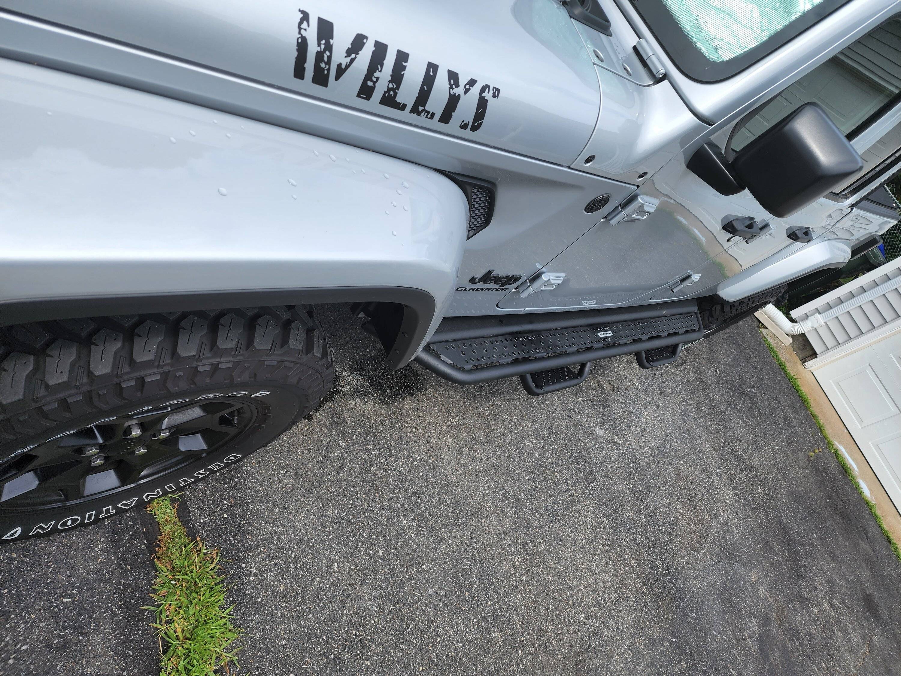

I bought the GORHINO Dominator D6 steps and added the drop steps to them. They are solid enough but not meant for offroading. The drop steps help my wife and kids but is still awkward for me (6ft tall) so I just lunge into the jeep.
Jeep Gladiator LOD Destroyer Slider Steps 20220811_140410
Jeep Gladiator LOD Destroyer Slider Steps 20220811_140416

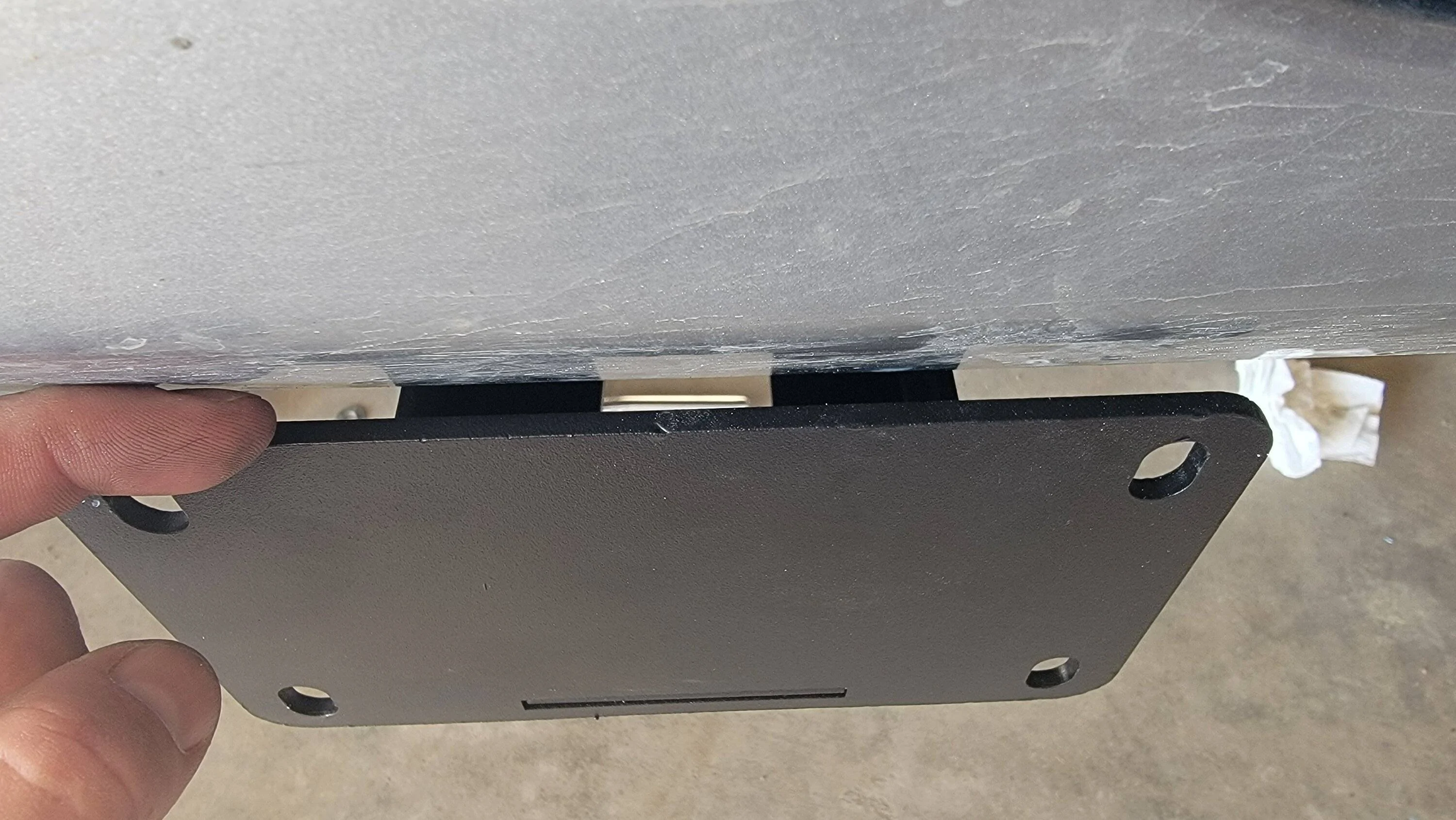

Got mine delivered the other day. Install is slow at best LOL. I ended up tack welding the carriage bolts the backing plates to hold them together. My issue is clearance. Once I had the passenger side bolted in, they were making contact with the body at the rear and had maybe 1/4-3/8 of clearance between the slider and the length of the body. I had to shim the center mount down about 1/8" to keep it from hitting the body (both the frame bolt and 2 smaller body mount bolts). Here's a pic of the center mount once I got it shimmed and bolted in place. I'll have to get longer carriage bolts if I use their shims to get the rear away from the body.
