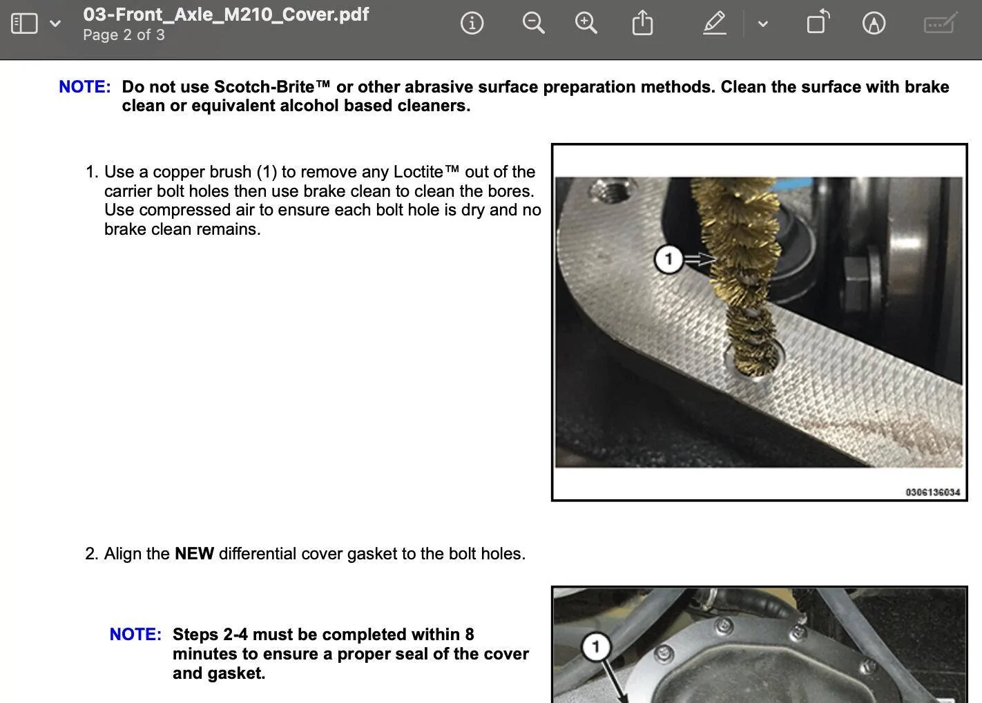

Clean the bolt holes.
Jeep Gladiator Looking for help with differential dyi service Screenshot 2025-03-18 at 4.15.10 PM
