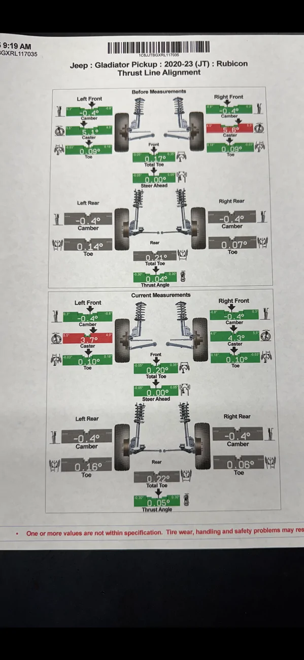

well aware of the track bar centering side to side. I’m talking front to back which would be the lower control arms. I’ll post my current alignment adjustment that got me at an operating angle in the 7’s. Totally agree with you that rotating the C’s is not a cost efficient method nor very practical. The FAD actuator seems like the route to go and then I can roll with a caster of 6. If the vibration was gone I would just continue running the caster around 4 but that’s not the case. I gotten use to the lack of “return to zero”. Sorry for the late response. Also I fully appreciate all the help.
Jeep Gladiator Cutting and welding differential for caster IMG_8541

My brain clearly wasn’t working when I posted the reply. Obviously you meant centering in the wheel wells.
