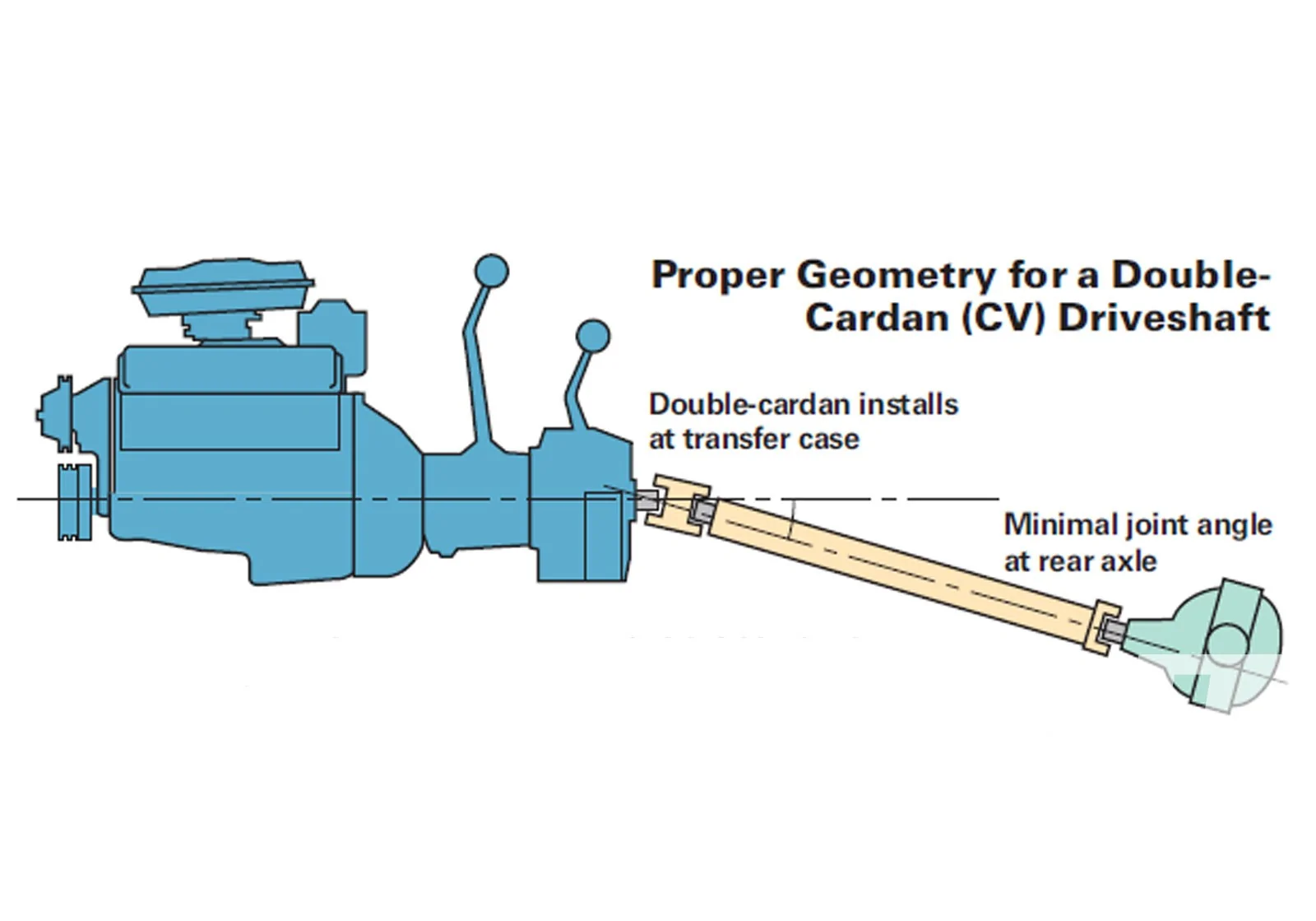

slight vibration…. But I want things perfect. Not removing the lift as that would take my daily driver out for 2 days as well as I sold the stock rubicon arms/ parts. I get the FAD is a weak point but it already has the fad axles and everything else that comes along with it minus the actuator. So there is no difference. Love the way it wheels with the 3.5 lift and 38’s and 5.13’s. Totally worth it. Just dialing it in. Yes the plan down the road is gonna be a 392 and Dana 60’s. With hydraulic steering but that’s all 5 yrs down the road. Solid advice though
I know exactly the vibration you're referring to. Mine got better after I adjusted my front control arm length, but the best way to describe it is as a pulsating low hum that sort of feels like these old toys that we all had as kids.

Even if that's your primary use, either don't lift it 3.5" and put long travel shocks on so you can keep the rzeppa joint or just accept that you'll have a bit of driveline vibes in the winter? For the vast majority it's just not a common enough occurrence for it to matter. Sure you could go high pinion 60 just so you can cruise freeway speeds with a big lift in 4wd if it bothers you.
CrazyCooter
Tony
Nov 1, 2020
2,321
2,586
Far NorCal
Specialty Off Road Shop Owner
We still don't even know IF the aftermarket shaft is even required. I asked for the shock length and he gave me the make/model?
A quick search nets an AI result of:
Falcon 3.5" Lift Shock Extended Lengths:
Front 28.4"
Rear 32.3"
No aftermarket shaft is required for 28.4"?
Supazuk
Jay
Apr 28, 2024
889
1,437
NH
2023 JT, 94 Zuk buggy, 87 Samurai, 96 Suburban, 80 Capri, 15 R60 ALL4S, 13 DR650
USCG (Retired)
Your description of the double cardan proper geometry is wrong. The pinion should be pointed up at the transfer case output. This is where the cut and turn comes into play and the source of the OPs vibration. The more you lift the more the pinion needs rolled upwards. The problem there is rolling the pinion up reduces caster. With 3"+ of lift the caster will likely end up at 1 or 2⁰ and the thing would be undrivable. If there was an aftermarket high angle rzeppa shaft then you could set the pinion at 0⁰ and have shot 6⁰ of caster. Even with a lunchbox locker if you still have the FAD your front shaft shouldn't spin as there's no load so your side gears should be disengaged. If you still have the stock front shaft the rzeppa is allowing you to run enough caster even if the shaft is spinning.
that is exactly what I meant, it did not convey my intent The drive shaft at the pinion should point to the T-case resulting in zero reference angle to the driveshaft not set at zero from the ground
In reference to lunch box locker the shaft will spin the drive shaft even with the fad disconnected as there is no load on the drive shaft from the t-case so the side gear stays engadged on the live axle shaft

that is exactly what i said the drive shaft at the pinion should have zero angle
The wording of the pinion at 0⁰ made it sound like it should be parallel to the ground. That's why I posted the picture for clarification. Pointed at the tcase/0 angle with the driveshaft. Semantics but same/same.
Supazuk
Jay
Apr 28, 2024
889
1,437
NH
USCG (Retired)
that's why i am going to edit the original post the link information was correct
