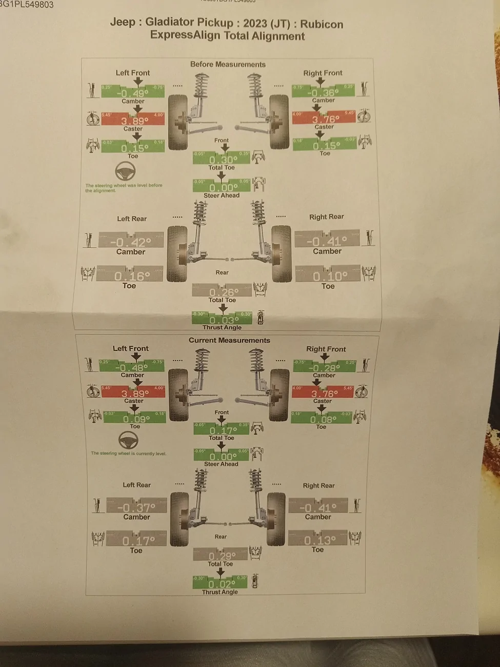

I have a 3.5 lift. My shock length is 27.99" extended and so far no issues with the front drive shaft.
Caster is 3.89 on left and 3.76 on right. I have no clue on how it drives, but I am considering adding either adjustable control arms or geo correction brackets.
Caster of 1 or 2 degrees seems off.
Your caster is still crap and below the low spec Jeep puts out. Rolling your caster up to 6⁰ will point your pinion down another 2.25⁰ from where it's at. It will still be OK if you have the stock front shaft with rzeppa joint. The issue is the aftermarket double cardan shaft needs the pinion pointed at the tcase output, which would mean rolling your caster down to 1-2⁰. Nobody makes a long travel, high angle aftermarket rzeppa shaft so that's where the issue lies. With 3.5" of lift I'd rather see a 30" extended length shock, which would be too much for the stock shaft. It's a combination of factors that doesn't have an easy solution if you don't run a FAD. With the FAD you can set caster at 6⁰ and it won't matter if your double cardan shaft would vibrate a 60mph because most are never doing that in 4wd.

Safety Consultant
