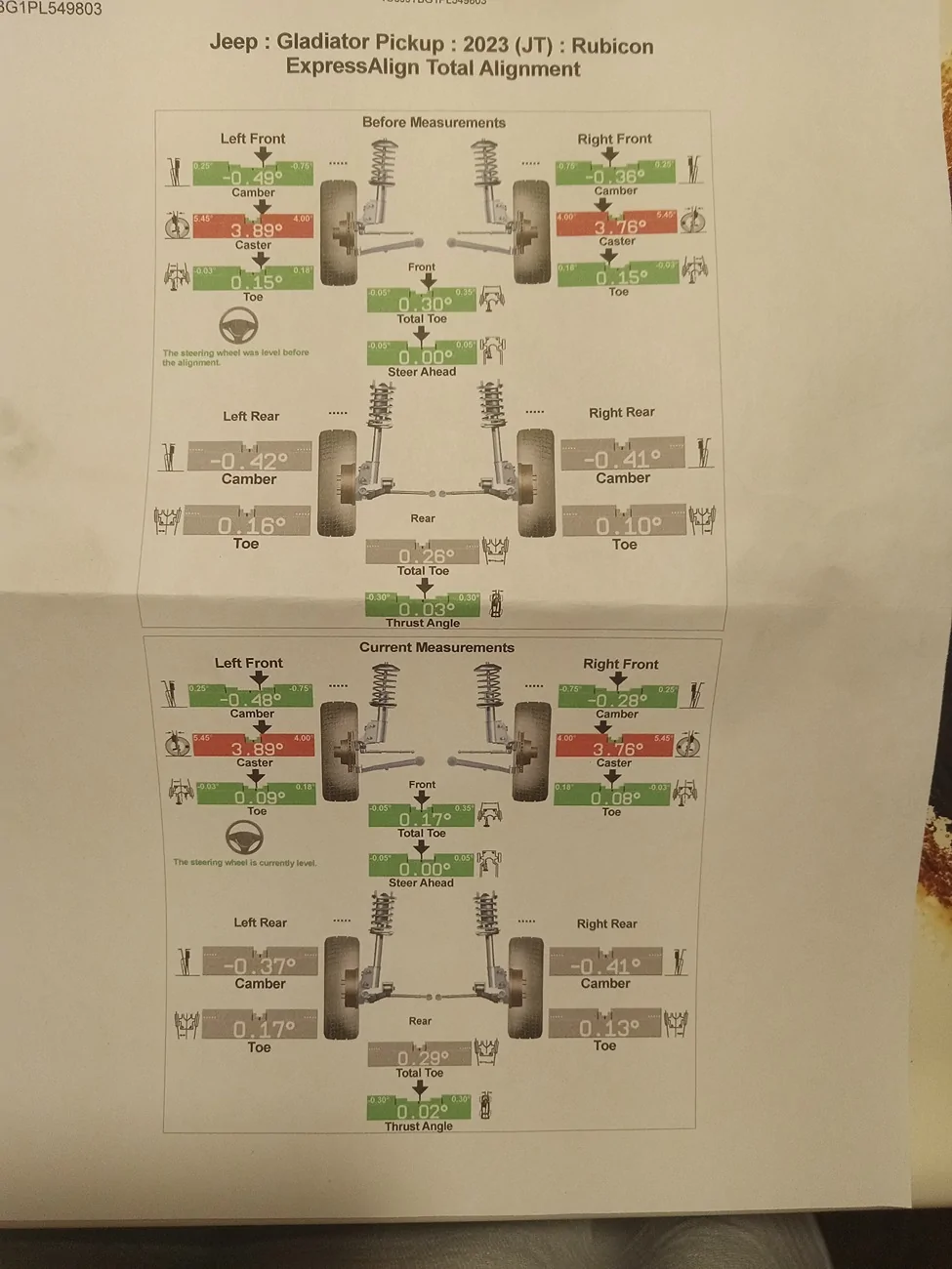

I know very little about alignment, but when I had my Rubicon alignment done after both a 3.5 lift and 37's on wheels w/-12 offset mine was lower than even factory caster.
Since I had 37's on previous Rubicon with 2" and the caster was high, I am guessing that the more lift, the more caster you loose?
I am probably going to try either longer control arms or geo correction brackets. I do not have even a hint of the issues the op has, but I feel that either will be an improvement.

Adjustable control arms would do the trick. Then you can dial it in to the exact caster you want to run. As well as keeping your axle centered.

Yes, assuming the lift is without different control arms.
Basics - Looking at the side view of the front wheel assembly, caster is the angle if you were draw an imaginary line between the center of the lower and upper ball joints, compared to vertical (90*). The top ball joint will always be behind the lower ball joint, as that helps the wheels turn back to center.
When you lift a truck, the chassis mount of the control arms goes up, and since it's a fixed distance between mounting points, that will pull the bottom of the axle rearward, reducing the distance (angle) between the upper and lower ball joints.
Vibrations occur when the caster gets too low, the tires have less force telling them which direction they should point.
And of course, vibrations can come from multiple issues, not just caster. It's a test-result process to find out what's what.
