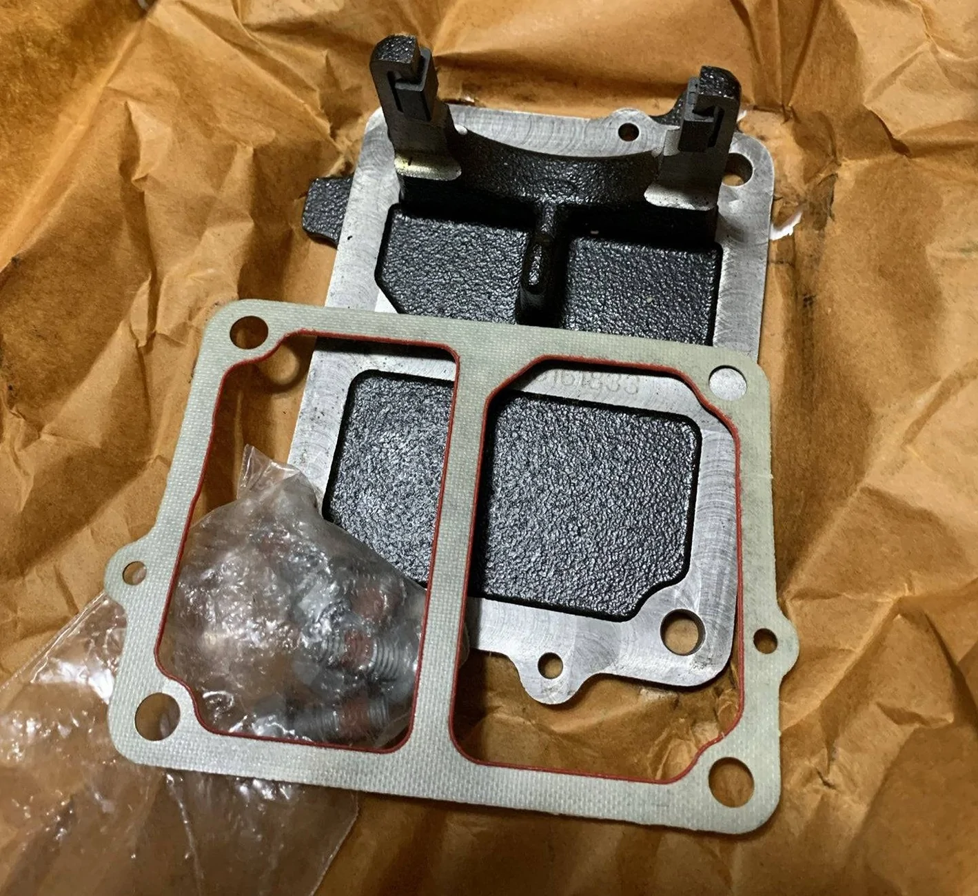

The JTs all come with a fad. The only difference is the shift fork is welded to the block off plate effectively locking out the disconnecting means. They literally removed none of the potential failure points aside from the shift motor. Even if you were worried about a shift motor failure you could carry the block off plate with welded shift fork in your tool bag. If the fad motor failed, 4 bolts and about 5 minutes you're back in business.
It sounds like I just need to get the motor and coupler (Ryanlsmith might be helping me out with those parts) Then wire it to an aux switch.
Should be all you need. I'm not even sure the coupler is different with the factory block off. I know some aftermarket deletes use a line coupler that can't shift on and off and therefore their block off plates don't have the fork. To me it looks like all the factory did was take the same housing, shafts, and internal parts and replaced the moveable fork/motor assembly with a fixed fork cover?
That makes sense since RyanlSmith had a Fad delete installed. I should have the right coupler already. Thanks for clearing that up!

There are tens of thousands of lifted JLs/JTs on the road and trails and 95% of those still have the FAD. The 2024 and up models still have the FAD it is just locked into position. The only fail point I've seen is the cast FAD housing which they all still have and even that is a very rare occurrence. The 2 piece shaft is probably weaker than a single piece, but again they all still have it and I haven't seen a single failure. Now we all need 60s with hubs just to wheel? Remove the lift and run stock tires? Or just make the FAD you already have functional for a couple hundred dollars and go wheeling? When you say drop the FAD and solidify it are you just talking the axle shaft? The failures seem to be the housing so unless you are swapping the front axle for an aftermarket you aren't gaining much.
