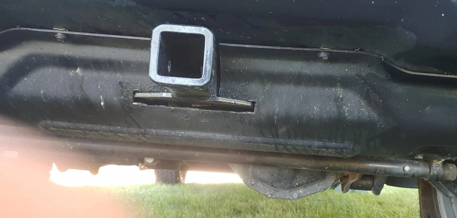

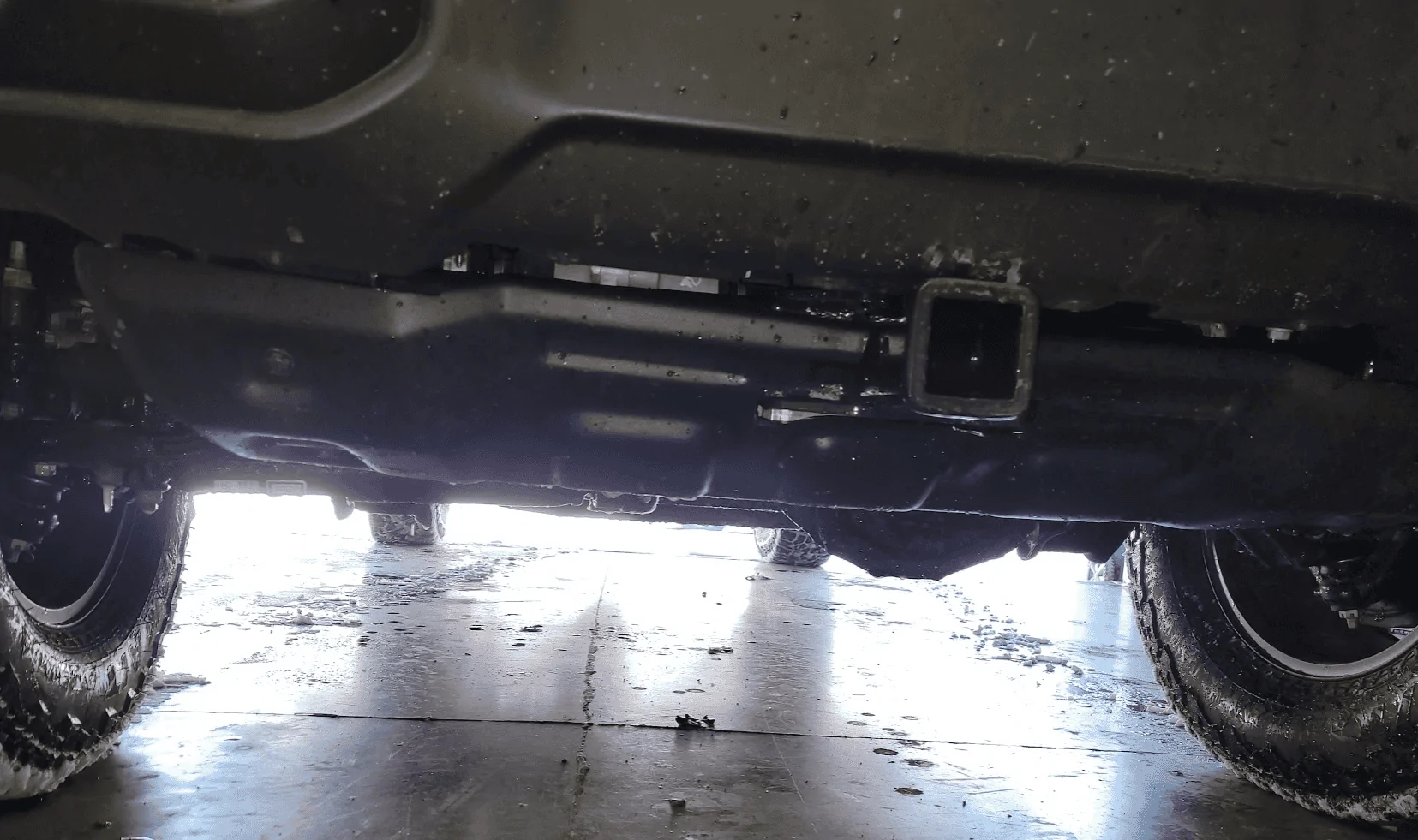

Did you have to do any modifications outside of cutting an opening in the skid plate to install the hitch receiver? I was told that the bolts for the Curt hitch receiver mount to the same pre threaded hole as the skid plate. Im trying to decide if I can installed myself or should bring it somewhere. If the solution involves welding or cutting outside of the skid plate I’ll probably bring somewhere. Thanks!
I think I answered my question by looking at the pictures a second time. It looks like you made the diagonal cut on the mounting bracket, is that right? Will the loss of the bolt impact the weight ratings on the hitch reciever? I wanted to be able to use for a small snow plow in the winter.

You have to cut the opening in the skid plate and (at least for the Rubicon) cut the bottom bracket that holds the skid plate... (see the bracket images above) but really you don't have to cut anything, if you don't mind running with out the skid plate ;) I considered that but went ahead and cut the stuff up as I had time... ran about a week with no skid plate, but finally got it all back together!

The receiver bolts up using all holes. It's only the skid plate rear or lower brackets that have clearance issues. I was able to get one of mine wedged in, the other I cut. You'd have to smack that skid plate pretty hard for it to matter because the bracket would be shoved up against the frame before any bolt would snap, IMO. .
No cutting is done to the receiver and you use all bolts for the receiver. It's only skid plate brackets that have trouble if you don't trim them, and the loss of one bolt on those isn't going to matter except in really extreme conditions because it's against the frame anyway.

Got it - makes sense. Sounds like something I can do myself with a grinder and little time. The pictures you shared are using a Curt receiver, is that right?

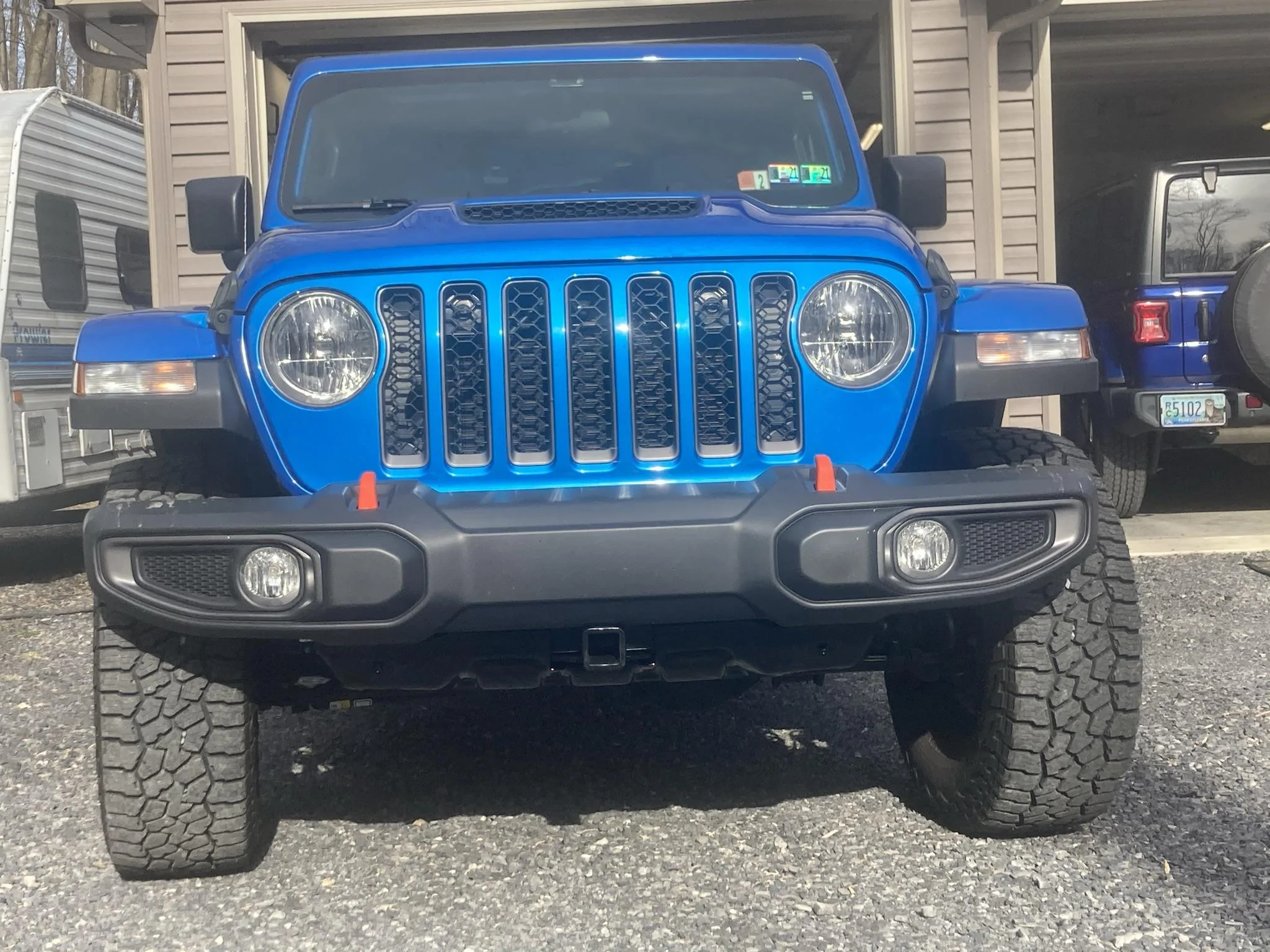

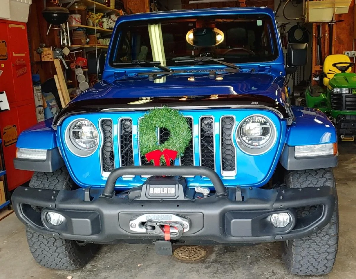

Are there any clearance issues if the curt front hitch is installed on a rubicon with the steel bumper? There is a bolt dead center on the bottom of the steel bumper..
40,465
53,916
I have a Curt hitch on my JT with a Steel Rubicon type bumper and Gladiator Rubicon skid plate......
The truck is Overland but the bumper is the same type used on Rubicon.
The skid plate is genuine MOPAR part number for Rubicon with steel bumper.
