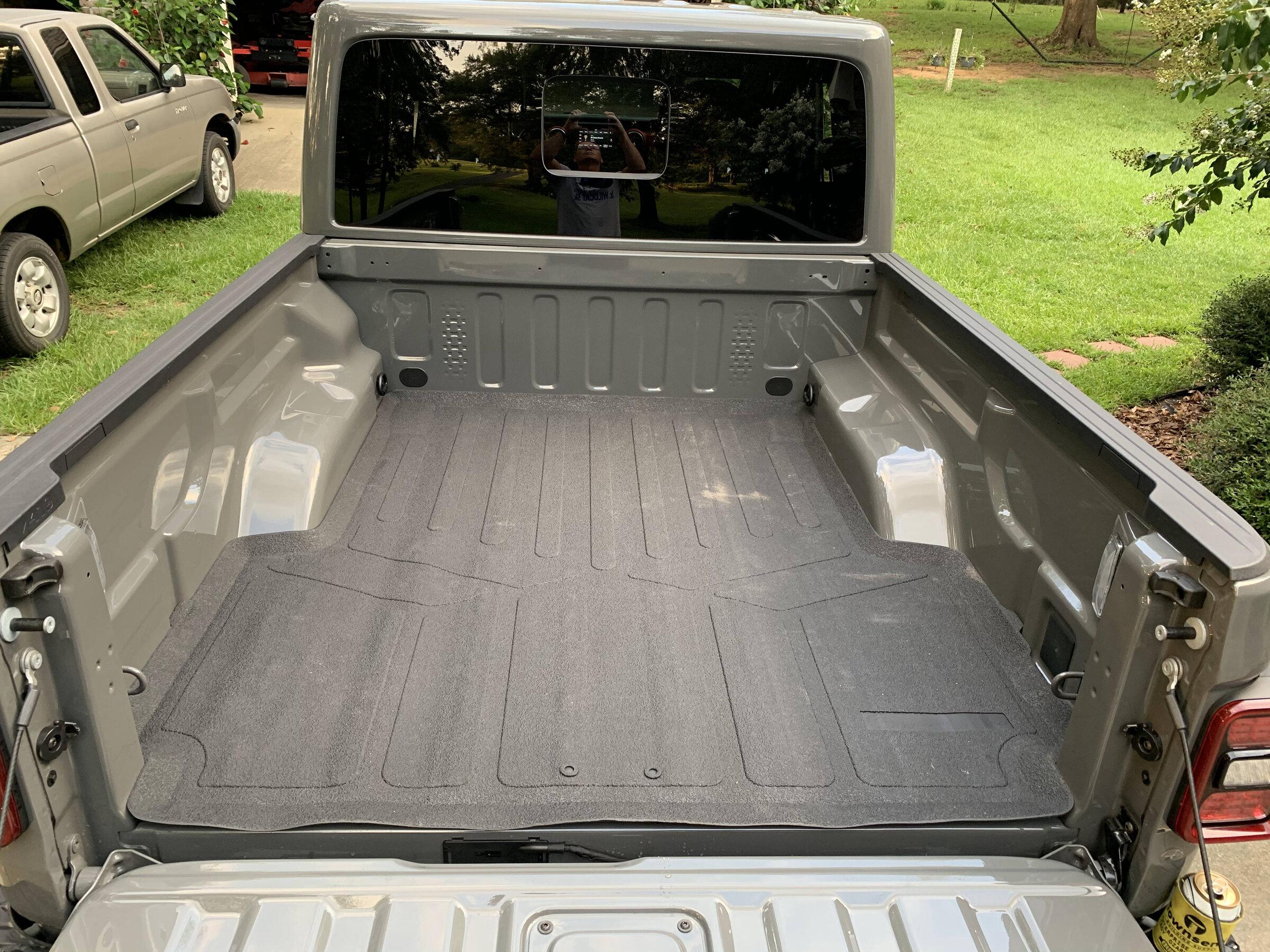

I used some 16x16 rubber tiles I had and cut them and made a bed mat. Got them all for free so I figured I'd put some of them to use. They came in handy

I've run the full Bed Rug in my last 2 trucks, and Bed Rug XLT (floor and tailgate) in the Gladiator. I Line-X do the bed then added the Bed Rug XLT. I love it. They are way more durable than you would think and you can clean them up with a pressure washer if the get dirty. Added bonus is the it doesn't tear up you knees when you crawl around in the bed.
