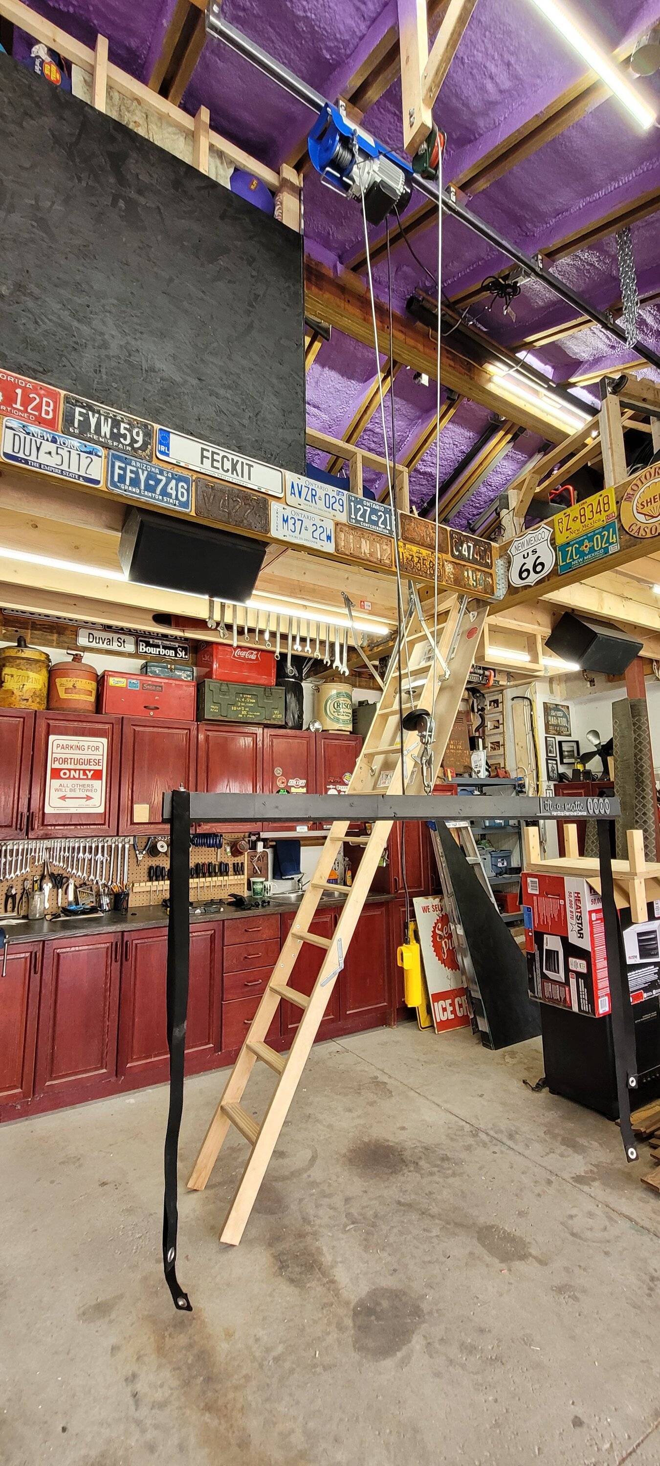

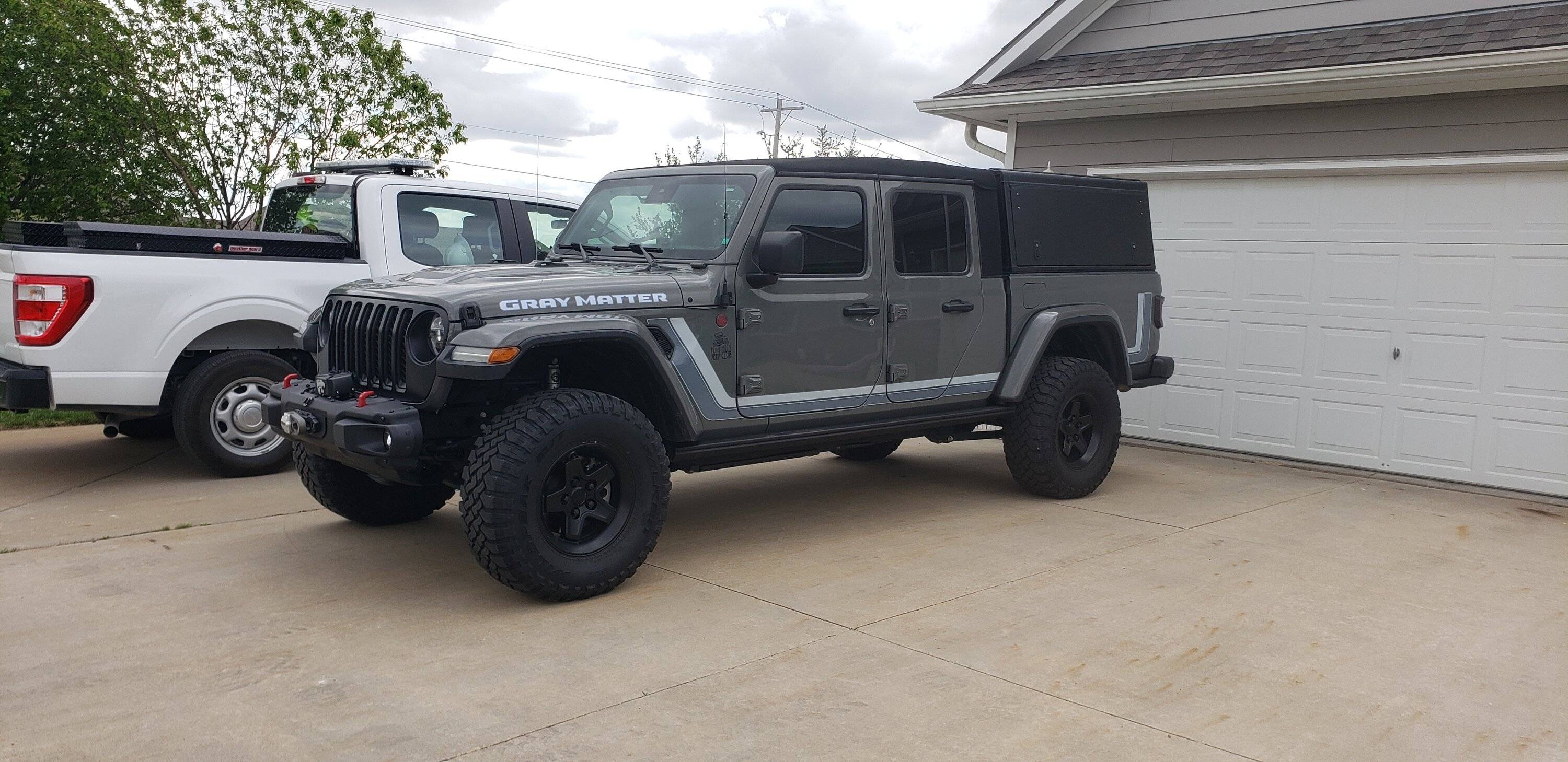

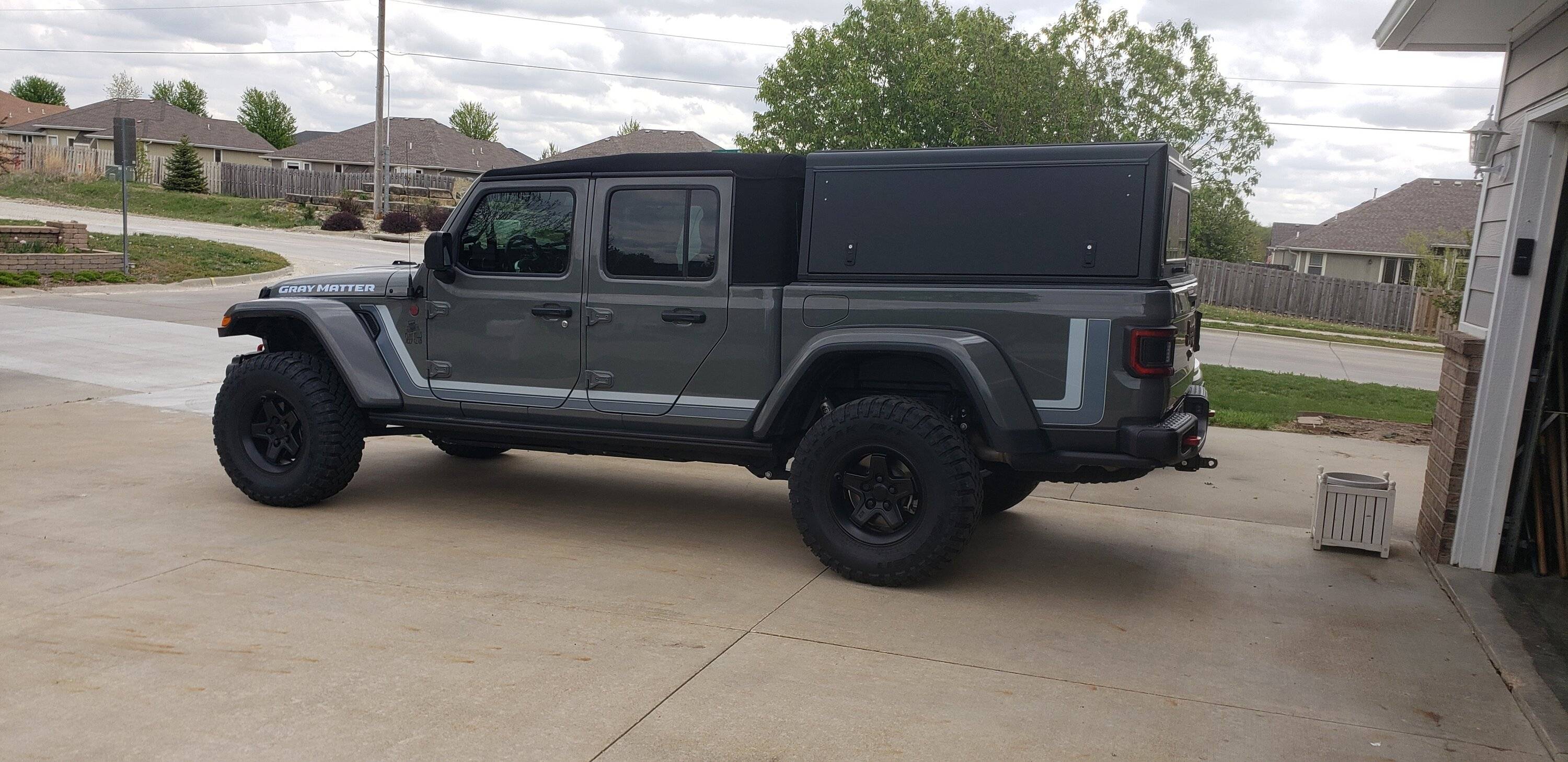

Update:
To make sure I got the soft top installed the first time, I decided to remove the Alu-Cab so ensure it was not a problem. The fewer non-OEM variables the better, was my thought.
Now that I am done, I can say for certain I can install/un-install the soft top next time without removing the Alu-Cab... but I'll prefer to have my hoist in a useful spot on the garage ceiling (it was not for this swap process)... I could not use it... it's still where it was for our JKU.
Side Note:
The Mopar grab handles that came with my Gladiator do not work with the mopar soft top. Not whatsoever.

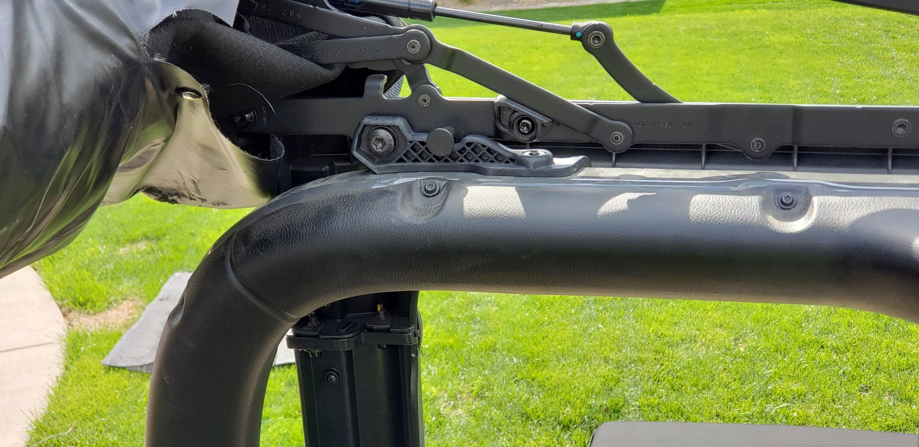

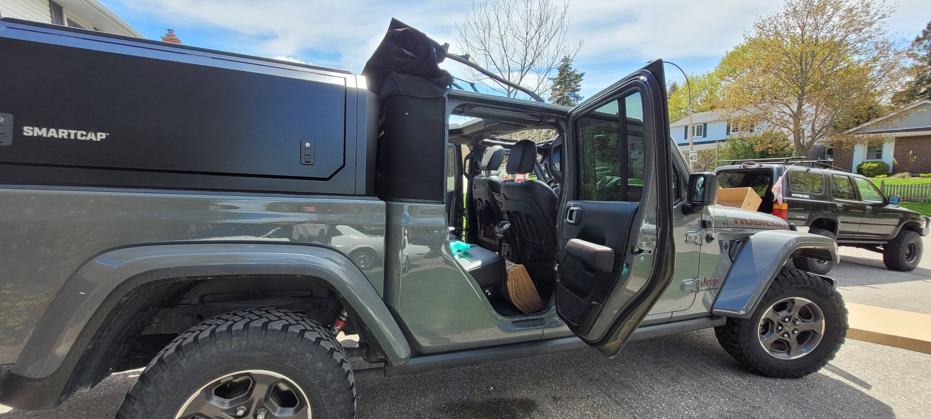

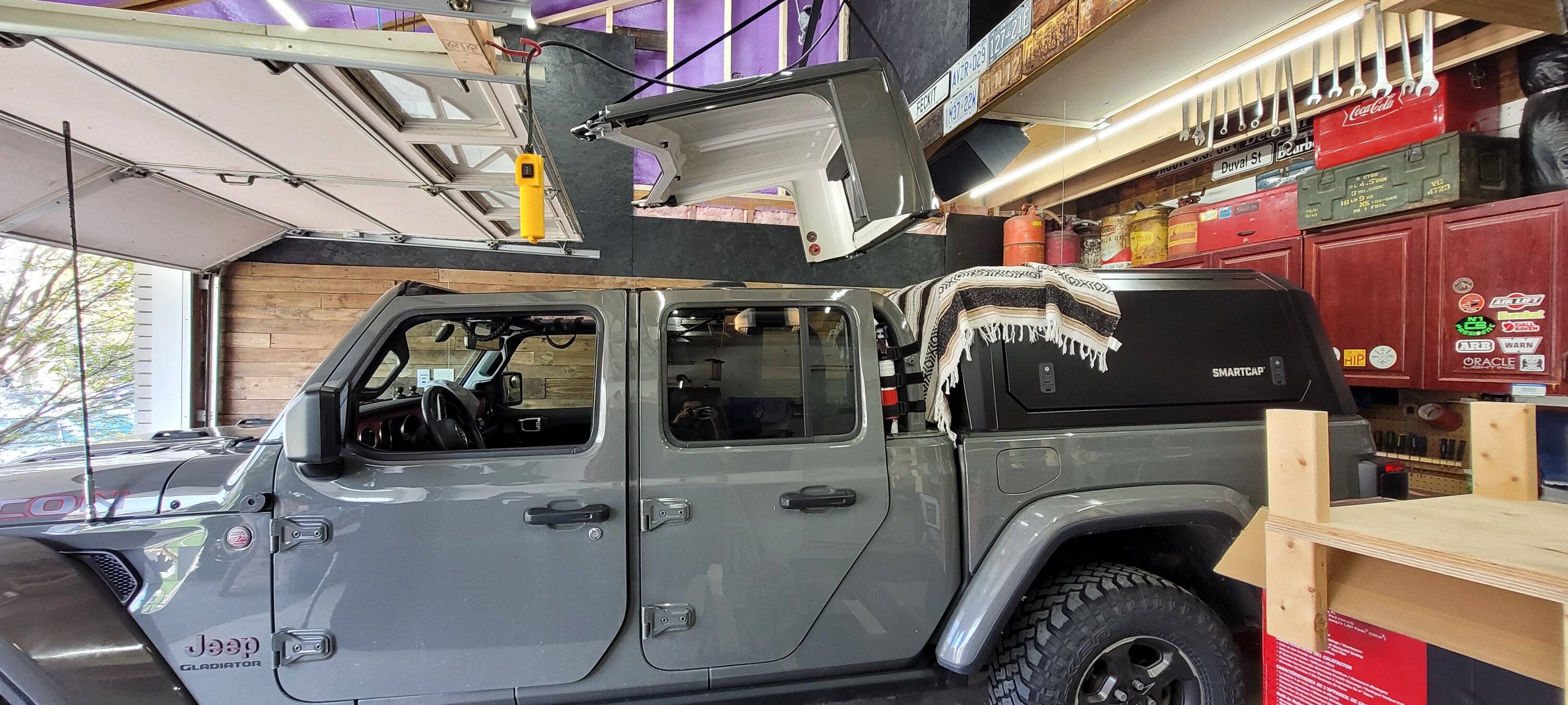

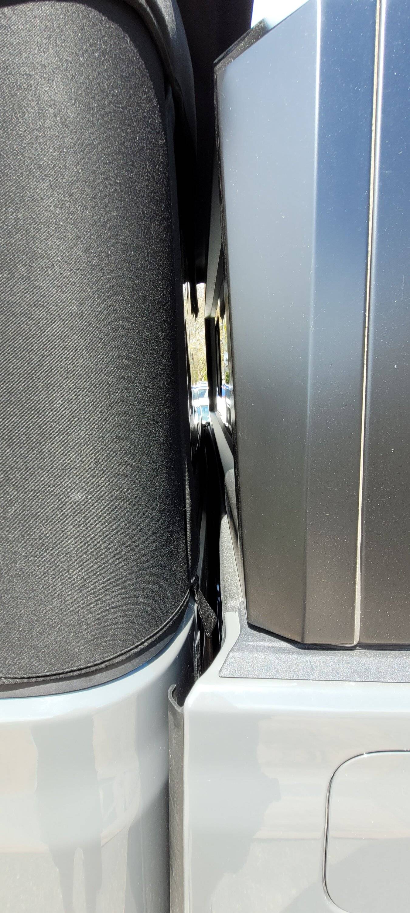

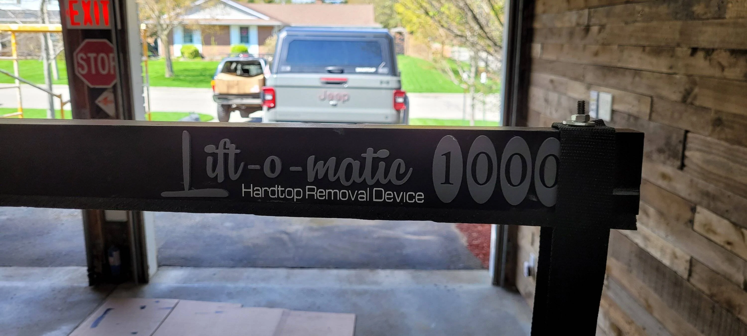

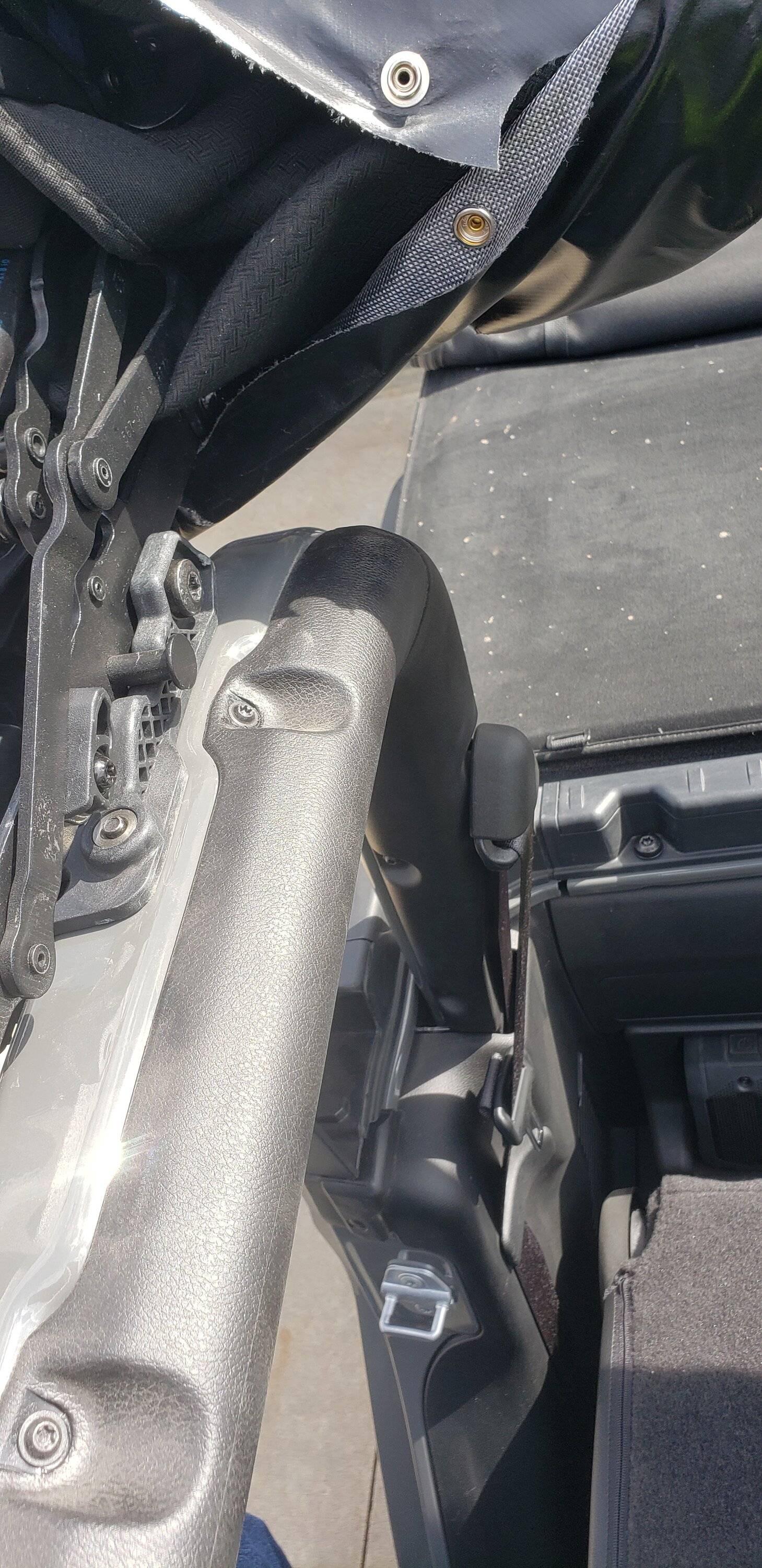

I finally got around to installing the soft top with the smart cap. The first step was to remove the hard top. That would be a pain to remove it manually but thankfully I have the lift-o-matic 1000 Hardtop Removal Device.
The install was very straightforward. The tough part was, as you might guess, getting that rear window in. The trick to make it easier is to leave it out in the sun while you install the rest. I slid the top side from inside the truck. Snapping down the bottom was made easier by opening the top and getting into the bed of the truck and, through the cap window, reach and snap down. Wasn't the easiest thing I've done but very doable. So go ahead, get that cap (if you can find one) and install that soft top. Also the cap makes the top look less man bun-y. Time to go enjoy the sun.
