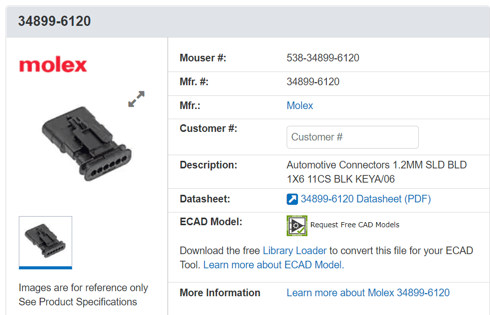

This is one of the pieces needed ->
https://www.mouser.com/ProductDetail/Molex/34899-6120?qs=dZkkjGgKZQGsghnf2bYOJA==

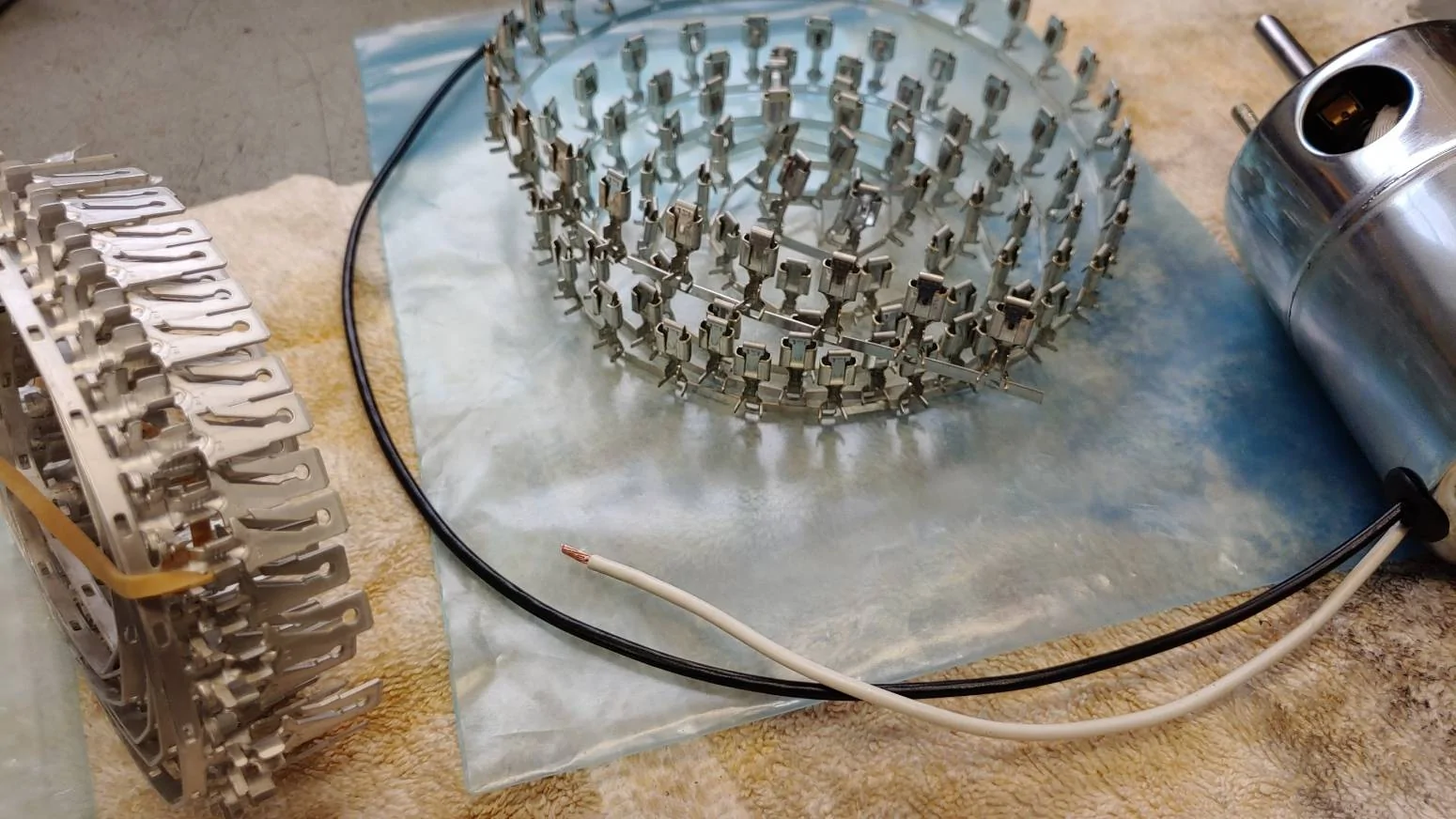

I do restorations, wiring harnesses, etc. for cars from the 60s-80s. Work for show cars, restoring and plating parts like wiper motors, alternators, etc. Usually the wiring is toast.
I still have a NOS (New Old Stock) alternator for an early 1960s Jeep, correct model, etc.

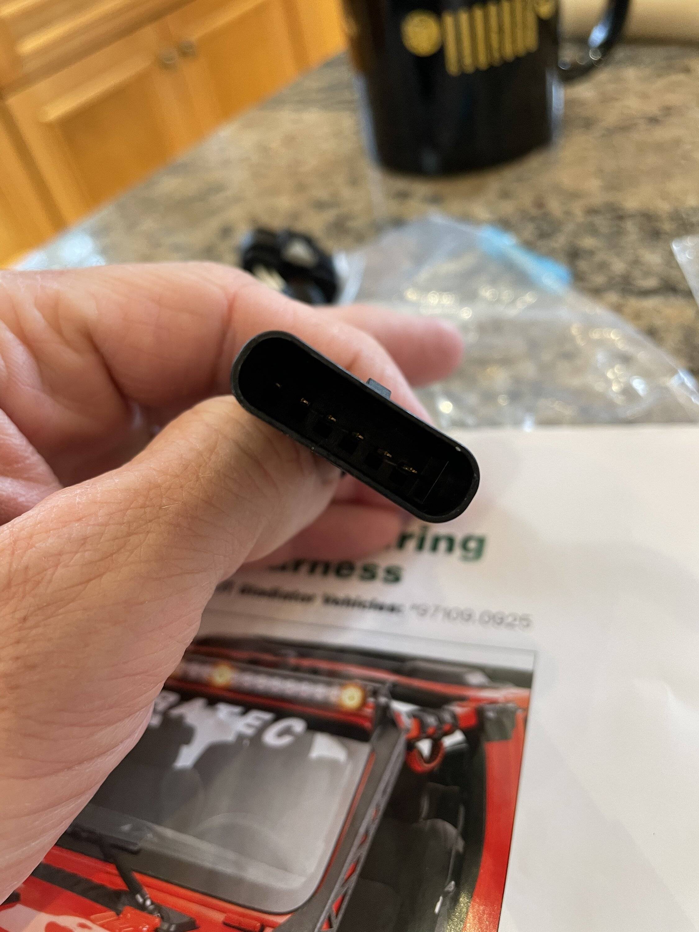

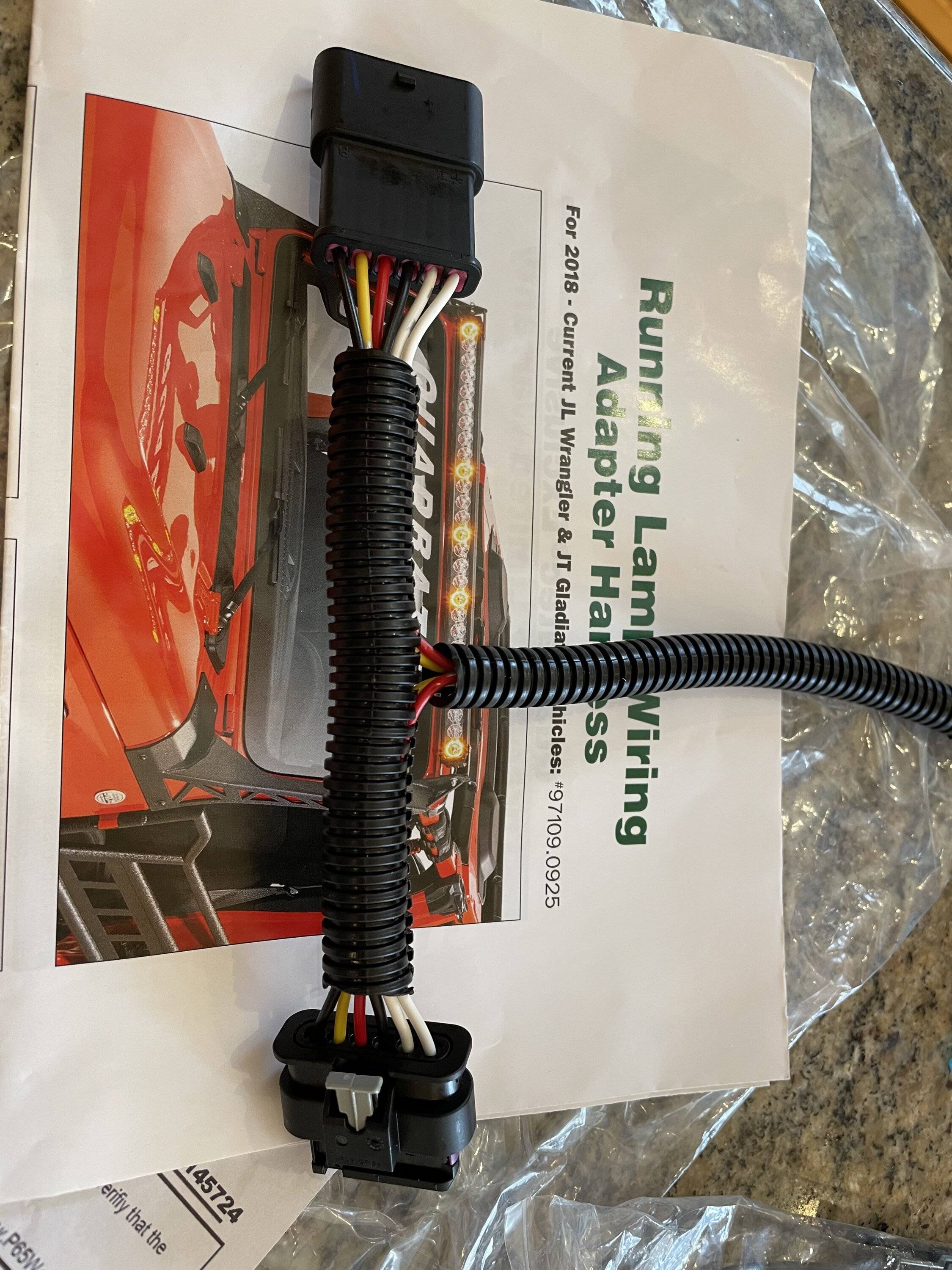

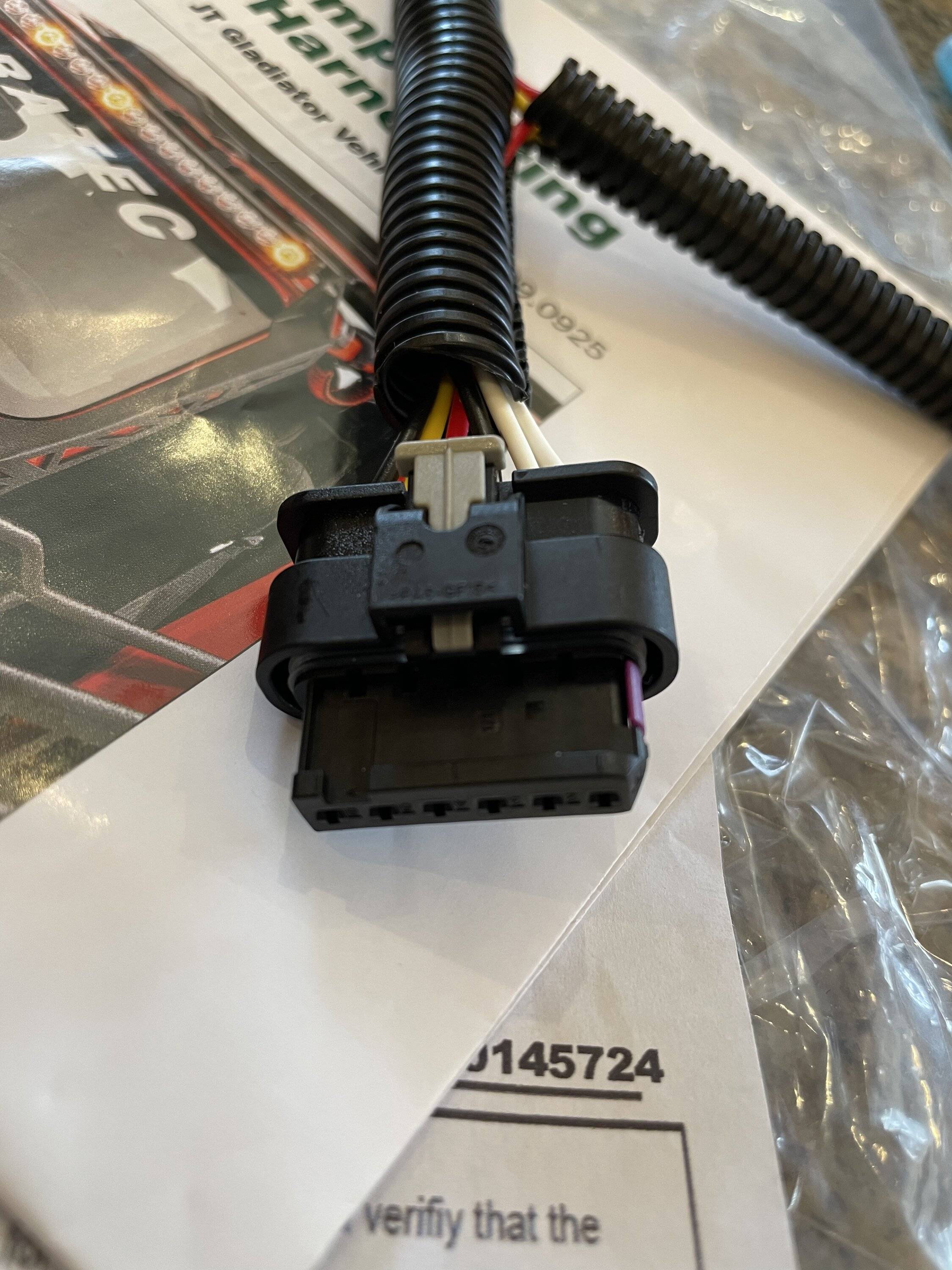

Thanks in advance. Can anyone tell me what type of connectors these are? They’re part of a quadratec DRL harness, but I want to buy some to create a similar harness to splice off of the blinker circuits without cutting or tapping the OEM harness.

I posted a link to one of the parts he needs because the part numbers are on the shell.
Once you know one, you can find the other.
The male connector is Molex 34899-6120. The pins for that connector are TE Connectivity 1418762-1.
The female connector is Molex 34900-6119.
The sockets for that connector are TE Connectivity 7-1452668-1

I've run into issues with the Prestolite wiper motors I restore - when I buy reproduction harnesses and need to change the ends to match the switch configuration, the shells and connectors they use are the same number but don't fit the original shells so I have to salvage shells, and snip the ends off the reproduction harness and put on new connectors. There's an incredibly small difference in the length and one won't index into the plastic shell correctly. Same part, same number. One company in the world makes those harnesses. I bought every last one of them last spring and was told no more until the end of last year.
A guy from Kenosha has sent me two boxes of used regulators, over 40, to test, clean, restore the appearance on them and do whatever is needed for the connectors on the pigtail. Can't buy the plastic connector shells anywhere.
