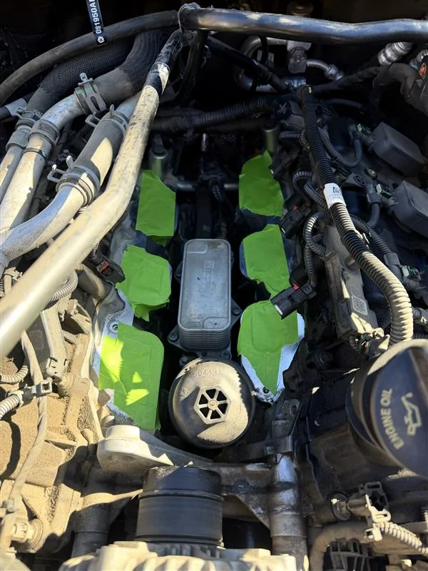

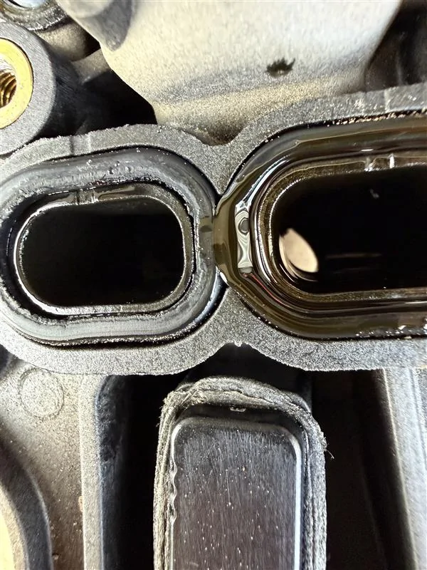

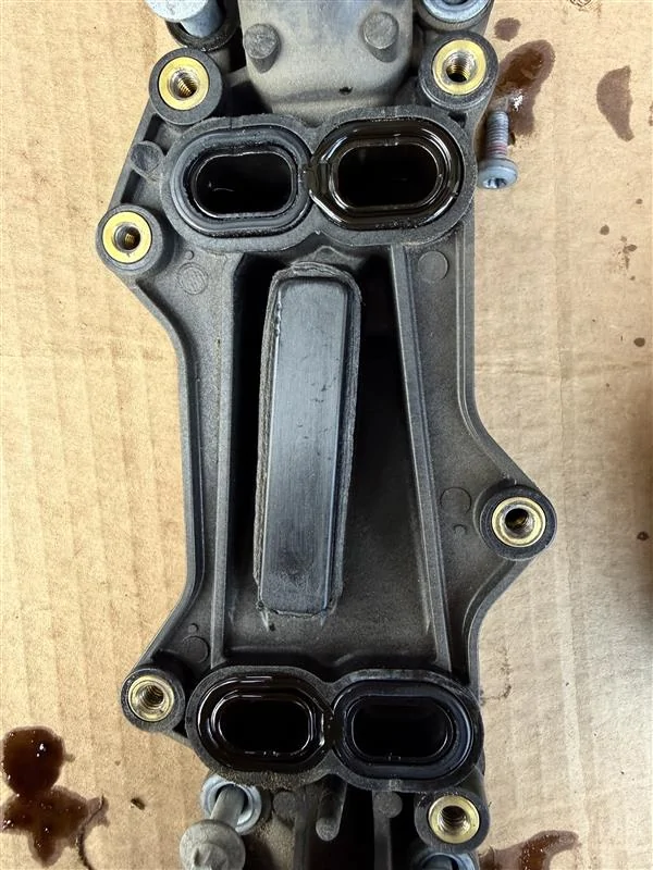

Mine ended up being coolant loss from the oil cooler / oil filter housing
May I ask what year your Jeep? Can you give me more details on how you discovered that you resolved the issue
2020MY. The OFH has a known issue where the o-rings that keep the oil and coolant separate like to blow out and leak into the v of the block. My v was filled with oil so it was tough to tell if there was also coolant in there, but I did notice the coolant smell reduced significantly after I replaced the oil filter housing / cooler.
It's kind of a horrible job to replace.

More here.
https://www.jlwranglerforums.com/fo...ement-and-upgrades.117718/page-4#post-3445077
