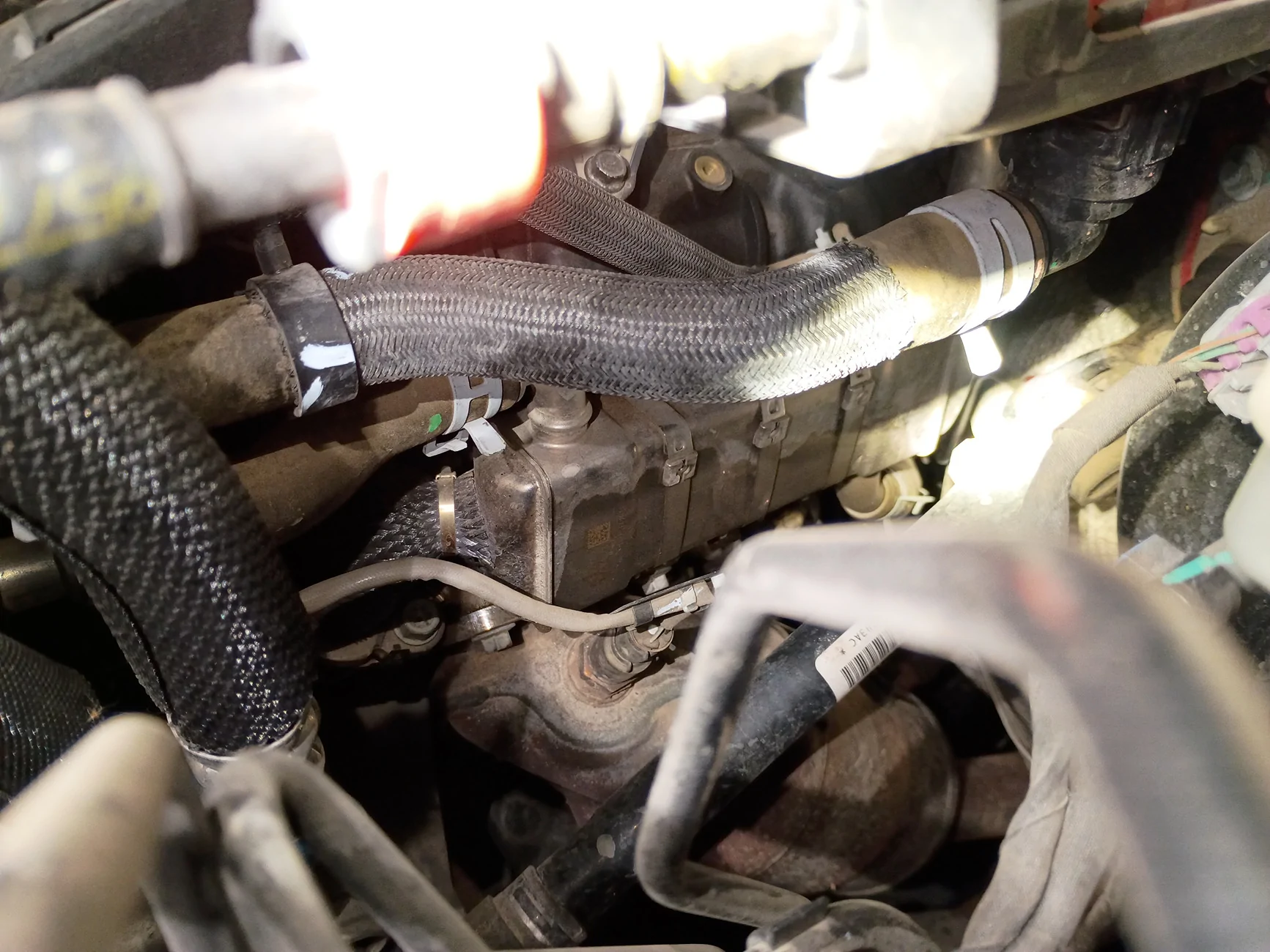

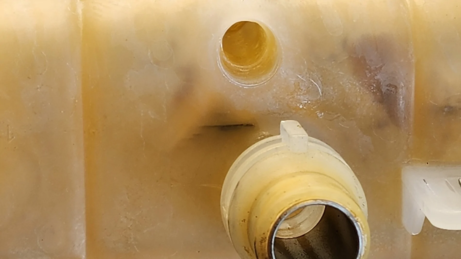

First noticed an issue last week. I got home and putted down a long gravel driveway. Got out to do something. Left the Jeep running with A/C on so radiator fan was running. When I got back to Jeep, fan was on full jet engine mode. I got in and slider gauge was normal. Digital gauge read 230°F but falling fast. That was odd.
Next day driving to the coast and I noticed it was running warm just going down the highway. Around 215°F. I got stopped in traffic and it crept up to 243°F. I was expecting it to drop quickly like it did at home but it didn't. I pulled over and did about 5 full blast heater start/stop cycles to get it to 210°F. Then I removed the cap and added about a 1/3 gallon of water. Started it up and it stayed much cooler at idle and for the rest of the drive. I added water once more after a stop to eat.

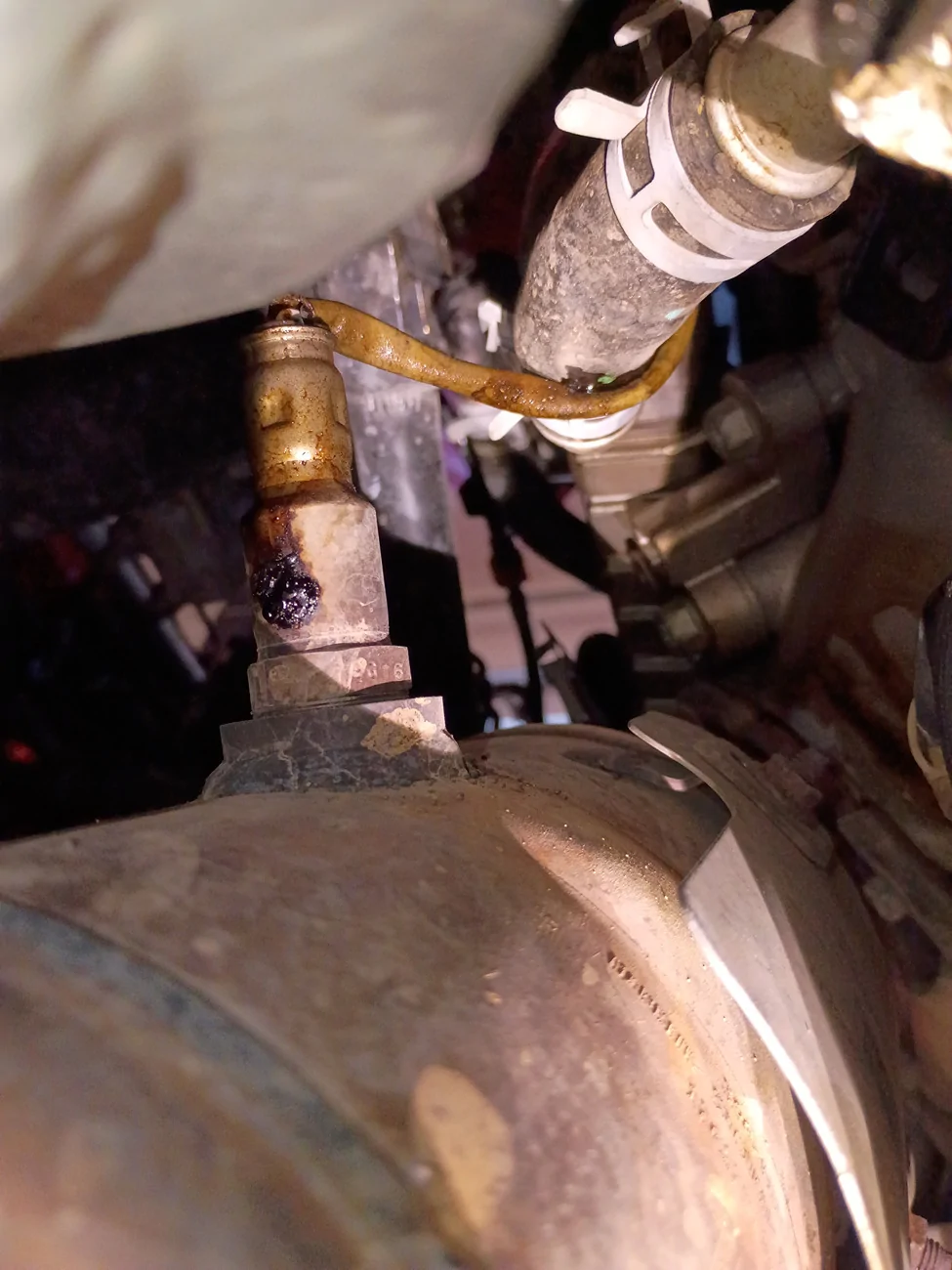

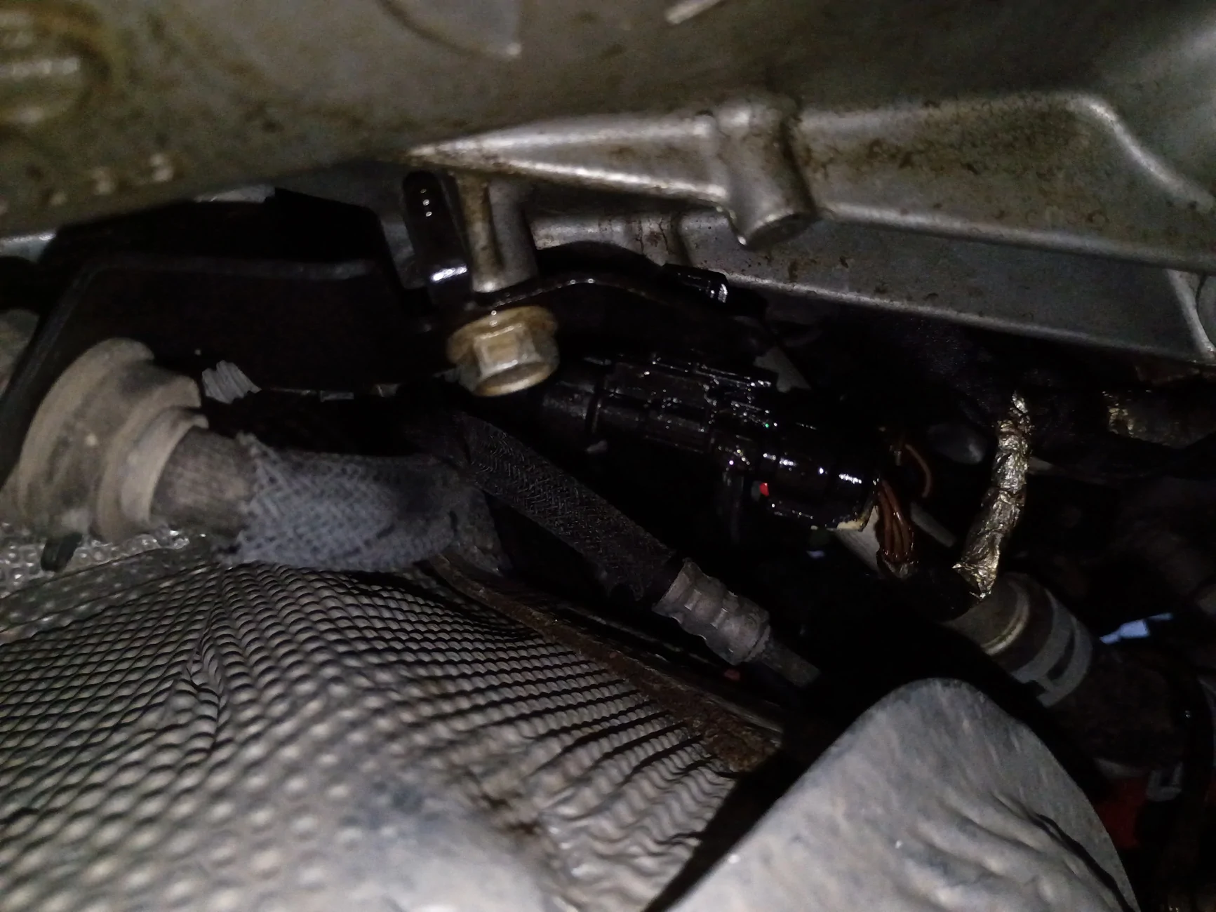

When I got back home I checked the level when cold and added a little bit more water. In total I have probably added 2/3 gallon. I've checked the level two mornings in a row and I'm fairly confident I am losing coolant, but all hoses are dry. There is a residue on the EGR cooler outside of it, on the O2 sensor, and there is a wet connector below that. I can't tell if the residue is oil or coolant. I bought a pressure test kit that just arrived this morning so I will check it Saturday morning when it's cool.
The odd thing is that it is running hot sometimes.... When I just pulled in to work I stopped at the gate to badge in. By the time I parked coolant was 219°F. Either the thermostat is randomly restricting flow, or something else is randomly putting more heat into the system. This is a cool morning relative to other times I'm driving lately. I don't understand why the temperature would be fluctuating so much. I don't generally watch the digital gauge, but in all of my 6 years of owning it I have never heard the fan run like it did twice last week. I also learned that the slider gauge is at the normal location between 128-243°F.
I don't really think I can smell coolant. I have one slight residue on the garage floor under the EGR cooler. Again, I can't tell if it is coolant or oil because it is so slight. Cap is holding pressure.
Pictures attached.
Any ideas?
