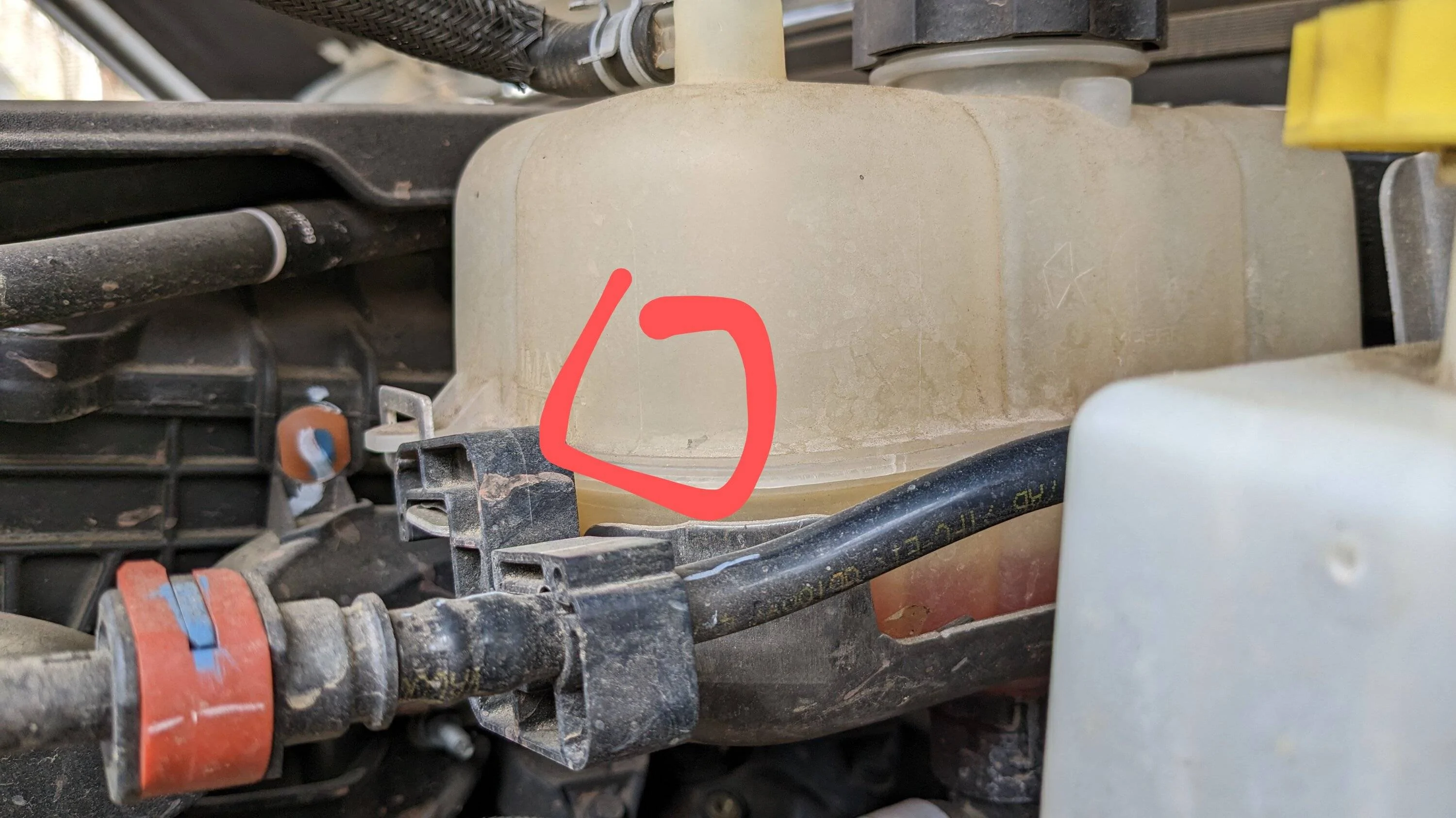

It's been about a year since this post and when I filled it up to the black dot (hard to see so I circled it). Got an oil analysis kit ready to go at the next oil change. No other symptoms other than disappearing coolant. No signs of leaking or smoke or unusual looking oil when changed. Sitting at nearly 50k miles.
So you are saying that 1 year ago it was at the black dot and now it's below the seam of the tank? That's hardly a loss to jump about.

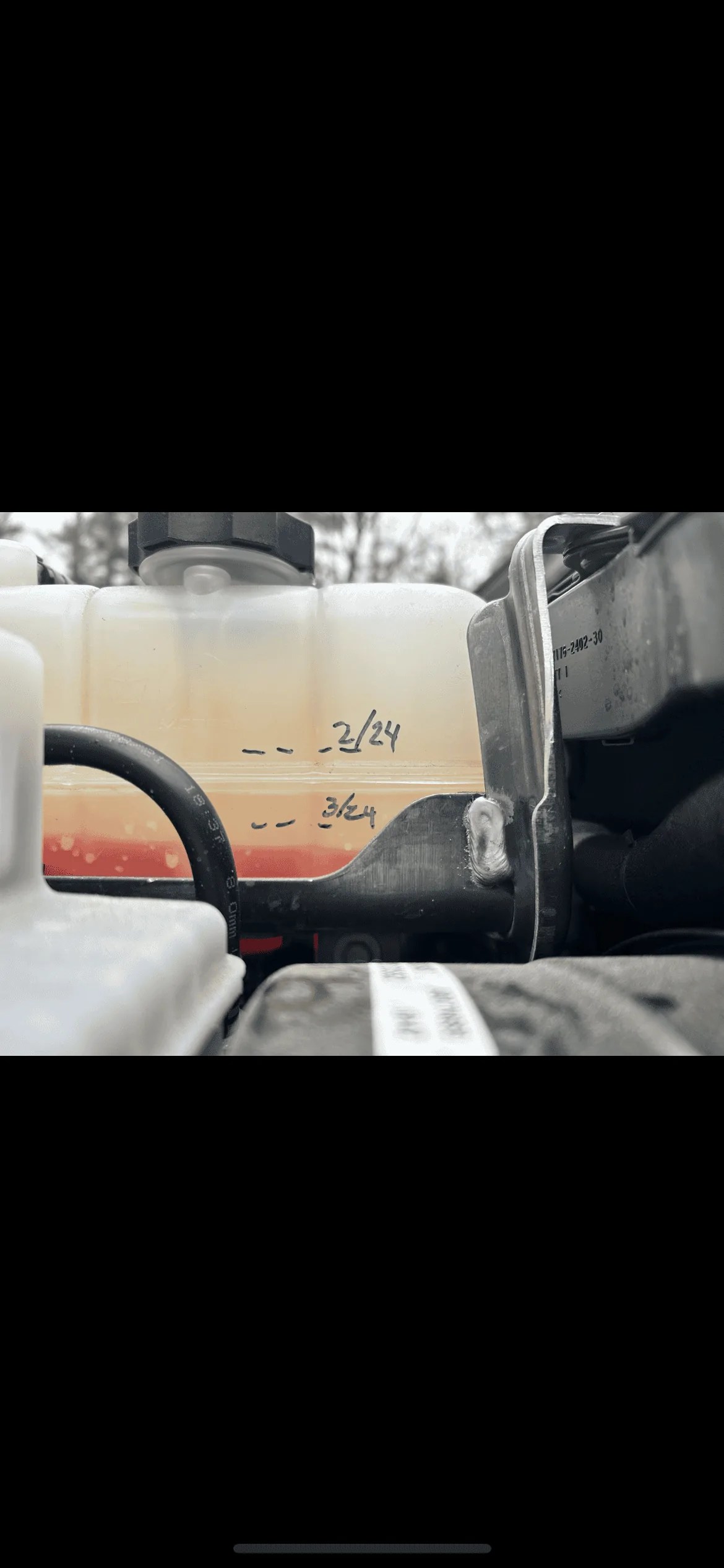

My photo from 2/24 to only 30 days later…. 3/24.
Now that's a loss.
Yes, it took 16 oz to get it back up to the line. Just wondering what to gauge as normal - third Jeep with this engine and the only one that's needed coolant at this rate. I will be interested to see what the oil analysis says. Maybe it is just evaporating off about an ounce a month. With no other symptoms, it's just an item of note for now.

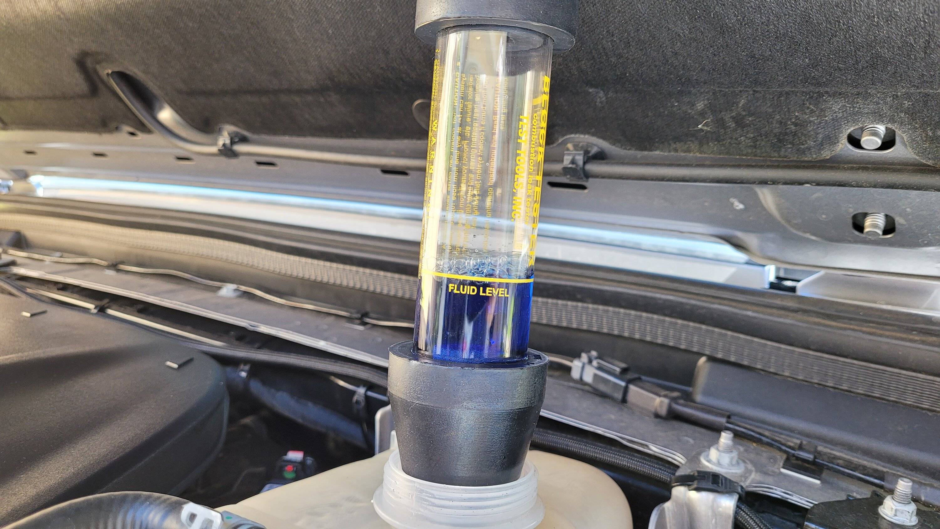

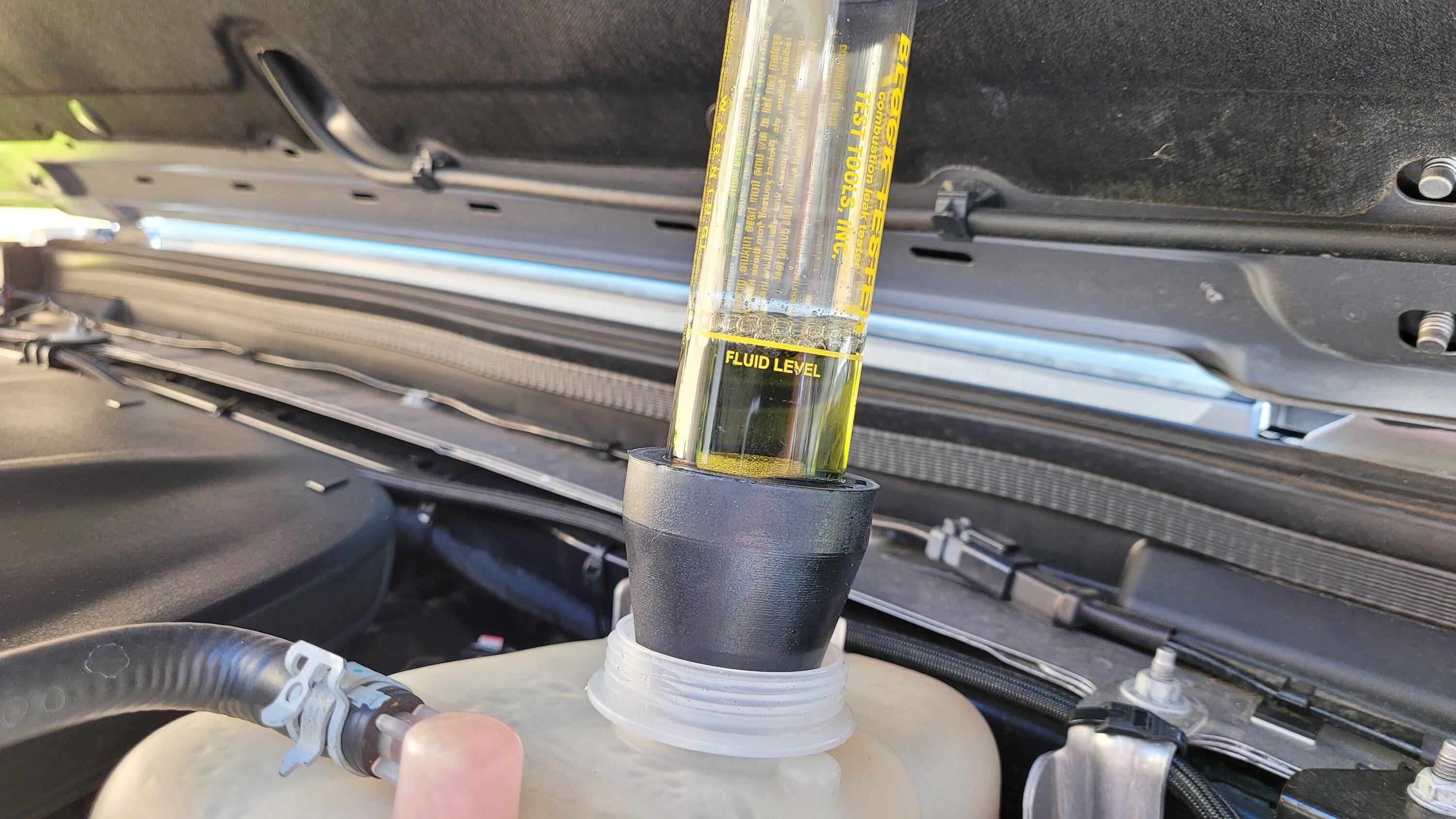

Darn, block tester confirmed my suspicion regarding disappearing coolant. Pressure test didn't show anything (pressure remained steady at 10, 15, and 20 psig), while engine was hot and cold. Block tester says otherwise. Off to the dealer...
That looks exactly like the one I used years ago in the shop!
The situation is that during combustion the pressures are high in that chamber, possibly forcing gases into the coolant. But when off, the leak can "seal" - not being forced open by the vacuum of intake and pressure of combustion.
I forgot - what are these cooling systems rated for? 20 psi? It's a lot higher than the 12, 13, 14 or 16 of years ago if I recall correctly. That ,means when hot and running, it could be pulling in coolant during intake when it's really hot.
Either way, smart move, good catch.
Now the tricky part - WHERE is the problem? Head? Gasket? Block? Is the EGR cooled by the coolant?

The coolant cap says 21 PSI. You're asking the right questions regarding the source of the problem. Here are some additional info, some of which may be related/unrelated:
1. I had to add about 16-20 oz over the three years, 22k miles.
2. NO engine codes ever (no misfire, nothing).
3. I did smell coolant near the FRONT of Jeep during start up. Nothing noticeable at the tailpipe (hot or cold). Smell was most noticeable when remote starting.
4. Smell dies down after engine is hot. When I open the hood, I can smell it just above the radiator on the drivers side (just a faint scent on passenger side). I don't smell it near the reservoir or cap, even with the cap off.
5. No drip marks anywhere, ever. Not on the driveway, not on any components (axle, skid plates, etc.). No visible signs of leaks/seeps at hose clamps or plastic/aluminum interface of the radiator.
6. No calcification or steam marks anywhere under the hood that I can see.
7. No change in oil consistency or level. The three oil changes I have done resulted in just about 5 quarts coming out. I will send in an oil sample for analysis at the next oil change.
Your question about the EGR cooling has me curious. A quick Google search returned some information regarding the EGR cooler (about $800, by the way). I want to learn more about it and how it works. Not positive, but I think it is on the drivers side (just forward and below the coolant reservoir).
Am I mistaking what I thought was coolant smell with something else? It's the sweet, burnt coffee smell.

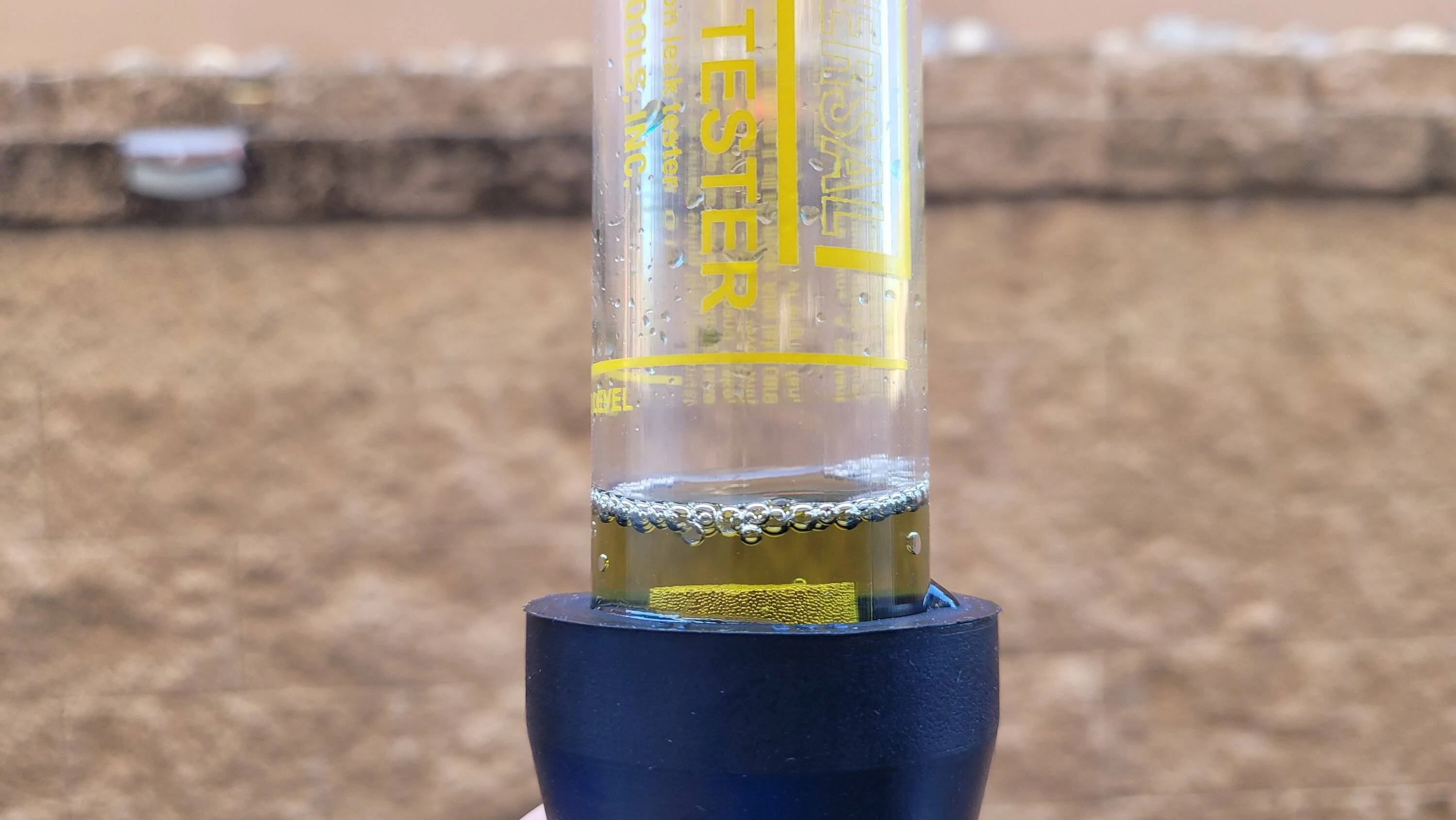

The test fluid is very sensitive to CO2. I blew a short puff into the test kit, and it changed color immediately, much faster than when I tested the Jeep.

The test fluid is very sensitive to CO2. I blew a short puff into the test kit, and it change color immediately, much faster than when I tested the Jeep.
Over the years, especially in the 70s and 80s, I had my share of coolant eating situations. The last shop was just off I80 and not far from I35. A LOT of summer time vacationers, hot weather, long trips with loaded cars and trucks.
I got used to the burned coolant smell, unmistakable. I guess I never likened it to burnt coffee, but....
In those days, if there were cats, they were the first, crude types, a few with AIR (Air Injection Reactor) systems (air pumps shoving oxygen into the exhaust manifolds and head pipe just ahead of the converter) It smells different to me from a non-cat exhaust vs. one with a cat, and then modern systems have multiple converters in the exhaust.
Anyway, anything from cracked heads (usually around the valve seat areas) to cracked blocks, usually in the cylinder wall area) to warped heads causing the gasket to leak after it had been run hot once.
On my son's Iron Duke in his SX4 the head gasket had actually been eaten away a bit by combustion gases passing between two of the cylinders. It actually ate into the head a bit.
There are so many possibilities, even more with these.
Normally a pressure test can eventually lead to the origin, I've found sometimes you need to let it sit pressurized for a while, then manually turn the engine over to change where things are sitting internally.
The easy ones were where you put the combustion gas tester on the radiator (old days) and with the engine running, watched it slowly bubble as the color changed.
