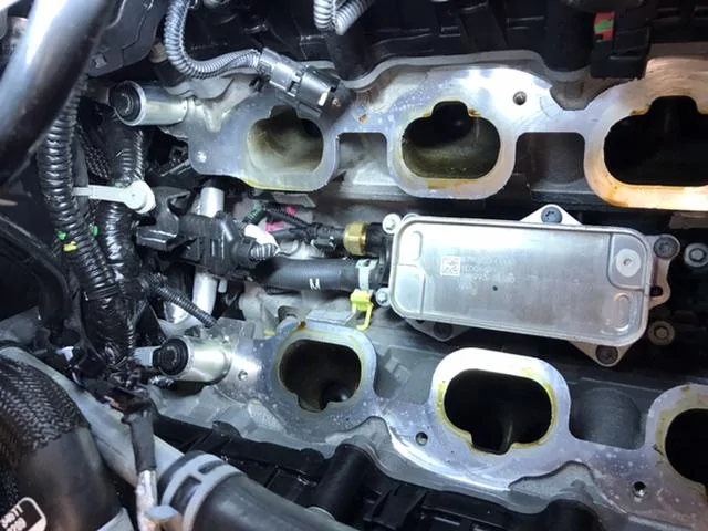

I had the antifreeze smell outside when its running. My serv dept found out its a clamp that was never tightened (by removing the yellow part). Its all apart rite now.
