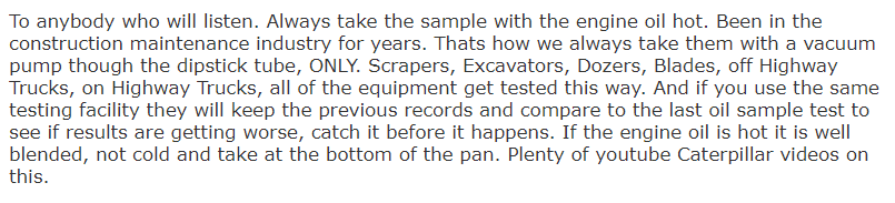

From experts who do this for a living -
Jeep Gladiator Disappearing Coolant 1683642110524
Jeep Gladiator Disappearing Coolant 1683642151407
Every resource I can find that is from people who either do the testing or who are in the business of maintaining equipment say the same -
Hot sample - run it, mix things up, hot oil
always through the dipstick tube
not from the bottom of the pan with cool oil.
You do not want that concentration because things settle to the bottom and can skew the numbers making things look a lot worse than they are.
the bottom of the pan is an accumulation of things over time - not what's in the oil currently.

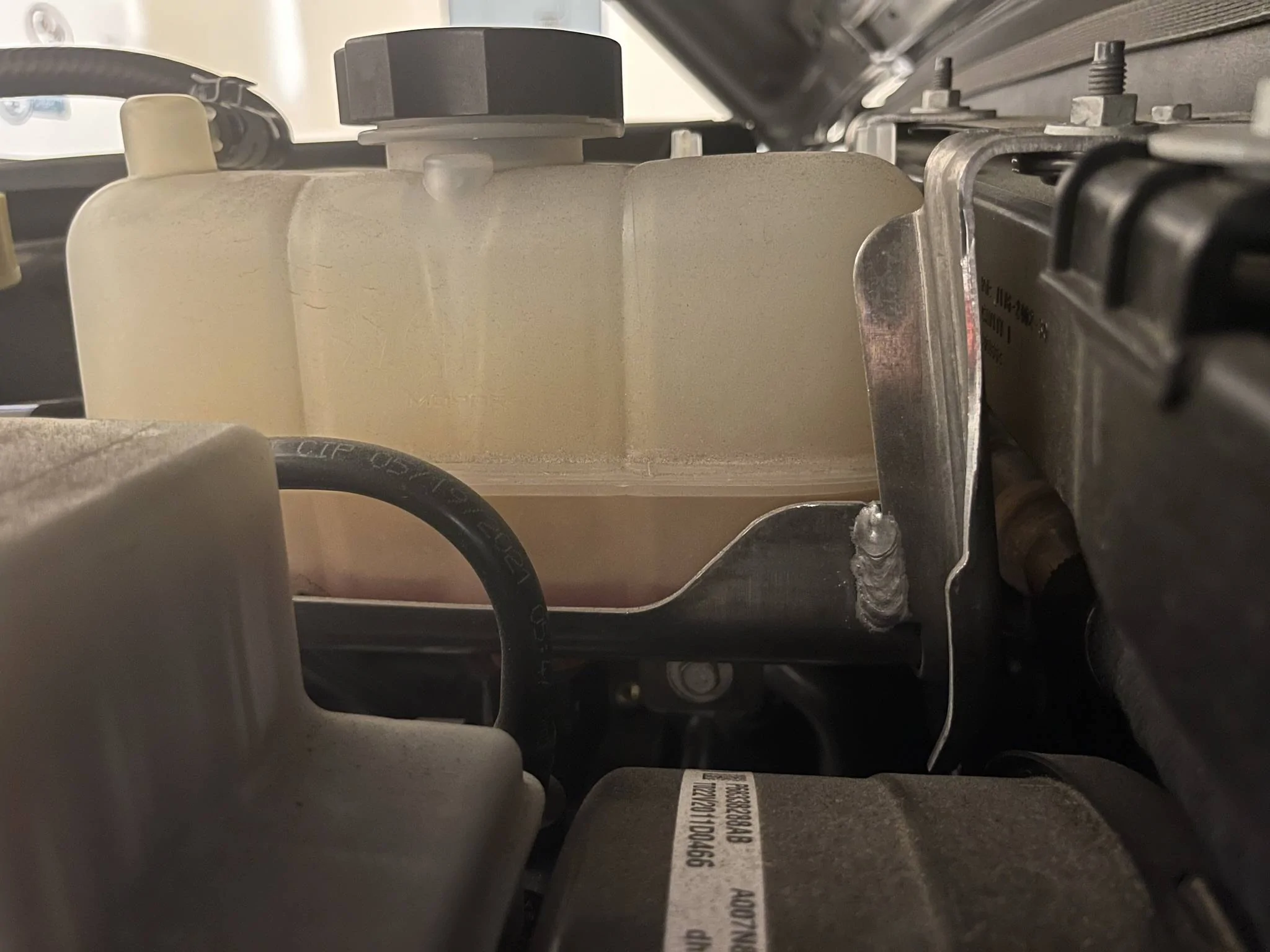

Should I go ahead and add some coolant in the meantime? (I read your note earlier on OAT vs HOAT coolant.)

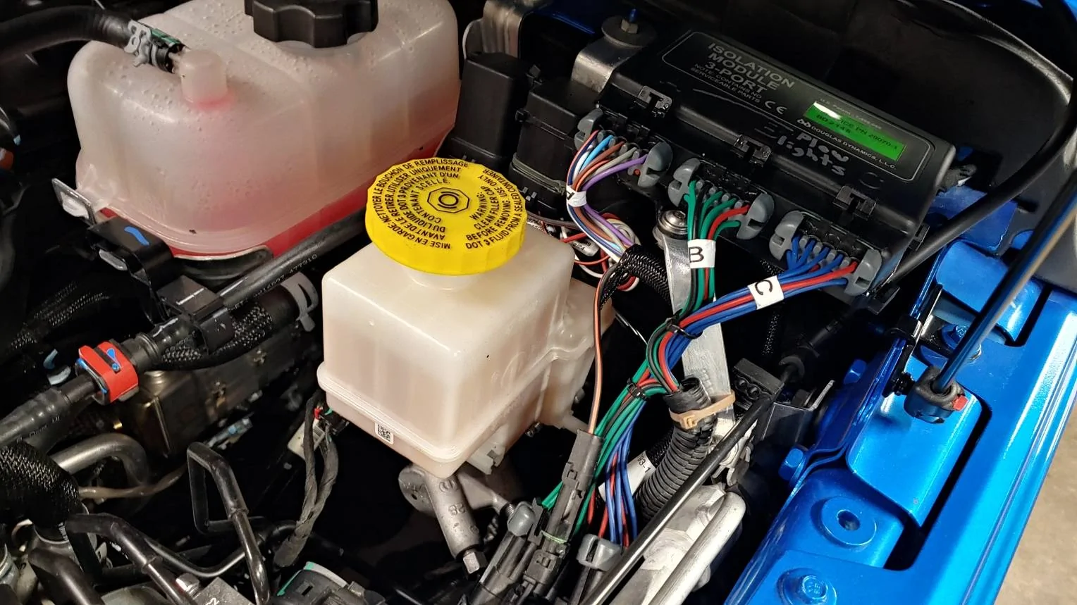

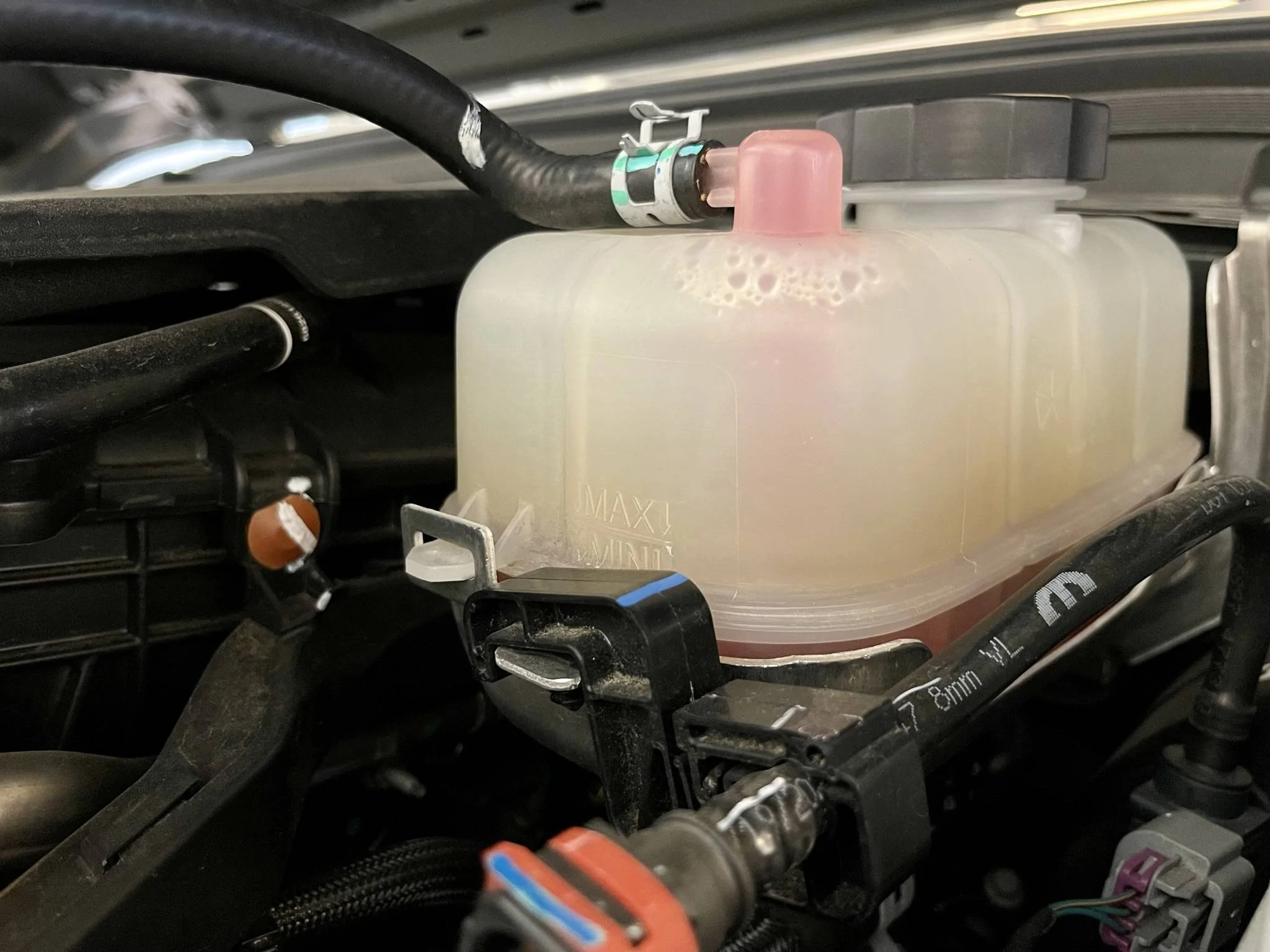

Topped it to the max last night. The coolant level was still at max this morning when cold. I ran a few errands today. Here is where the coolant level is afterward. What is going on with the fluid holding at the top of the reservoir?
That's normal. Unlike vehicles with the radiator cap, that tank is kinda like part of the radiator if you will. The closed thermostat air locked that hose. Lower coolant level will release it.
249
40,519
54,123
Yeah, what Vtur said. It's a semi-closed system. As the coolant expands in the cooling system it's pushed into this tank. As the system is cooled after a shut-down, the coolant contracts a bit and coolant pulled back from this tank - sort of a vacuum or siphon situtation.
100% normal.
