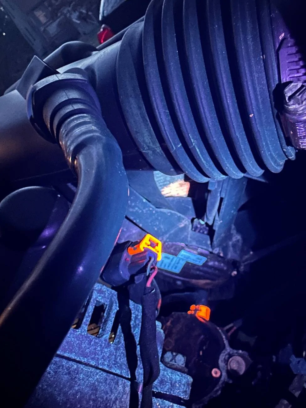

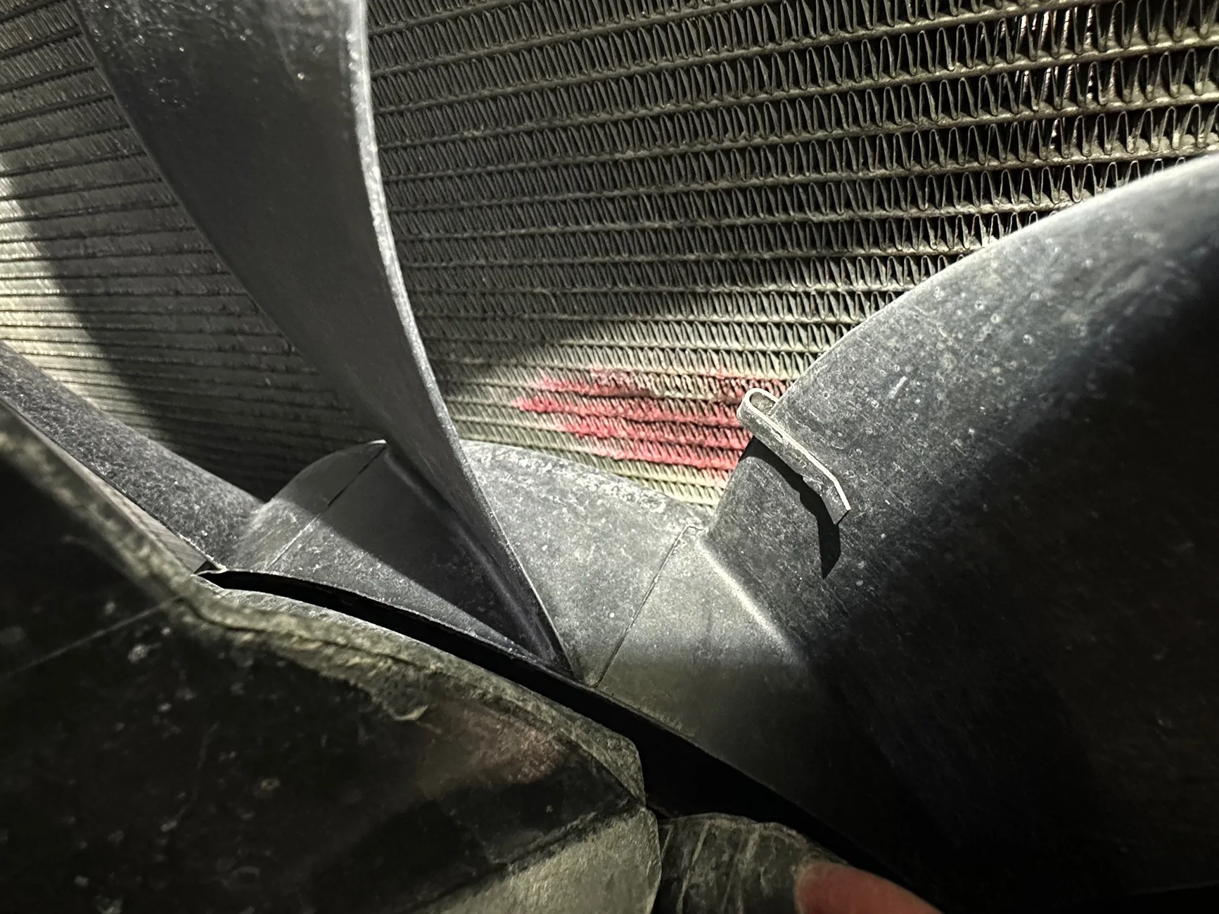

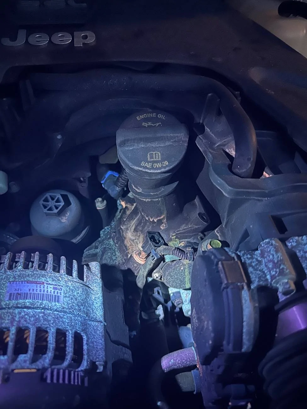

A couple months ago Jeep replaced my passenger side head/cams. A weeks ago I noticed my coolant low sent it in… they said no leaks and they overfilled reservoir told me to keep an eye on it. It’s bone dry. So I scheduled another appointment.
Took my Olight with the UV setting and found 2 areas I suspect leaks in about 20 seconds. Going to be interested to see what the dealer has to say.
Jeep Gladiator Disappearing Coolant IMG_5969
The big orange spot in the middle is the center of the radiator and I saw mist particles blown out the fan all over the engine.
T
Jeep Gladiator Disappearing Coolant IMG_5968
Is this connected to the cam/head work? Idk probably not unless they nicked the radiator. I just don’t have time in my life to be driving to the shop all the time.

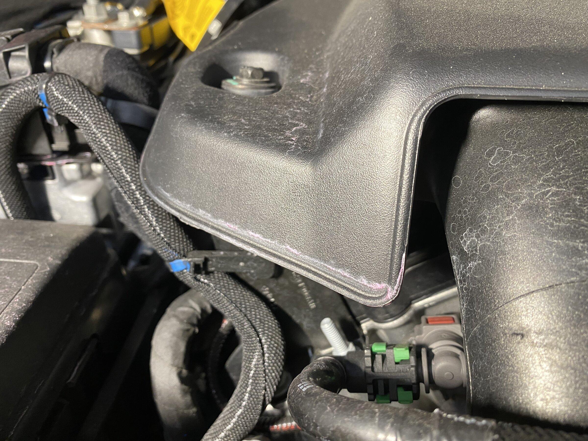

I have one and it’s awesome. Just wait until you get a glimpse of a scorpion! They reflect big time when hit with a UV light…
Got a couple in TN over new years week.

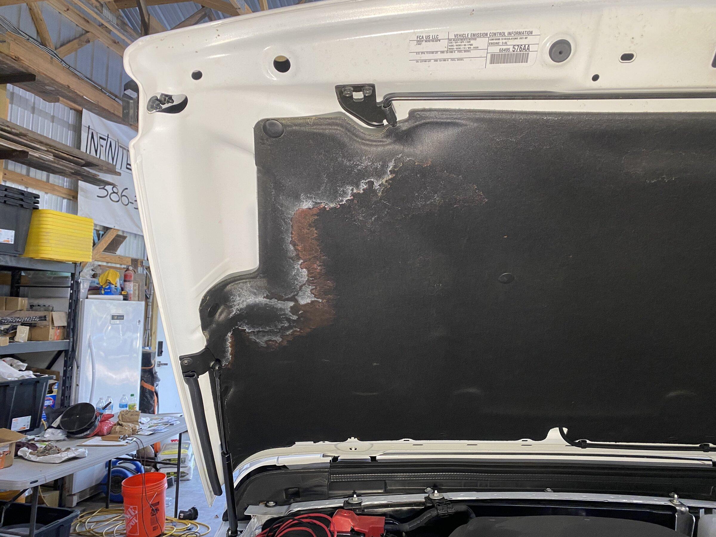

Those pinkish stains, especially on the hood liner, are very possibly a result of the car wash. The soaps and waxes in car washes will do that. Obviously if you are regularly losing coolant, there is an issue beyond the car wash. I thought forever it was coolant but maybe have added 1/4 cup off coolant to the system over the past 2 years, so that didn’t make sense given the constant pink stains on the hood liner. I imagine if you taste it, tastes like soap not coolant lol. Haven’t tried that yet….
250
40,603
54,292
I worked part time in a car wash as a teen years ago - I saw what those soaps and such do to steel pipes, pumps, whatever. Yeah, I don't think I want to test it using the taste test.
Spending a few hours one summer working there did have an advantage, though - I now rinse rinse rinse rinse until there's NO trace of any soap anywhere and when it looks good, I rinse again.
This was the inside of the radiator with no UV. I washed it away and it came back after awhile.
Jeep Gladiator Disappearing Coolant IMG_6001
That sucks. Doubt it was from the any of the engine work with what is shown.
While I have not pulled a radiator in these, does not look like that big of a job.
Yeah, that looks like more than a carwash soap problem. Good time to upgrade to a better cooling radiator…
