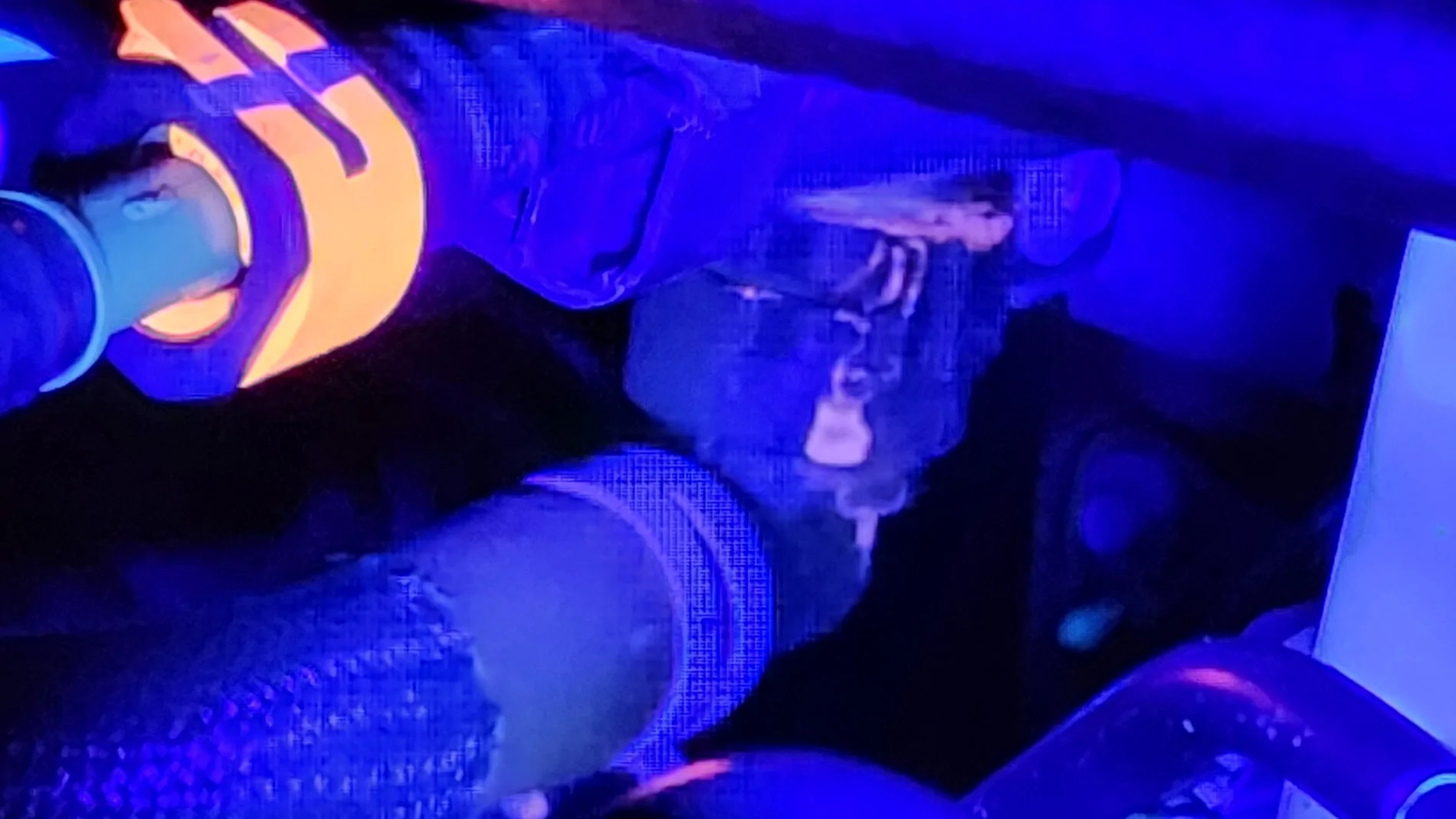

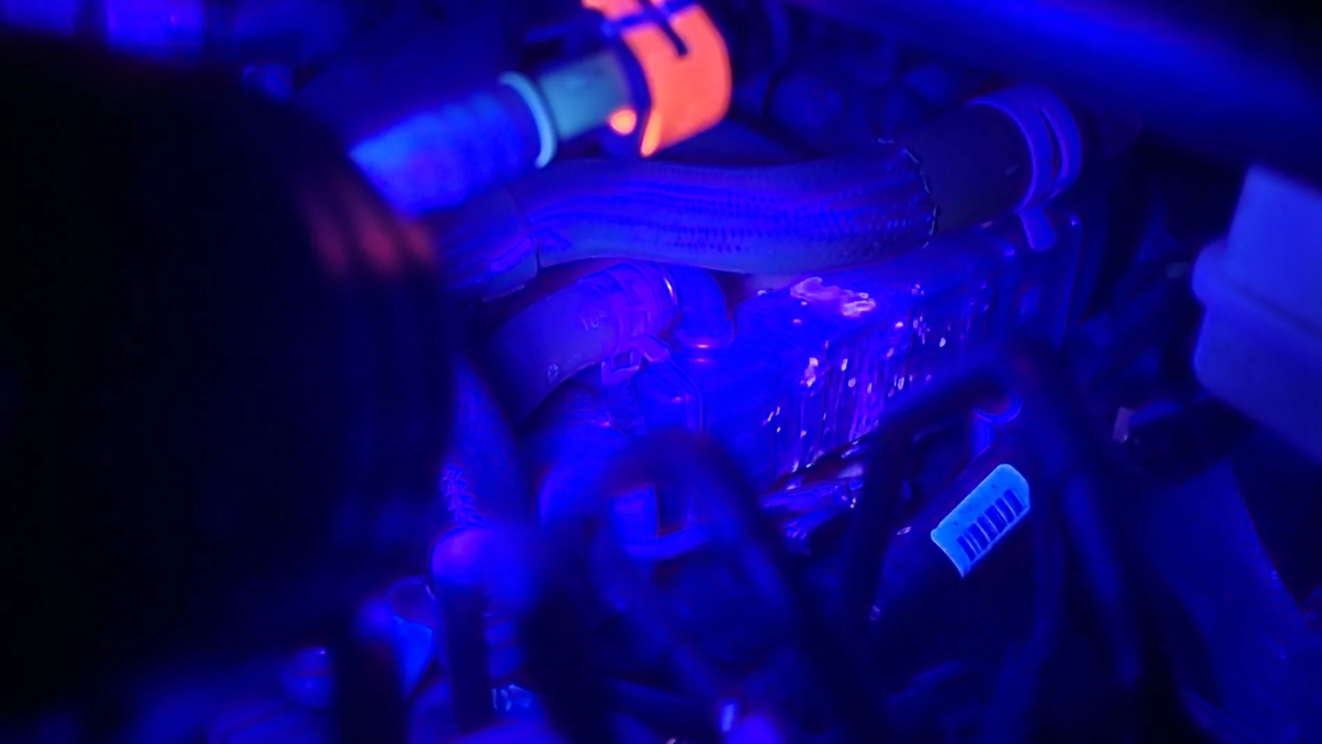

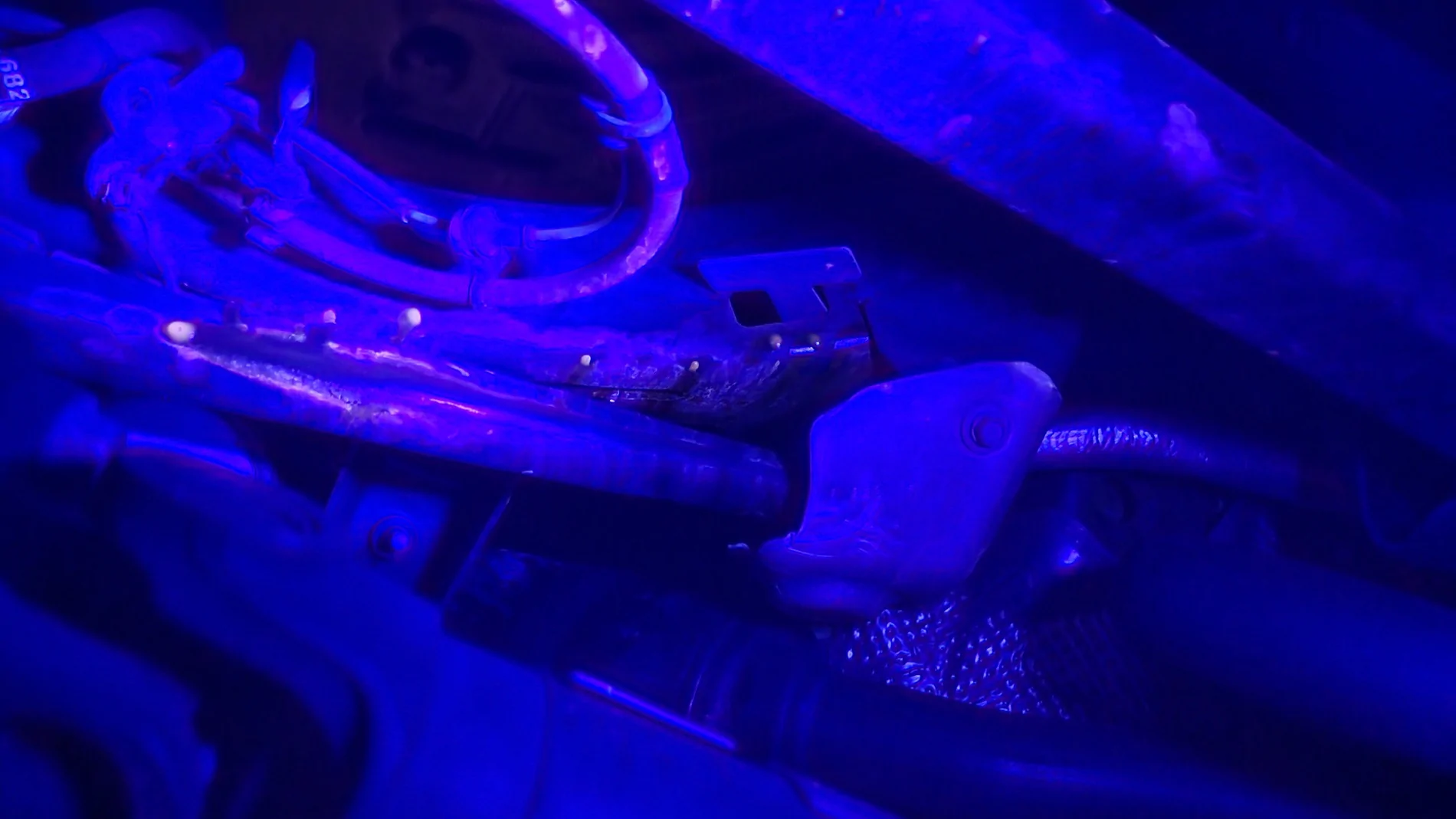

Using a UV light is very effective. I had been losing coolant and smelling it ocassionally. I had a bad head gasket that was replaced under warranty, and I was hoping it wasn't that again. The coolant shows up very bright under a UV light. Looks like I have a leak under the reservoir that dripped onto the EGR cooler as well as control arms and brake lines underneath.
Under the reservoir.

EGR cooler.

Underneath (driver side control arms and brake line).
