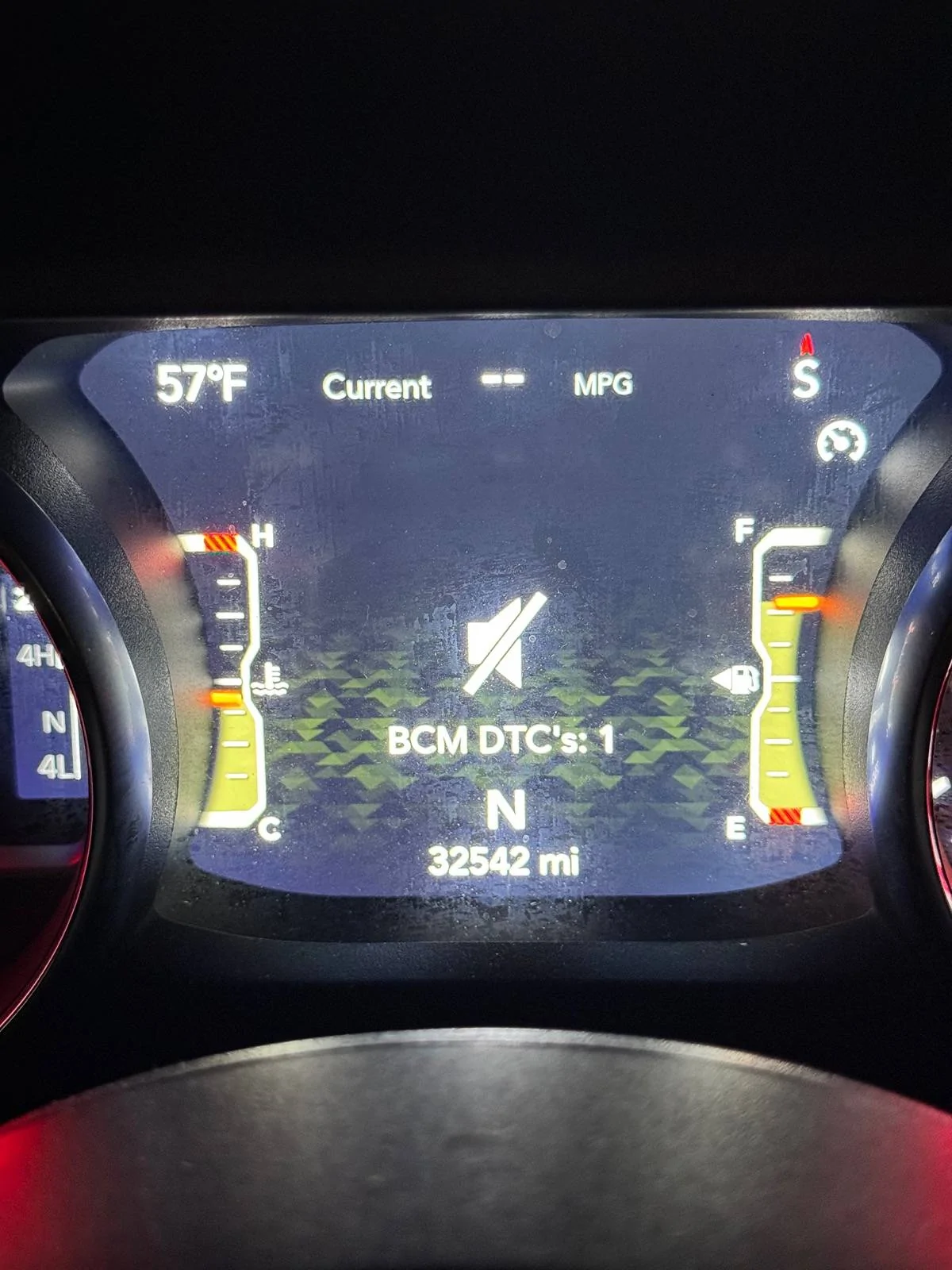

I forgot about the tazer, so I checked it this morning and this was the only thing on there. The only time I use full throttle would be to merge onto a highway, this truck is definitely not a race car lol.
Thats a code I've seen a lot with manual transmission JTs and 4XE JLs. Its a error code for the body module. I don't see how its related to your power issue but you should reset your tazer and clear codes to see if that helps.
edit: this can also be caused by low voltage on one of your batteries. It could be misfiring cus its cutting off the alternator possibly at redline and then your battery voltage isn't high enough for spark? @ShadowsPapa thoughts?
Some suggest that's a SGW message - might remove Tazer as a test and see how things go.
Bad connections there can cause issues.
If it is better, then when you go to put it back, just for kicks, leave the truck for 30-40 minutes and do not have the fob with you when you put tazer back - just to keep sleeping systems sleeping.
I'm over-doing it there, but if it's related to SGW like some say............
The problem is, some codes are not as easy to nail down as others as some are standard across most if not all makes, some are specific to vehicles, like FCA vehicles.
Some automakers have codes they use only for their own issues and you can't assume the internet is right.
