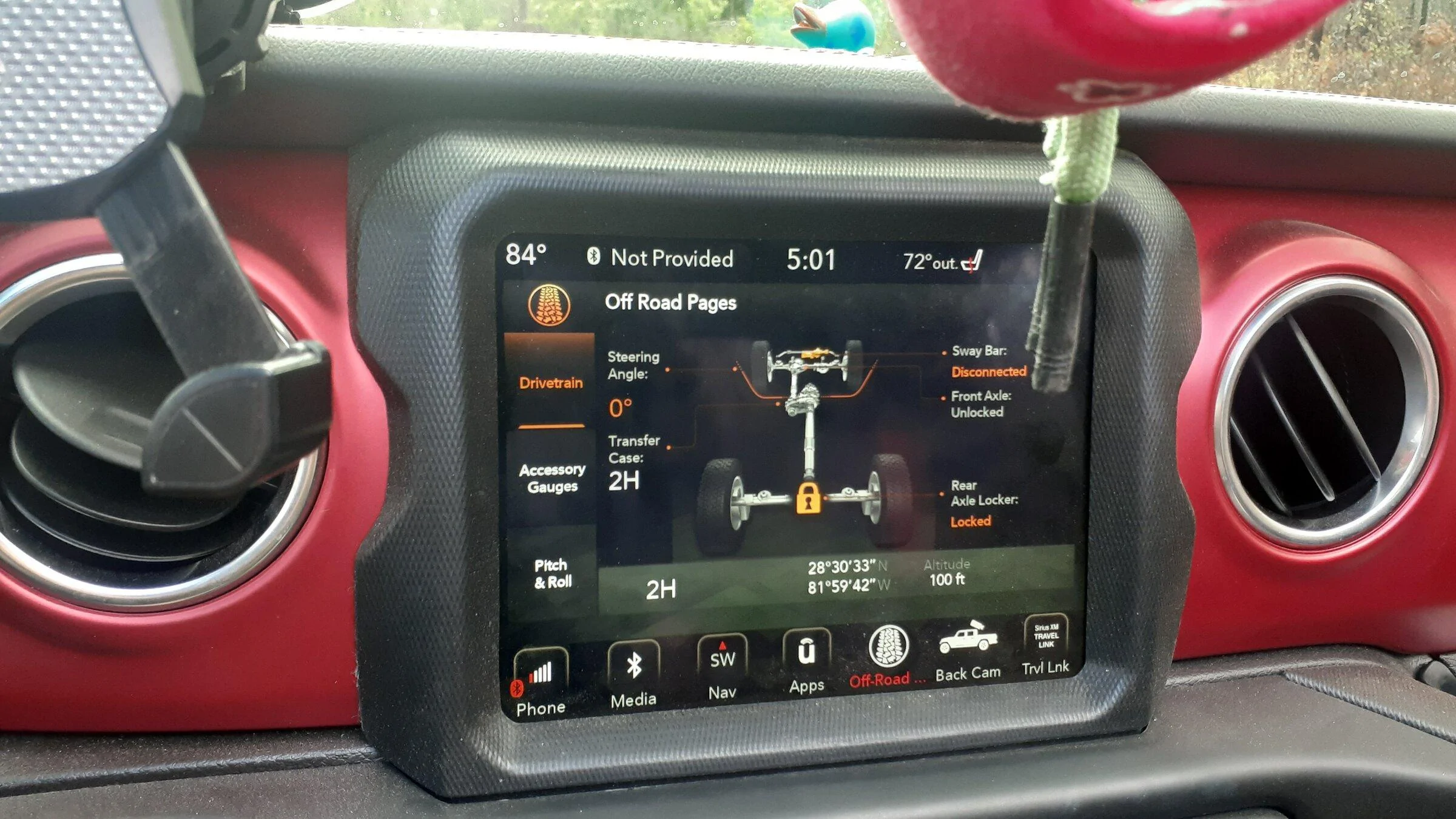

Unless you use a work around , the rubi can't be locked in 2wd
Jeep Gladiator LSD Equipped Gladiators Better Than Rubicon in Snow ? 20220325_170143
And the work around is the Tazer.
Don't need a Tazer to lock the rear in 4H.
This happened for the first time today with a Tazer. I've tried to do it before w no success. Unless someone else can replicate I think it just stayed stuck when coming out of 4H.

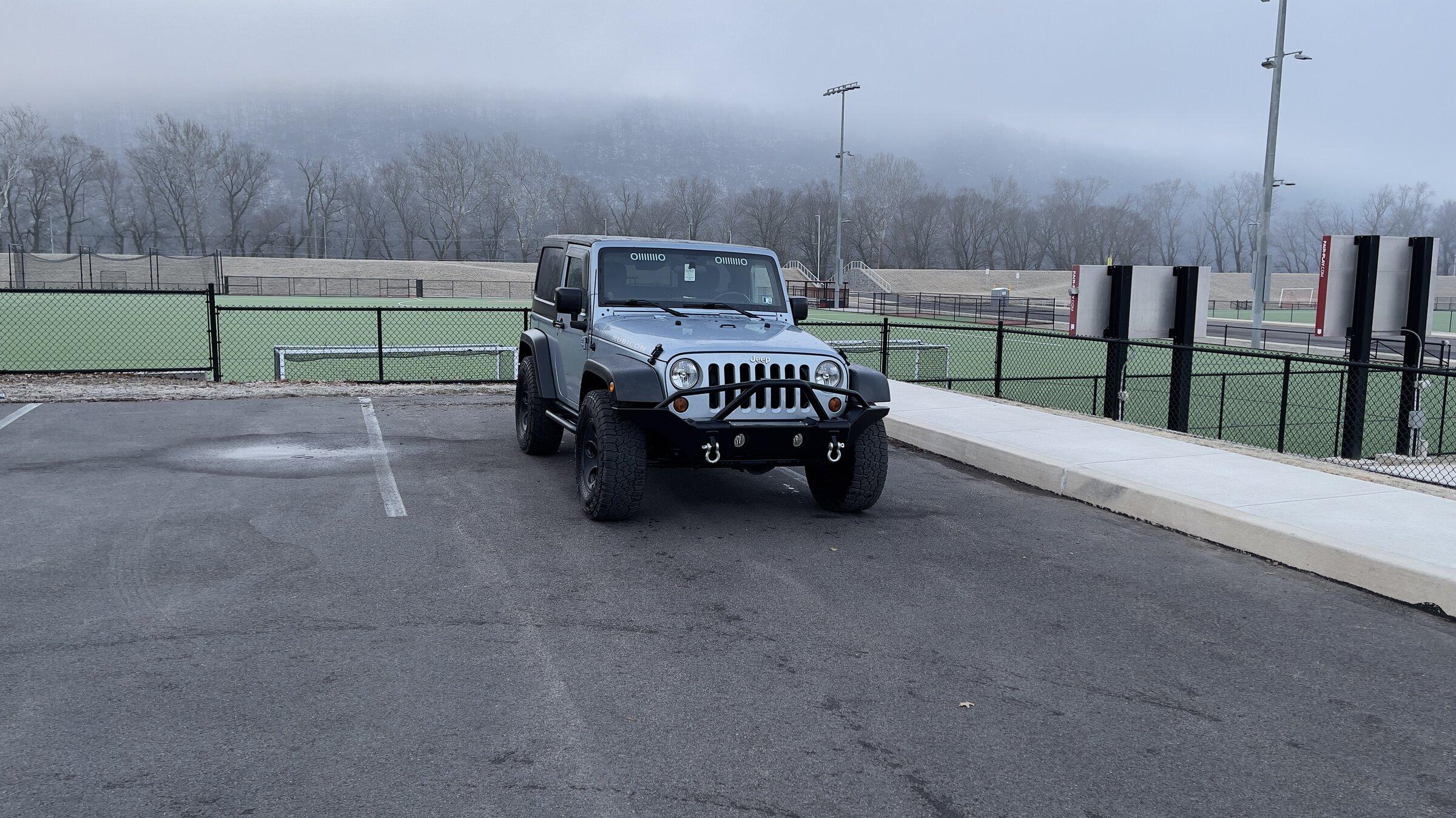

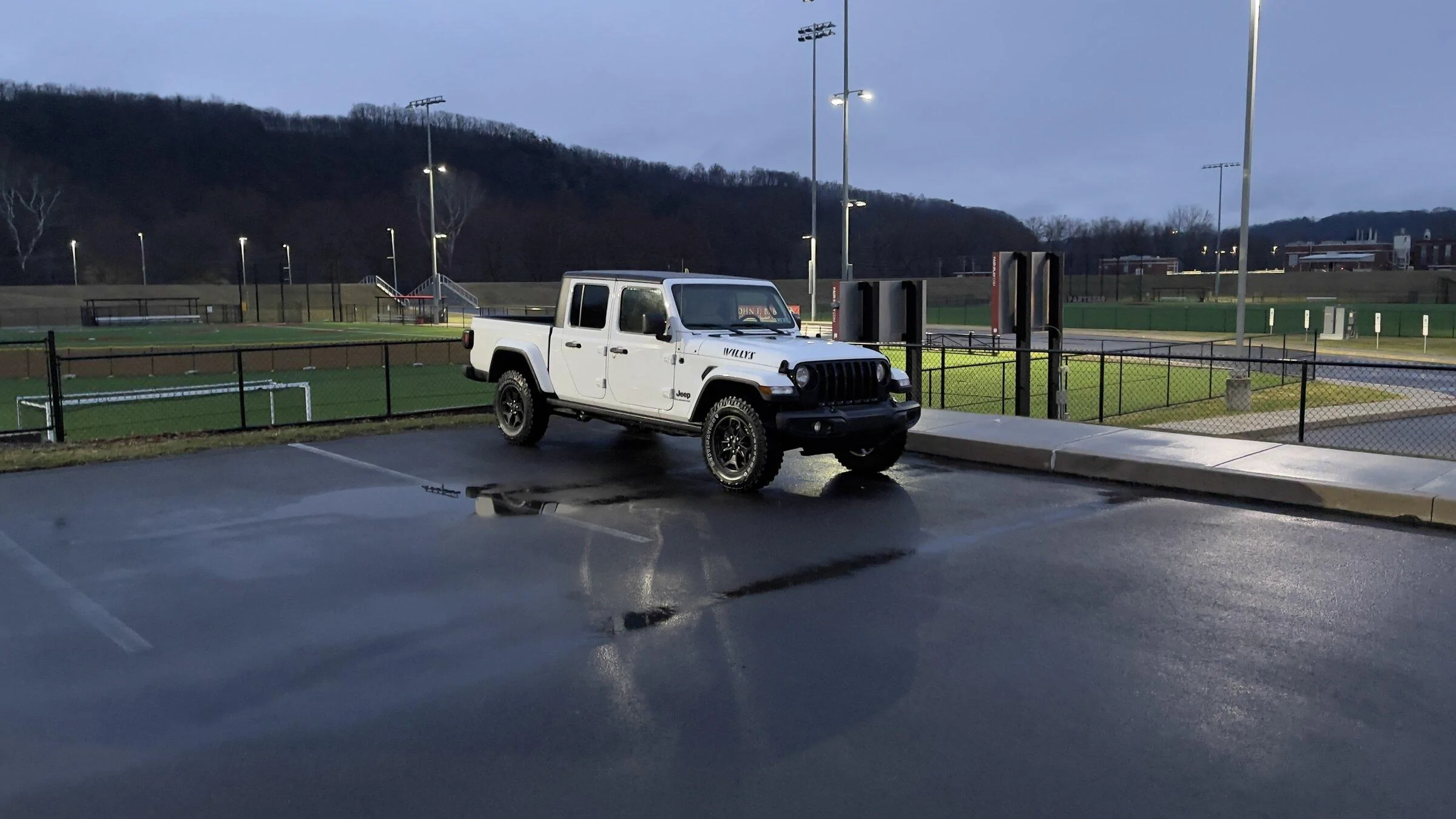

My 12 JKR was less than stellar in 2WD, always spinning one side coming up my driveway in any kind of snow (had to use 4WD).
My wife’s 12 JKU (sport) had LSD and she generally didn’t need 4WD in the same conditions.
I still loved my Rubicon, but “unfortunately” I had to give it up for my JT Willys (with LSD), which I just brought home on Wednesday!!!
