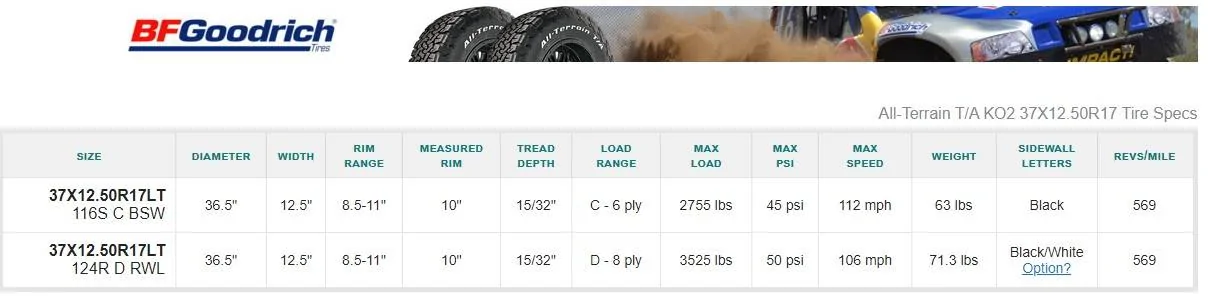

PS: if you set the tire size as low as you can with a Tazer/JScan etc (30" ??) your speedo will be off by about 17% (based on the 35.6" actual size of the hopefully 116S rated KO2 you have mounted)
This means when you hit 155kph you will actually be going about 181kph. As others mentioned, monitor actual speed with GPS for whatever testing youre doing
