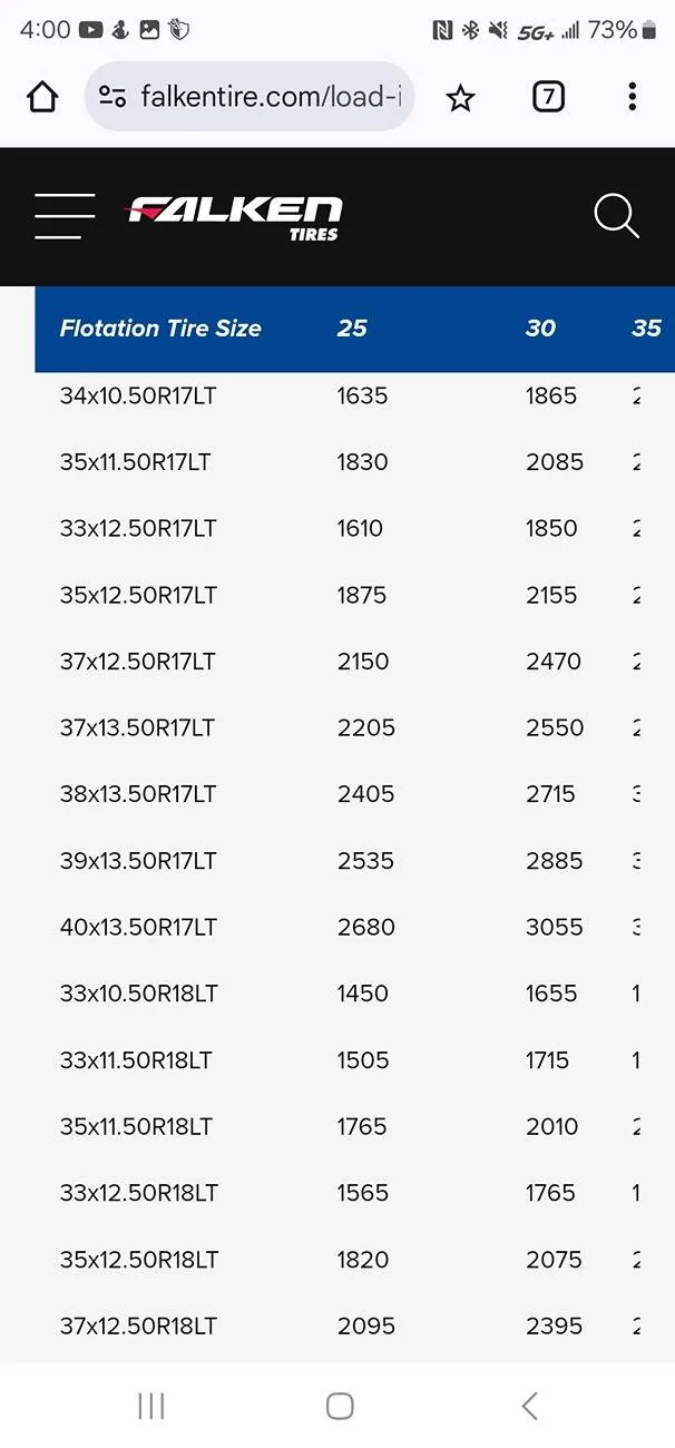

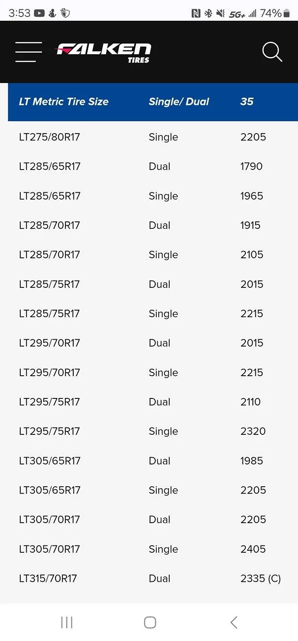

Where are you getting your "tire makers settings"? Did a quick search of falken and for any size tire they sell a per tire load of 2klbs or less doesn't require more than 35psi period. Furthermore if you look at the next column increasing psi by 5 to 40psi increases load carrying capacity by 90 pounds. Logic tells me that decreasing 5 pounds should equate to 90lbs less capacity. That tells me 30psi is plenty of load carrying capacity for my 5600lb gladiator.
Jeep Gladiator Maybe Stupid Inflation Question ... Screenshot_20241111_155318_Chrom
Edit, I scrolled down to the "floatation" tire sizes and 37x12.50r17 are rated for 2150lbs at 25psi. I guess the manufacturer agrees with us "some guy on the internet" types that have been trying to tell people to quit running high psi and complaining about poor handling and rough ride for decades? Looks like for a 33" on a gladiator you should probably run 30psi and 35-37's you're better off closer to 25psi, per the tire maker of course.

I agree to a point, but when we go to a much larger tire that kinda goes out the window. I still can't believe our JLUR with XR came from the dealer at 40 psi. I get good wear and even tread footprint on the 37s at 25psi cold. They are so large they get up to 28-29psi on a long road trip when they get warm. Of course that's a huge E rated mt so it's a far cry from a stock or stockish sized tire. It still cracks me up every time I see a tfl video and they are airing down for a trail... to 25psi.
