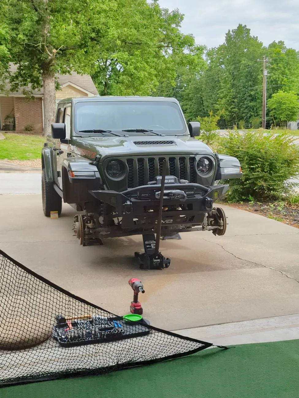

I'm currently in the market for a kit to lift my 23' Mojave! Trying to decide between the MC 2.5" and 3.5" GC. I currently have DV8 bumper, DV8 skid plate, & 12k winch up front and DV8 bumper in the rear. Gonna be installing the OpenRoad bed cap in a few weeks to house basic camping gear as well (estimate around 250-300 lbs in the bed max w/ bed cap). Me and the family use this rig mostly for round town errands and local weekend getaways. We do plan on doing some long overland type trips in the near future as well (highway trips to moab, grand canyon, etc). I plan on running 35's on stock wheels (will probably add spacers for needed backspacing). Most of the trails we run around the house in North West Arkansas/ Missouri are pretty mild in the Ozarks but would like something that gives us a good ride both on and off-road. I think the 2.5" GC is probably the best choice for what I'm looking to do but wanted to get some advice from others with more experience on this matter. I know a lot of people think the 35's look small but I prefer a little fender gap look personally....not a fan of the "stuffed" look that's why I was considering the 3.5" GC. Will be choosing the option to retain factory Mojave fox shocks and replace them when the time comes in the future. Any thoughts, pictures, or real world experience is greatly appreciated....thanks in advance!

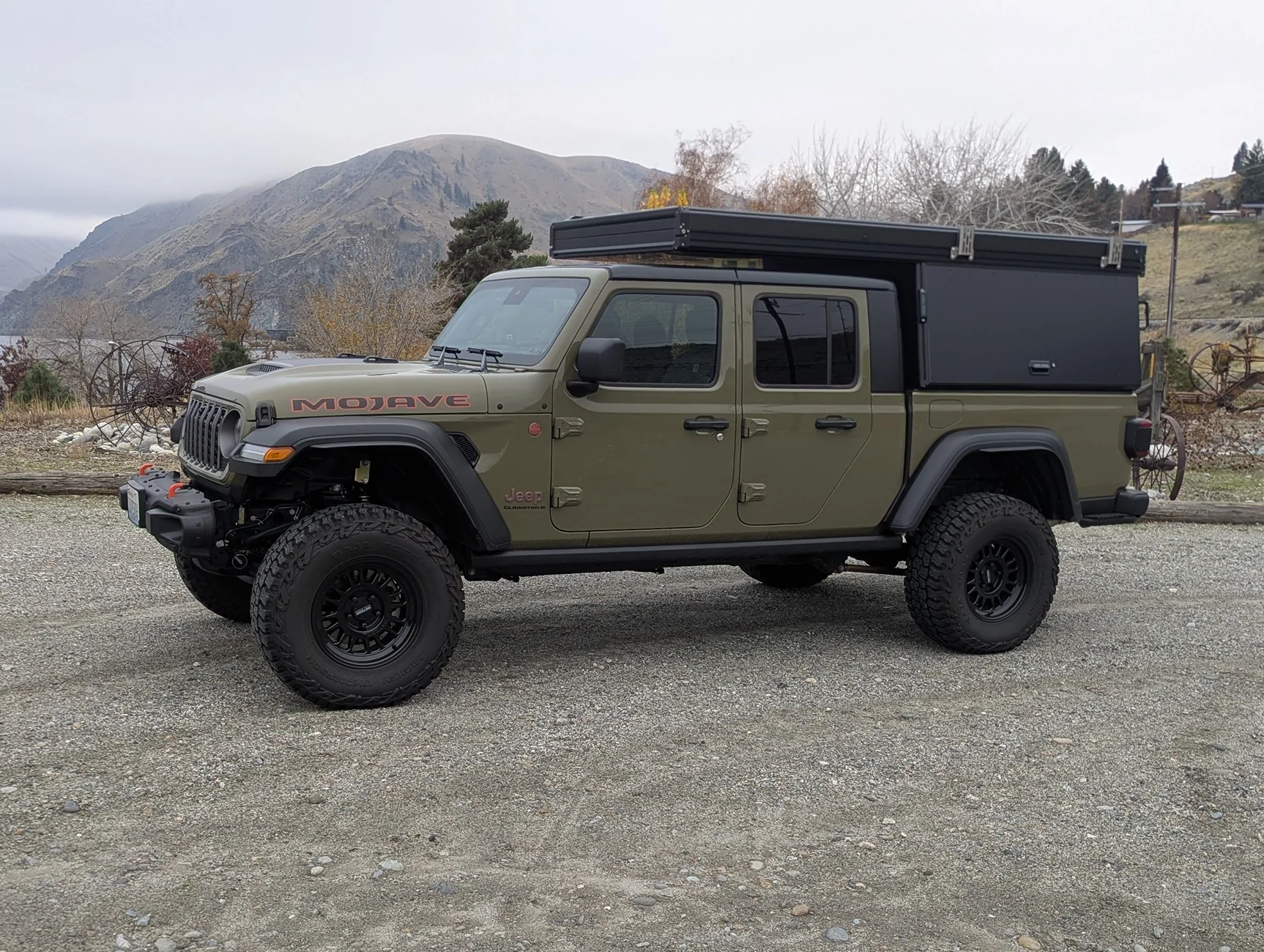

Driver
Looks like some gold on that shock mount! You go with the Metalcloak? If so how's the ride with the MC lift and factory shocks?
Yes it's Metalcloak. The ride was great before adding the camper. I would say it's good now. Someday I will change to the correct length adjustable shocks.

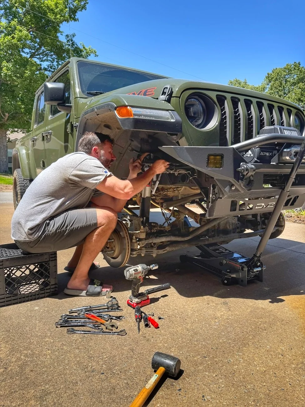

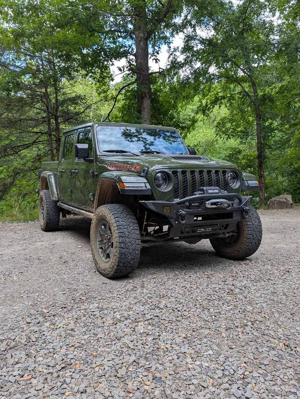

Ok so I decided on the @Metalcloak 2.5" game changer and couldn't be happier! I opted to stick with the factory fox shocks and used the metalcloak shock extension to do so! Lift took me about 2 days to install in my driveway (with lots of breaks for chores and dad duties...lol).
