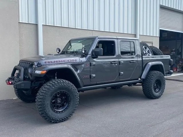

Gotcha. Here is what it looks like with -18 on a Rubicon axle. Sticks out about 3".

looks awesome. I would love that look. now just need to figure out how to get it without the rubing. it looks like maybe 4in of backspacing is where I would have to be to not rub since I don't have the rubi axles. Black rhino need to make more backspacing options :(

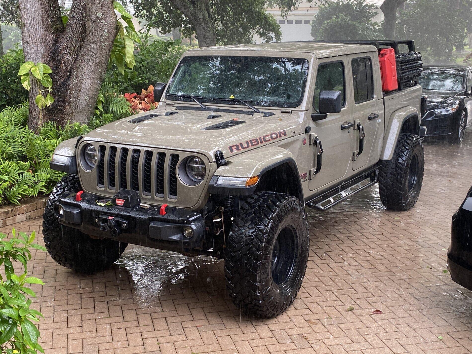

Just installed the Game Changer 3.5 this weekend with additional daystar 3/4” rear spacer to keep some rake. Tires are Bfg A/T 37/12.5/17 for reference. Rides great so far.
Still needs an alignment. Should this be done at a 4x4 shop or can Firestone do it?
Jeep Gladiator Metalcloak lift F9501F4A-FF8B-4DF6-92D3-E2978975B910
I I know the specs will have changed from factory but can’t find what they should be in any Metalcloak docs.

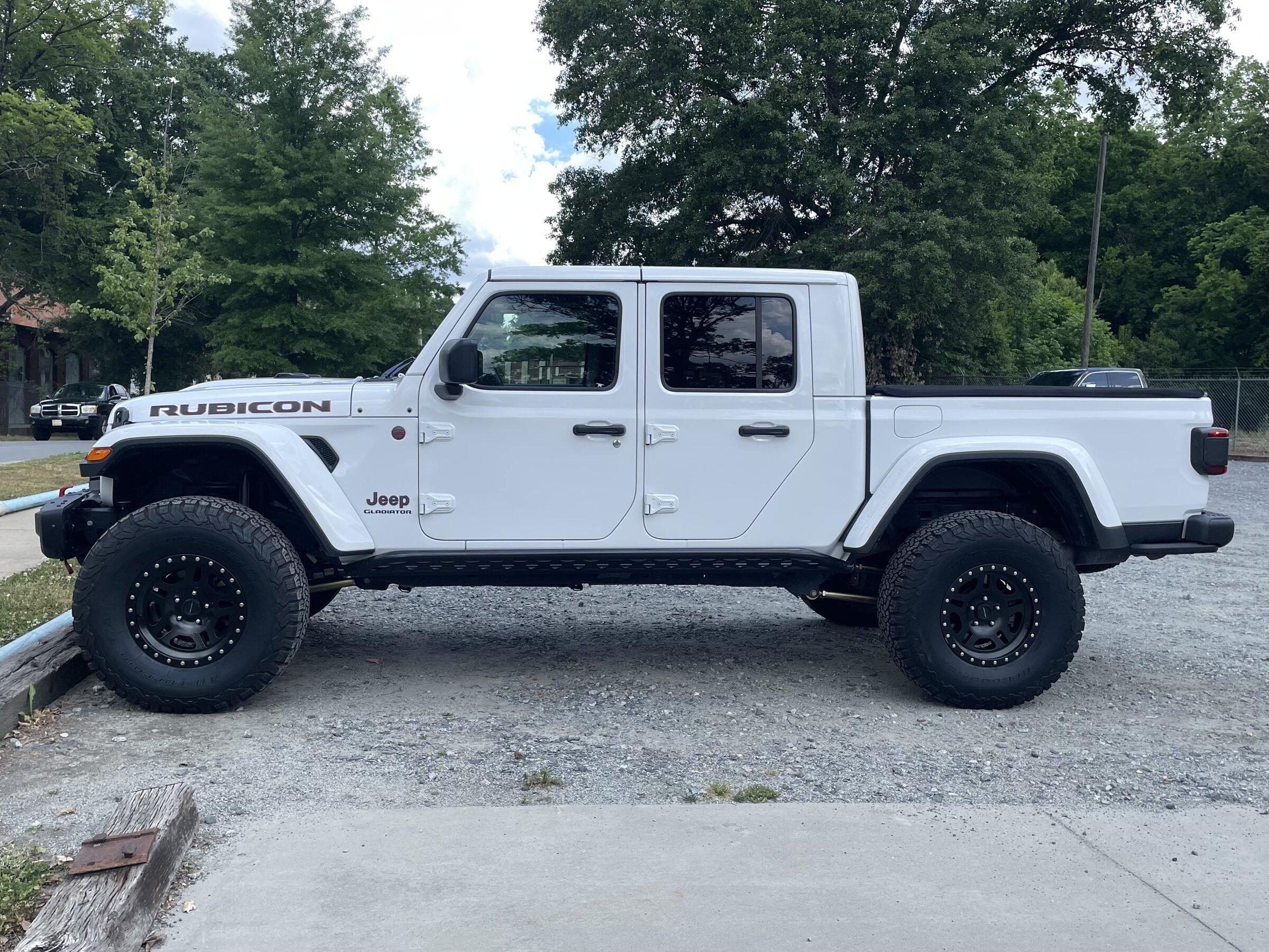

finally bit the bullet and went Metalcloak 3.5 Game Changer w/FOx 2.0s. Black Rhino Kelso wheel sand 37" Mickey Thompson Baja Boss MT tires. Love it! I am adding the MetalCloak draglink/tie rod combo with Synergy Sector Brace this weekend to round it all out.
Jeep Gladiator Metalcloak lift j
