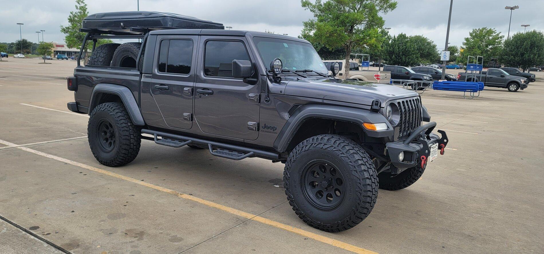

Mine sat perfectly level before adding the rack, tent and awning. Picture is on 37s with 5 35s in the back and rack and ten....

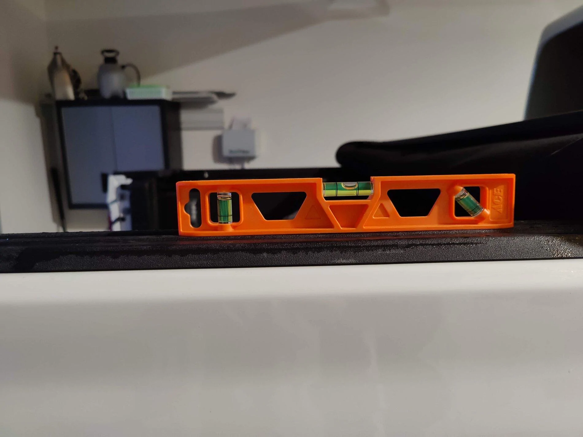

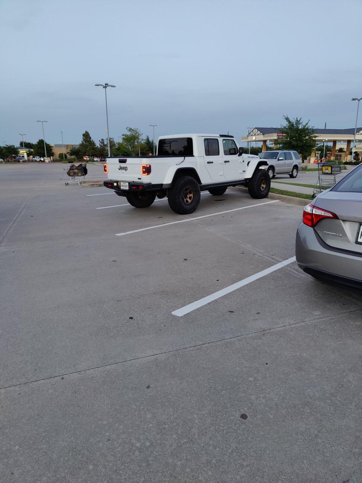

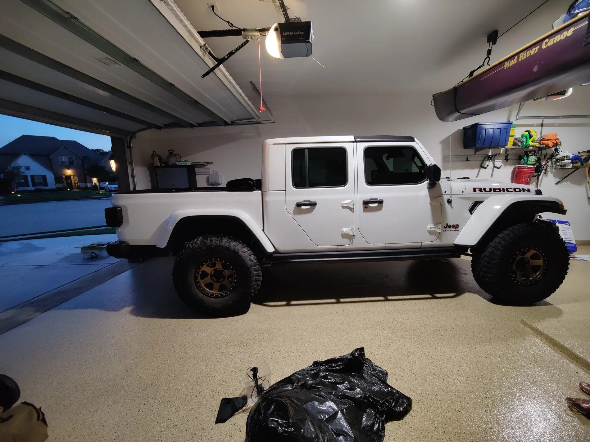

@CanadianJT as you wanted. JT Rubicon with a MetalCloak lift. The only thing with any substantial weight in the bed is a 39x13.5R17 KM3 spare, pushed all the way to the front of the bed.
It does sag slightly the tire in the bed, its likely more noticeable with the Rubicon front fenders being higher than the rear. I've always felt like the progressive coils might be too soft in the first phase.
Here is a photo I took tonight in its natural habitat -- The grocery store.

Side view.
Jeep Gladiator Metalcloak lift IMG_20210718_203706
Bubble level, you can see with the spare tire, it does sag a bit.
