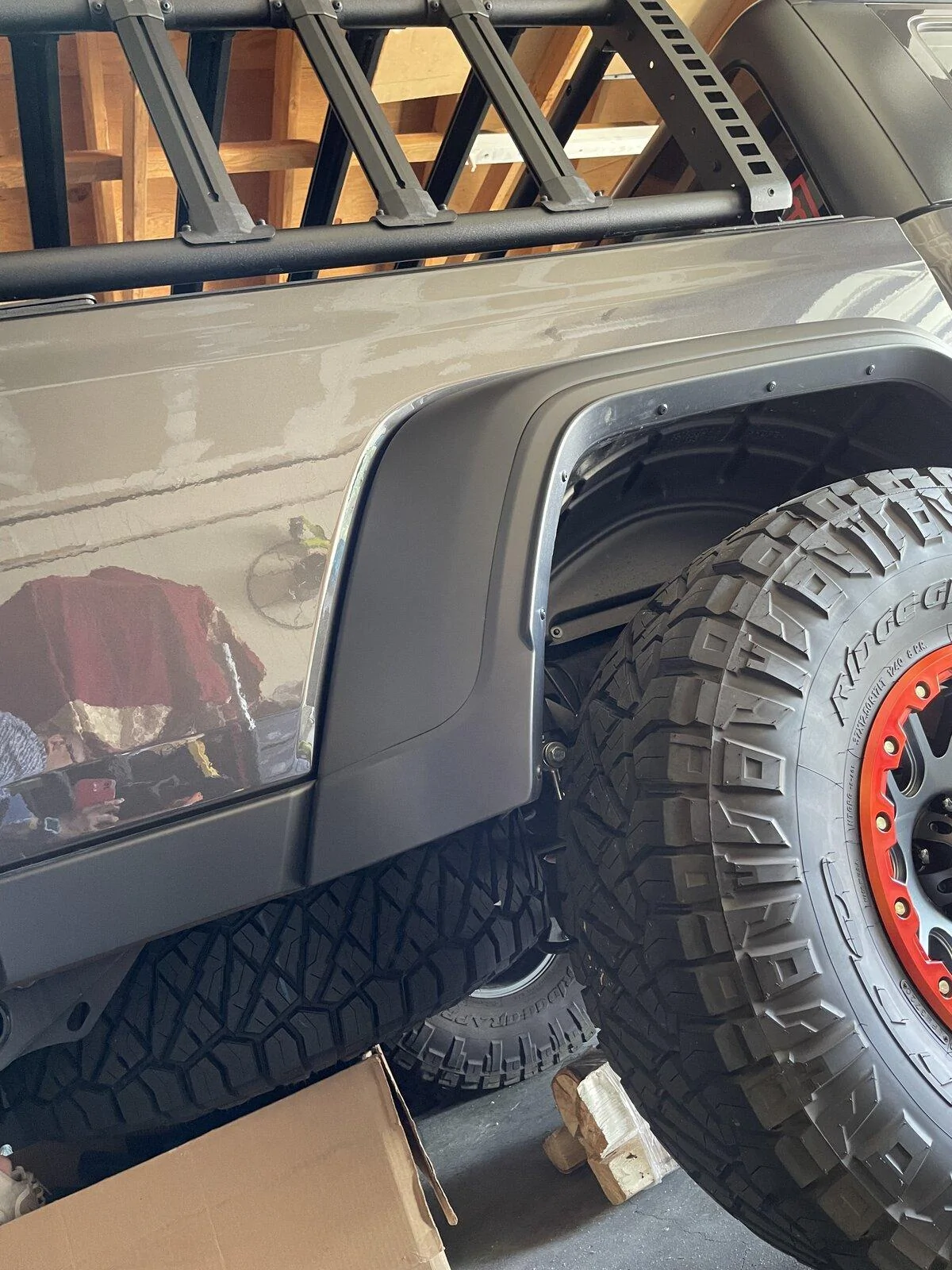

I'm pretty sure it's covered already but anyone running Nitto RG 37" spare at the spare location with their Dual rate or GC lift? Does the MC rear trackbar have any interference aired up? I'm planning on a trip next month and will finally purchase the spare.

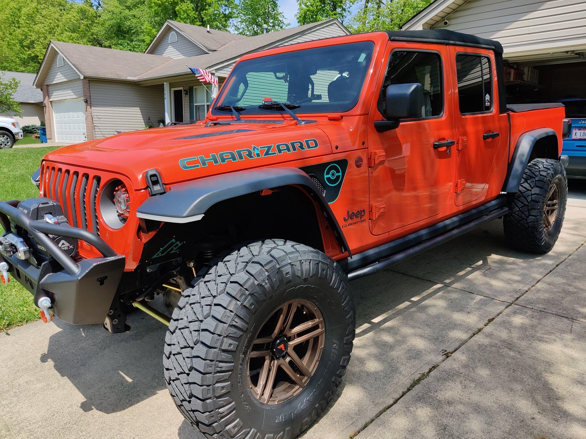

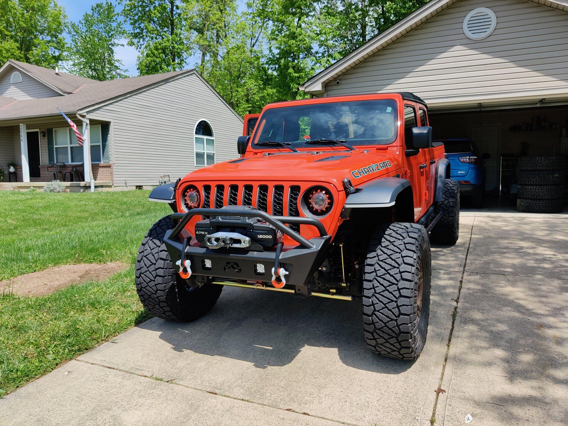

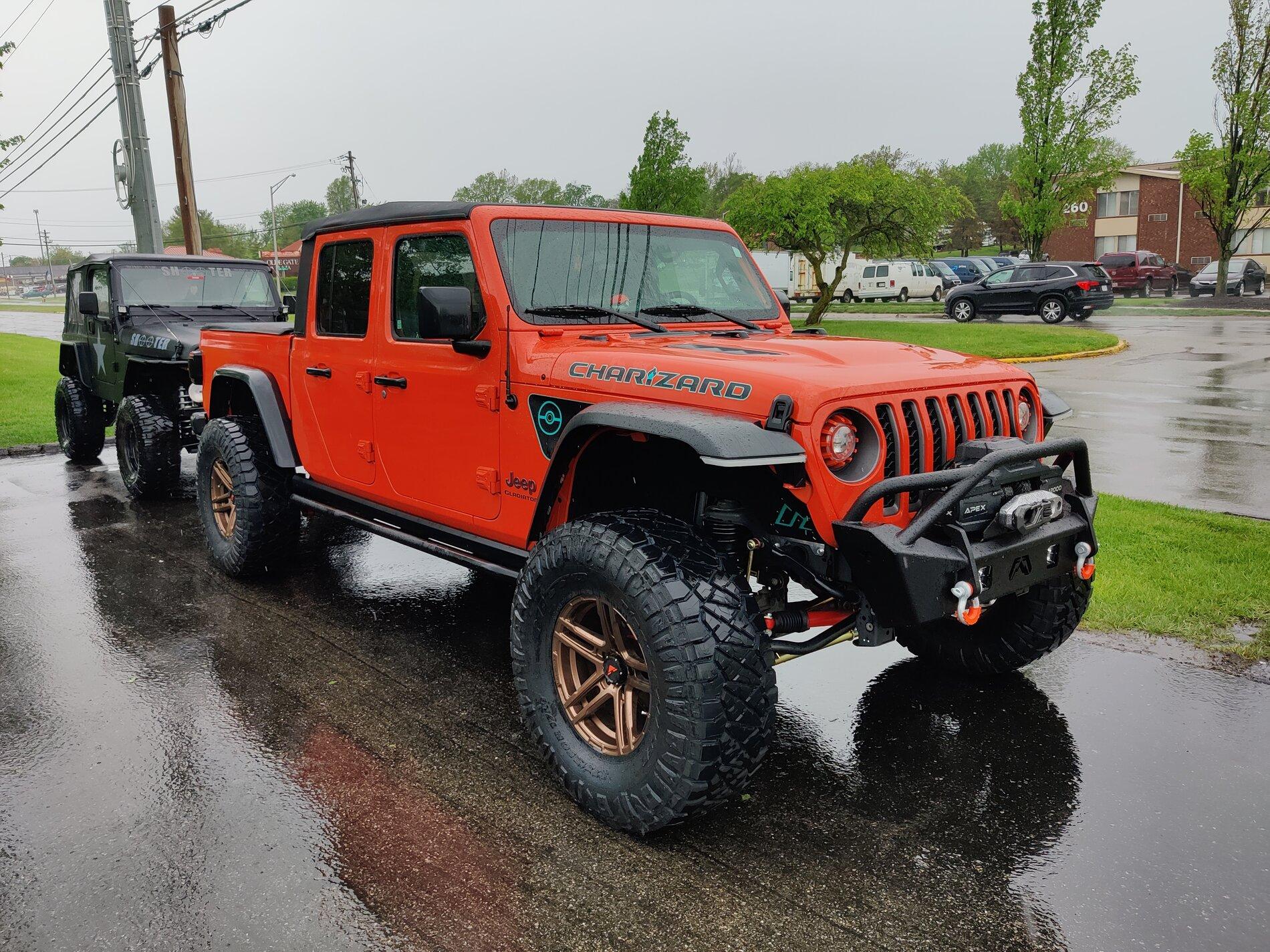

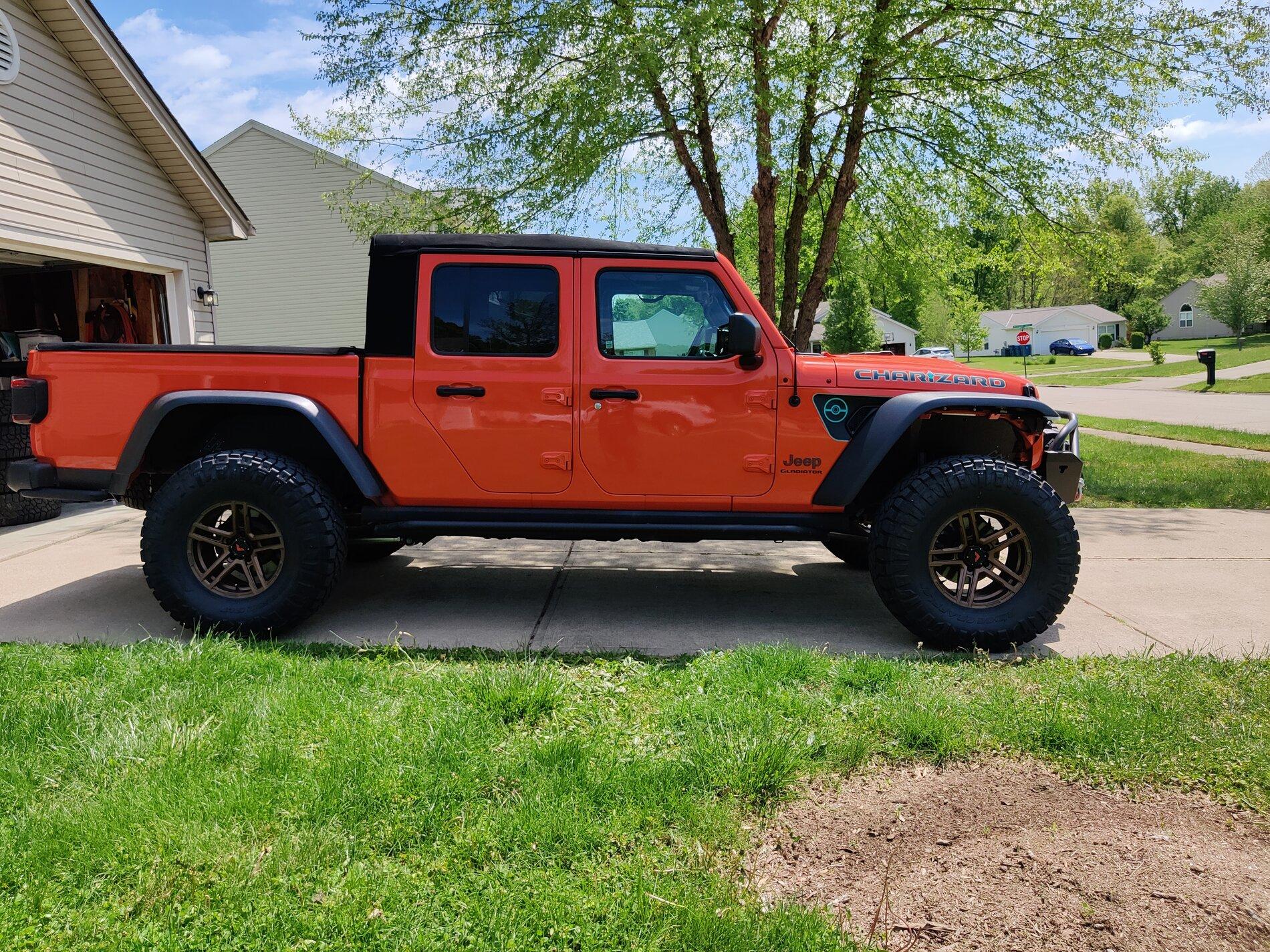

Finally got my Gladiator Cloaked! Metalcloak Gamechanger with RockSport shocks. 37 inch Ridge Grapplers.
NItto 37 TGs. Full size spare. 3.5" MC GC. The tire rubs on the track bar. It's not real bad so I have just left it alone. I have considered getting the Clayton track bar that is designed for larger spares. Looks like a good solution.

@Rummie I did install my tire 2 weeks ago and it did touch the TB. Iā€™m pretty sure after several months, metal will be exposed. I plan to wrap it with clear film. Other than that, no issues besides the slanted appearance which doesnā€™t bother me since itā€™s just a spare.
