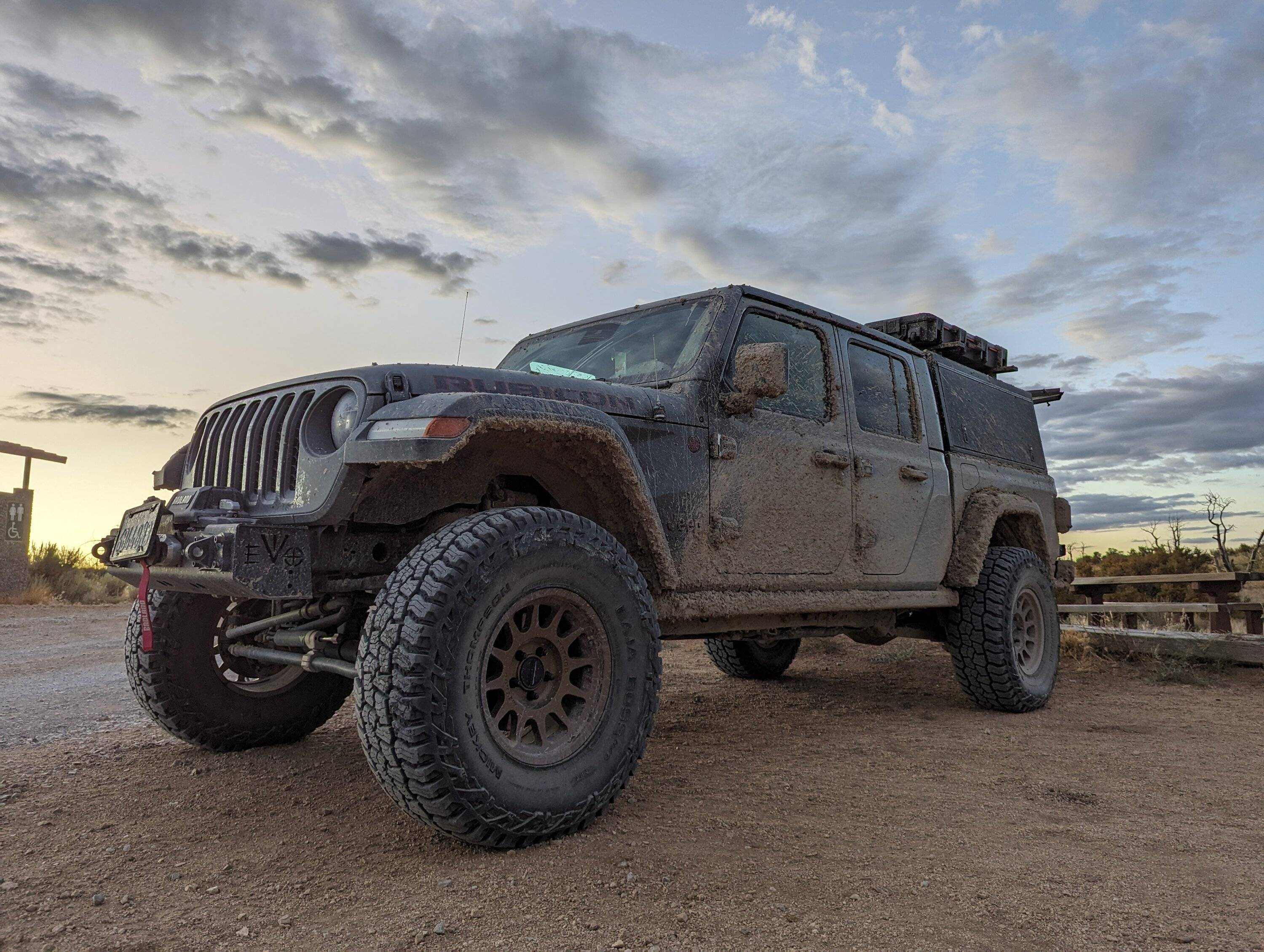

Jeep Gladiator Metalcloak gamechanger lift on 35s JTRD PXL_20230815_024738486
