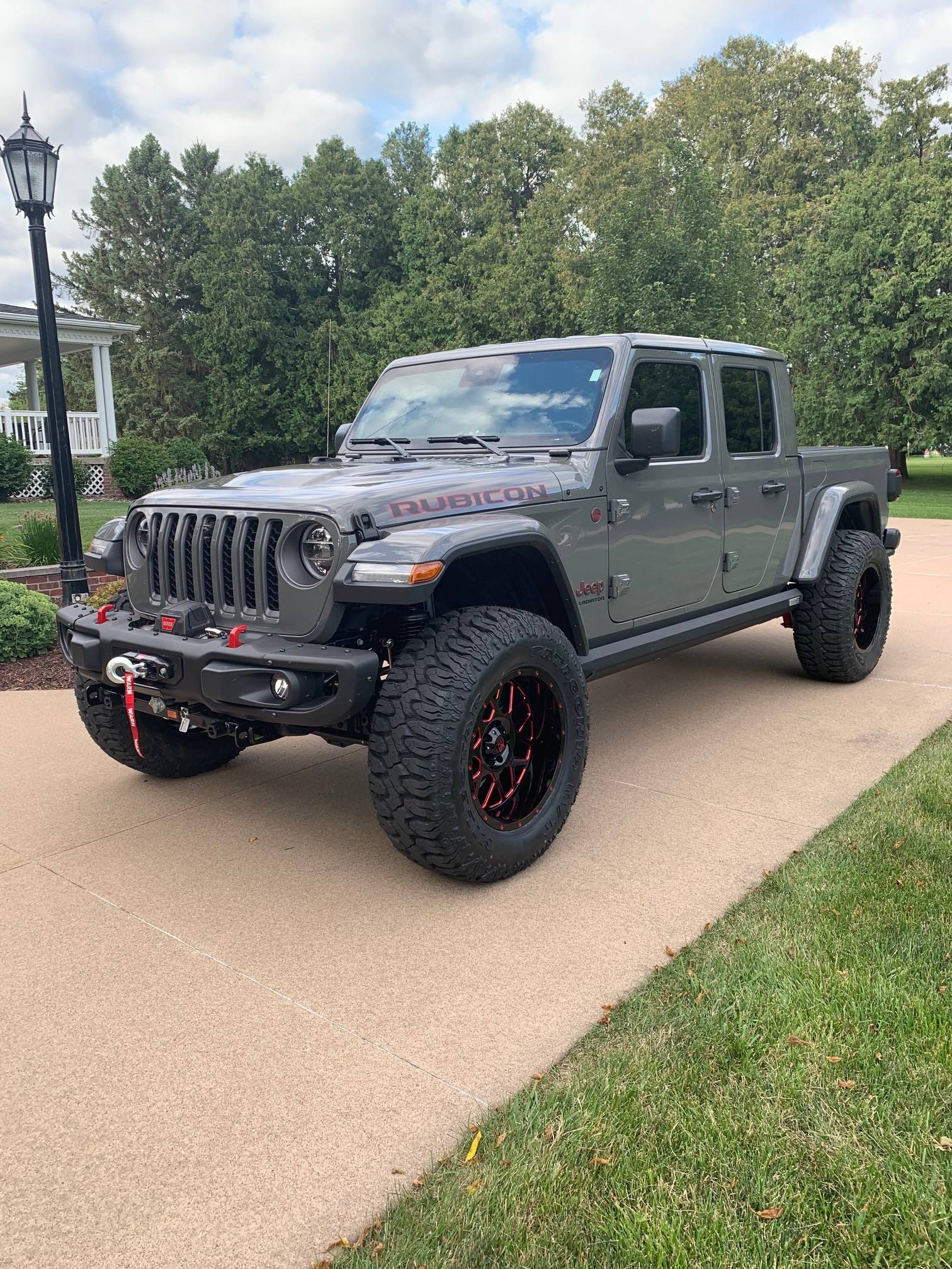

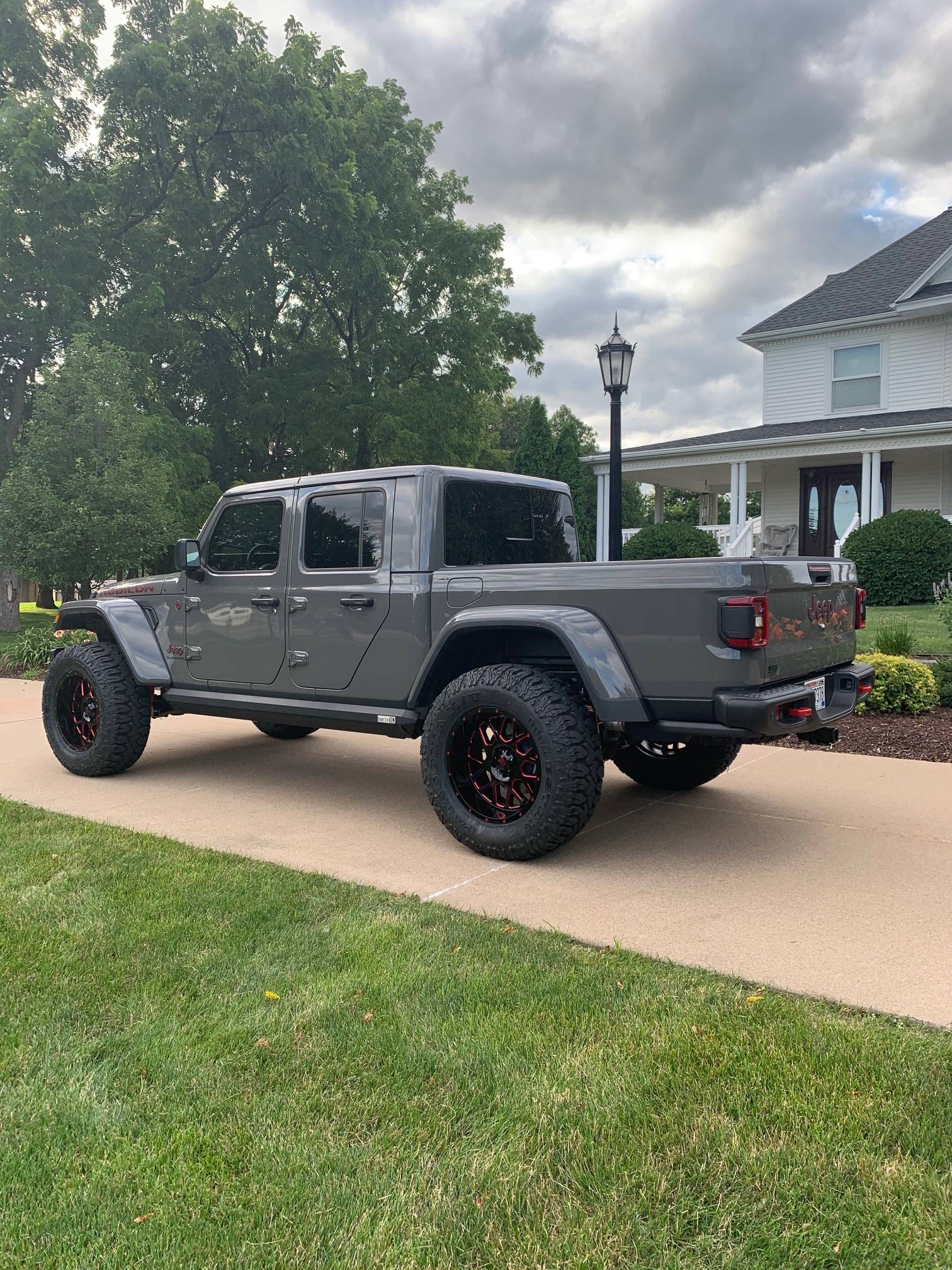

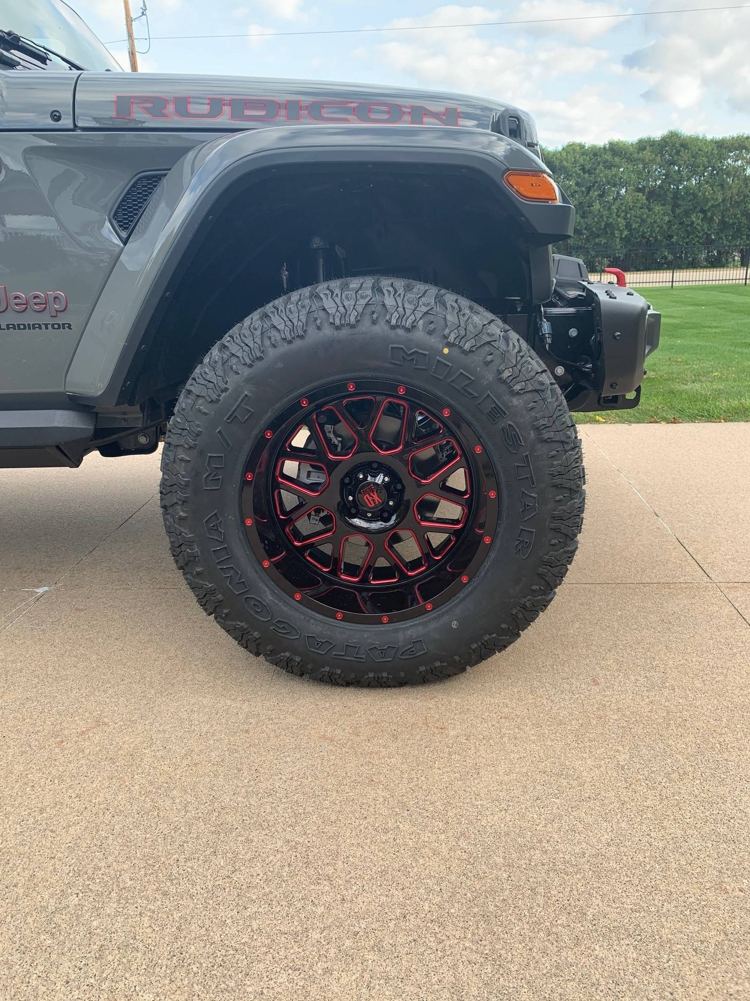

If you have a rubicon/Mojave get the 2.5 any other trim get the 3.5. Either lift on any trim you won't have any issues with clearance. It's just if you get a 3.5" lift on a rubicon/Mojave with 35s you will have a big gap gap between the tire and fender.
Here is my build:
- 3.5 Metalcloak GC
- King Shocks with Adjusters
I decided to roll with the 35s since I don't want to regear (yet) and change out balljoints with 37s. I also Tazered the Mojave so it drives and shifts smoothly.
To compare, here is the same 3.5" Metalcloak Game Changer setup with 37's. If there is no interest in 37's in the future, I personally like the look of the 2.5" setup. Nonetheless, whatever you do will look good.

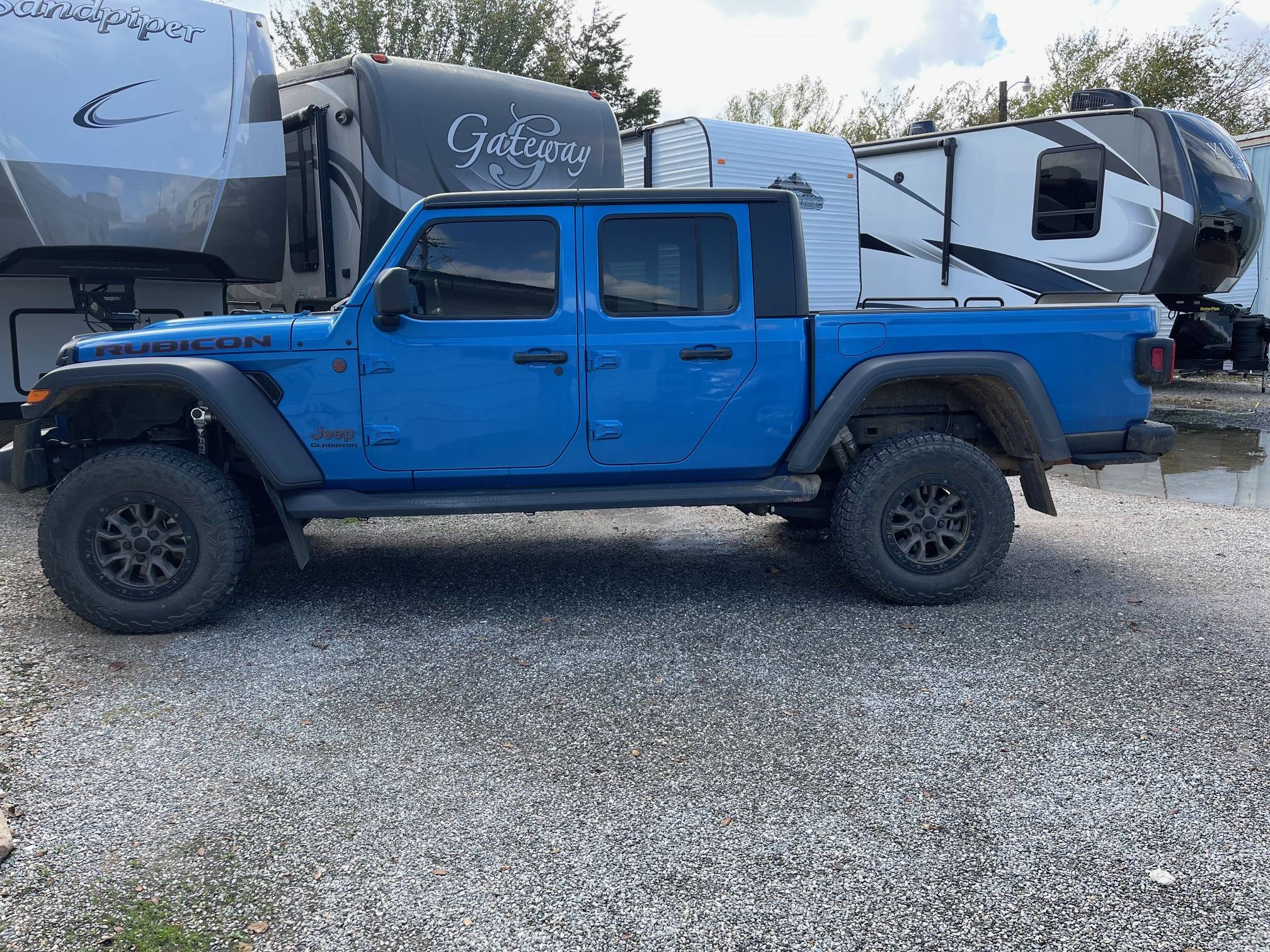

I put a 2.5 Clayton Overland Plus lift on my 3.6 Rubicon a couple of weeks ago and love how it rides and handles on the rough dirt roads and on the highway. I measured again this morning and I’m sitting just short of 3 1/2” taller now than stock. My decision went back and forth for a few weeks between Metalcloak and Clayton. I went with Clayton only because Metalcloak recommends replacing the front driveshaft. This was the first lift I’ve ever installed and I did it with a floor jack and jack stands in my driveway almost without trouble. The only issue is that one of the oem spring isolators popped off the new larger Clayton spring while I was stuffing it in and rather than start over with that spring, I was tired at that point, so I left it off. It now squeaks badly but it will be an easy fix as soon as the new properly sized isolators get here.
It now drives and rides so much better than stock. I haven’t had it far enough off road yet to give it a review, but I expect it to be great there also. I’ll add a picture with the stock Falken 285/70R17s. As you can see the JT looks are off with these tires but I’m still below 25k on them and then I’ll replace with 35s.

Correct, Metalcloak requires swapping the front driveline because of the amount of free length/droop that the front axle will have.

Clayton actually also recommends a front driveshaft also if you plan to go offroad. At least for the 3.5 lift.

You may be correct but my understanding is that it depends on the extended length of your front shocks. I ordered my shocks over the phone with Clayton and was told the factory shaft will work with my 2.5 lift and shocks. I've dealt more with Metalcloak than Clayton but they both have excellent customer service reps and they both make great products. I wouldn't be worried about buying from either.
