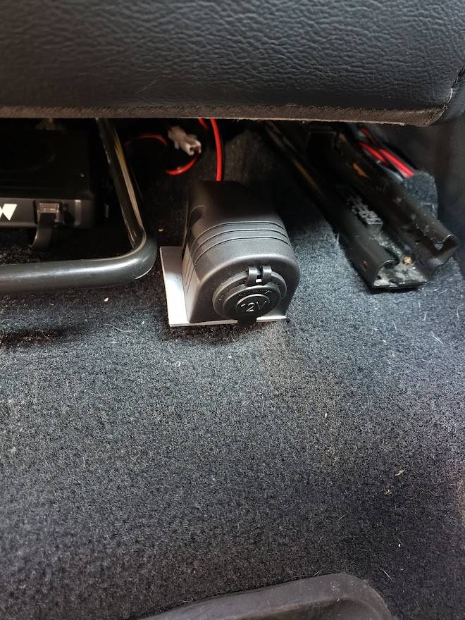

I used the quadratec extension on mine. After removing my 12v acc socket from the dash, I ended up needing a 12v socket, so i used the extension to get power to the 12v socket and GMRS that I mounted under the front passenger seat. Works great

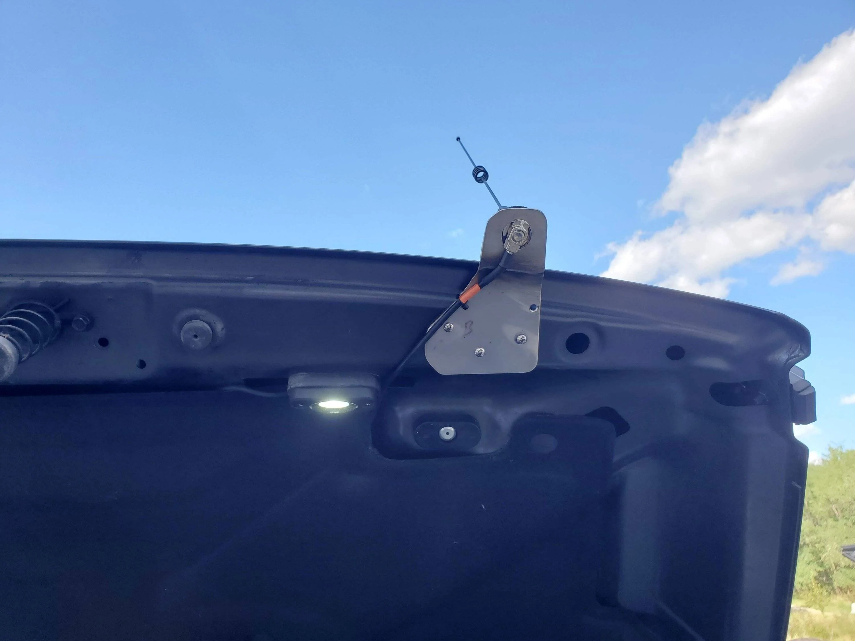

There really are no good mounting options with regard to ground planes, unless you want to cut a hole in the middle of your hood..
So I decided since I didn't feel like cutting a hole in my hood I liked the Australian esthetic of mounting the antennas up front near the bumper with a bracket I fabricated.
It also gets the antenna away from me and the cab.
So far it has worked well for me. Driving across country to UT I didn't really have any issues picking up the weather broadcasts, and I had no issues talking with my buddy in his truck several miles away (on a relatively flat road) and he was using a Baofeng handheld.
For some reason I only have a picture of the bracket with the hood up, but you get the idea I think..

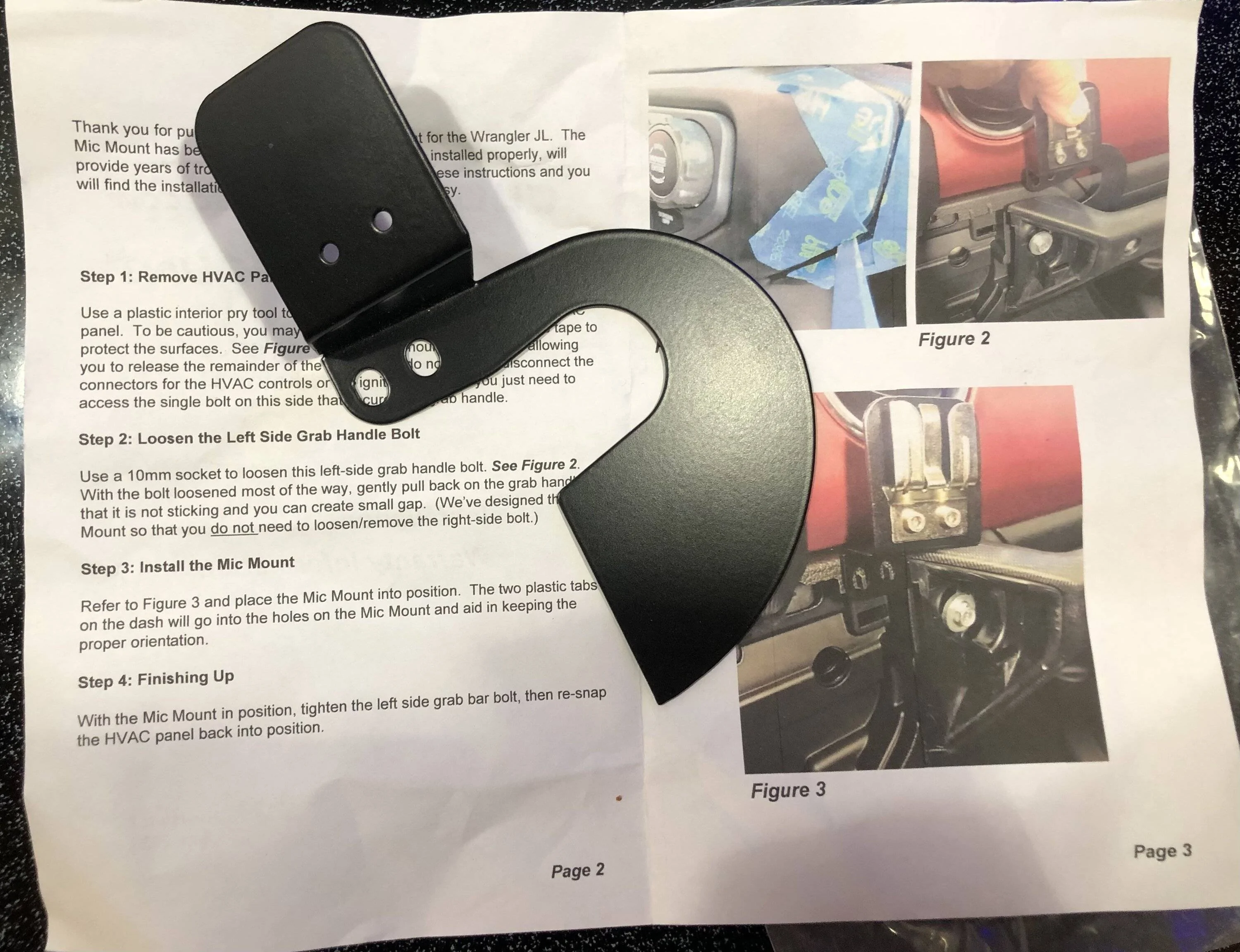

Question for folks that bought the Cool Tech kit…did your kit include the microphone holder clip?
Edit: Gotta read way down in the fine print “(Note: The chrome mic bracket is not pat of our kit but will come with your CB Radio.)”
