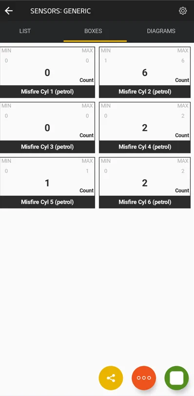

Since I've been driving the 2020 more this week, the ESS started working fine again. It charged the batteries to above 12.44.
In fact, it was extremely well-behaved this week, the dealer was happy to get it and is already going through to sell it as a Jeep certified used vehicle.
When these are running, what you see on the screen as the voltage is what's there available to all systems. There's no drain on anything. The electronics have that 14 volts or whatever it is at that moment for anything needed.
If the cluster says 13 volts, then there's 13 volts for everything even if the batteries were at only 12.1 when the truck was started.
So I guess what I'm saying is this -
Misfires that are seen as excessive or problematic or beyond the dozen or two dozen every 20 minutes or so will cause ESS to not function. Minor misfires are normal and won't impact ESS operation - they are random, transient, and there's nothing else abnormal going on.
Abnormal misfires can cause ESS to not work.
ESS battery issues won't cause misfires. IF it's running and the charging system is kicking out over 12.x volts, it's got enough to run things.
The PCM will kick other errors if the voltage is too low - you'll know it.
This was mine in 10 minutes - 2 idling, 8 driving minutes, and ESS worked fine.
What's interesting is that the misfires were on

That's the internet scuttle - but not entirely accurate - and there are several TSBs and flashes out there so you'd have to say "which one".
A deep scan may show past misfires that didn't trigger the MIL or set an error. But it seems they often ignore some misfires, too.
I've found that "looking for codes" with software may show nothing but then a "deep scan" or analysis shows issues.
My wife's 2021 GC bucked like a bronc with a burr under the saddle - no light, nothing stored - it was "transient" so you had to do a deep scan to find the codes, non-permanent. A dealership I took it do found no stored codes. Luckily I had recorded the whole series of events in AlfaOBD, captured the misfires and gathered multiple freeze-frames and printed it all for them.
With that they found a TSB that was about misfires caused by SPARK PLUGS. They swapped out the spark plugs and it lived happily ever-after.
Misfires on my 2022 JT were caused by the cam/crank difference not being learned by the PCM. They forced a learn and gathered information and shortly after that a TSB was issued with the final fix. No misfires since.
Hootbro, as usual, has described it well....... you need to capture the events as they happen with a tool like JSCAN or AlfaOBD - there are other FREE software packages that can capture that type of data, too, if that's all you want to do. The software that came with my OBDII BT adapter is pretty nice in that respect. Can't make changes but is really good at catching data and getting freeze frames and such.
You have a transient misfire like my wife's GC had. So it's going to be tough for a dealership to catch. It may be a case of - if it only does it when you first start it - then you may have to leave it with them.
That's how my JT misfire worked - it ONLY did it when hot, parked for a while, then restarted while still warm. With the details, they duplicated the conditions and got it to misfire.

gotcha I have Jscan, I will plug it in and see if i can figure out how to capture it, thanks

I used the Jscan a few times, on initial start up and ride down the block ( a mile maybe), cylinder 5 has 35-40 misfires while the others have 1 or 2. then as I drive for longer cylinder 5 misfires stops and the others will be pretty even on misfires under 5 total for 10 miles or so. leaning towards spark plug issue? what do you think?
On my third Gladiator and from what I have observed with Jscan and counting misfires, at least one cylinder like yours seems to have the same issue of a misfire count being double digit while the others are single digit.
I chased this rabbit on my 2020 that had a #4 cylinder high count misfire at a cold engine startup of like 25-35 and did the same thing of creeping up on my 36 mile work commute before leveling off. I swapped fuel injectors and coil positions and also all new spark plugs. Even did a compression and pressured coolant leak test with no issues noted. Changed the PCV also. Still would show that high cold start misfire count on #3. Only thing that would temporarily relieve it for a few days was a Seafoam intake cleaning.
My 2021 had the issue on #1 cylinder and my current 2022 has it on the #5 cylinder. At this point, unless I have a CEL for a misfire, I am not losing sleep over this.
I think that is part of the reason for some of the PCM update service bulletins and recalls has been Jeep playing with the misfire count margins to mask this quirk. Misfires due to actual mechanical wear like the lifters and cams is a separate issue.

Thanks for the info, I'm just anxious of being stuck on the beach or miles away from home, I have an oil change coming up, going to schedule a appt around then just wanted some info so the dealer doesn't just say can reproduce it sorry come back another time
