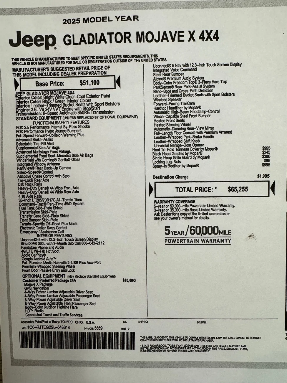

When I bought my 2025 Mojave X, the "X" part was listed as "Customer Preferred Package 24A ($10,000) and lists a ton of extras, nothing related to the suspension....unless because that package includes steel front and rear bumpers (winch ready front), maybe the spring are different for that reason alone?
They never break down spring part numbers or details on the window sticker. Most buyers wouldn't have a clue what it meant if they did.
