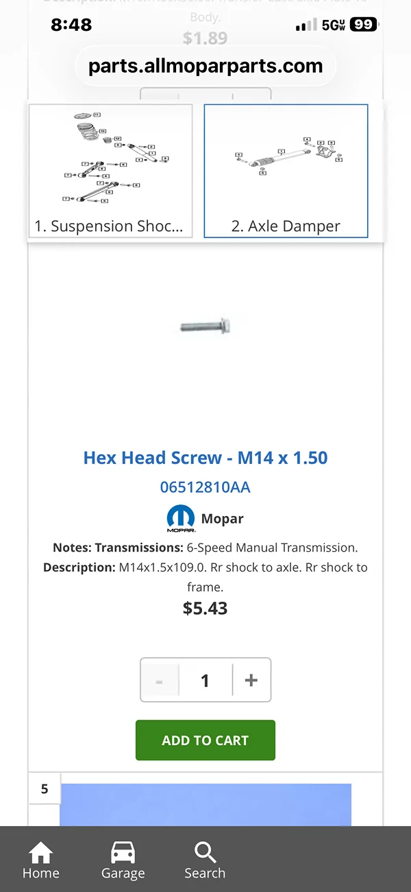

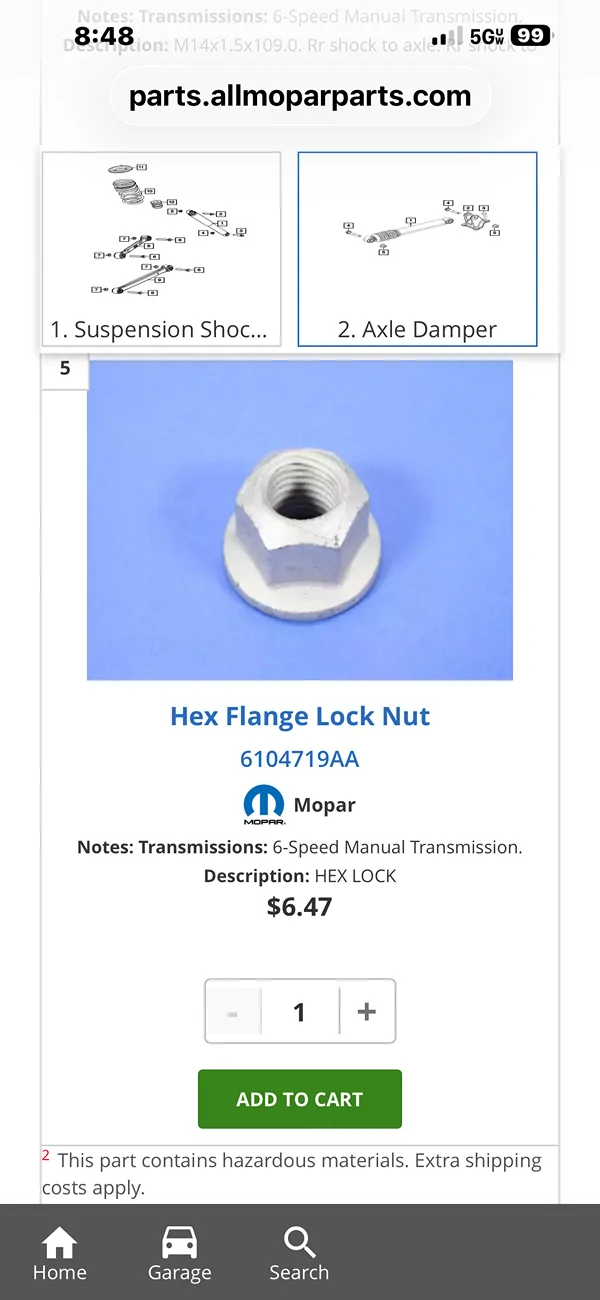

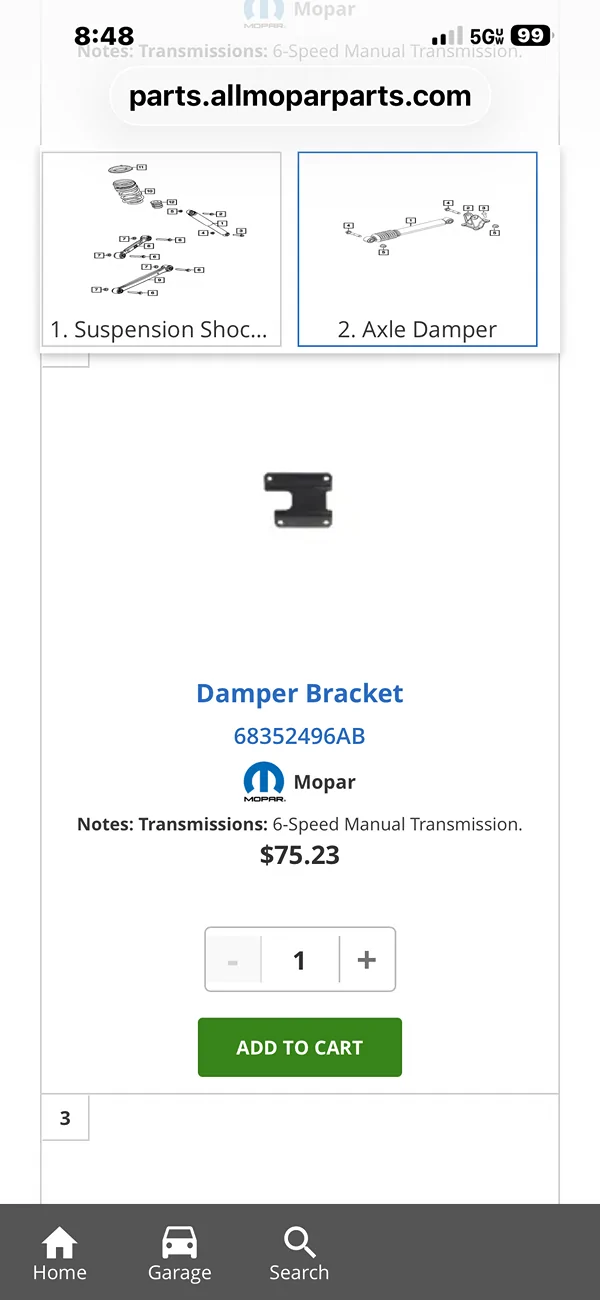

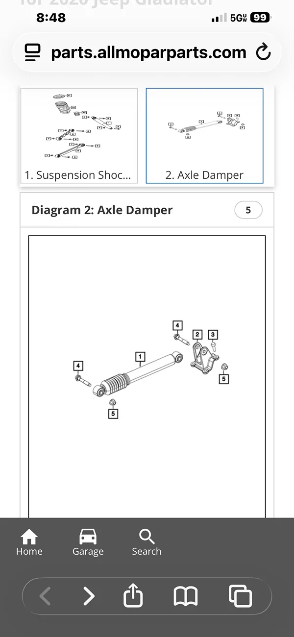

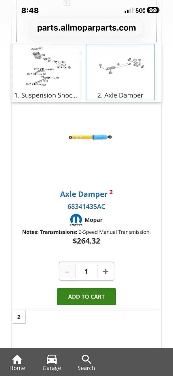

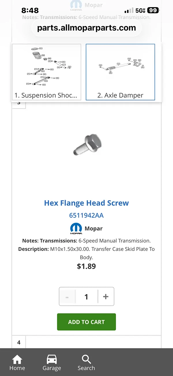

A differential shock that goes from the diff to a bracket on the frame. Some Gladiators came with them mostly stick shifts I think. The thing I noticed the most was the Glady had axle hop sometimes coming over the dunes at beach, played with air pressure but the diff shock stopped it all together. Everyone here that put them on said the rear feels more planted. If you look on top of your diff there are four mounting bases there and that is where the shock bracket goes then up on your frame there is a bracket from factory that the shock mounts to. It is a nice but expensive shock from Mopar…..Jack

A differential shock that goes from the diff to a bracket on the frame. Some Gladiators came with them mostly stick shifts I think. The thing I noticed the most was the Hlady bounced sometimes coming over the dunes at beach, played with air pressure but the diff shock stopped it all together. Everyone here that put them on said the rest feels more planted. If you look on top of your diff there are four mounting bases there and that is where the shock breaker goes then up on your frame there is a bracket from factory that the shock mounts to. It is a nice but expensive shock from Mopar…..Jack
What didja think I just make stuff up😂
I think the issue caused by the pinion angle changes is really a result of the terrible rear suspension geometry. The lowers shouldn't be twice as long as the upper control arms. That diffrence causes pinion dive when the suspension droop which is why the rear feels unstable. I fixed mine with the triangulated rear 4 link uppers that are ~10" longer than the stock uppers. Now the pinion stays pointed at the transfer case throughout suspension travel. I think the shock slows that pinion angle change which helps the handling, but it's still not right (in my opinion). The 4 link improved the ride and made the rear end feel planted even under hard acceleration in the dirt. I wouldn't own a gladiator without it having experienced the difference.

I never said it was cheap, Benny can get them yet probably! I would spend it again , very happy with it even though most say it won’t work!…Jack
