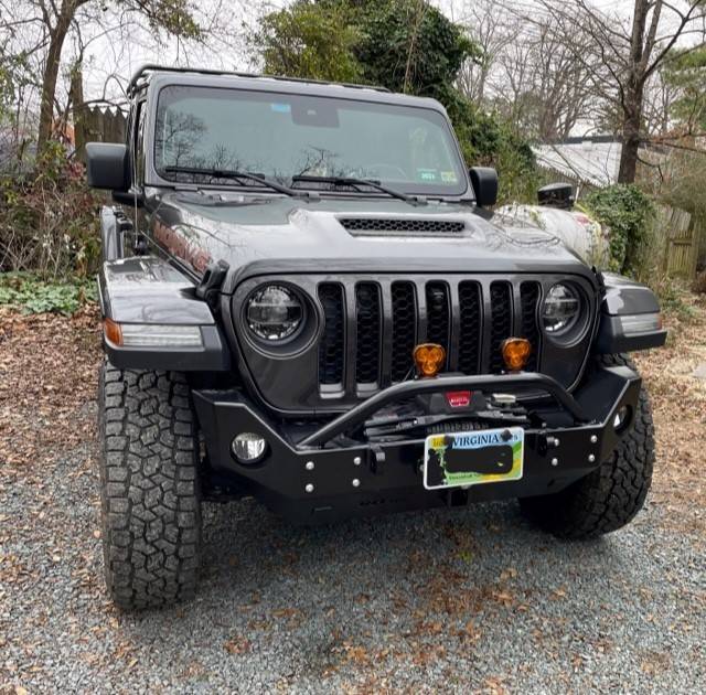

tbh the skid is pretty low hanging and some bumpers like addiction cut the bumper in earlier so it doubles as both. Personally I wish i hadn't gone steel with my mojave. I got a rugged ridge cus it was cheap and just wanted to mount my winch. Mojave suspension is very soft and hanging that much extra weight of the nose kinda ride funky especially with no weight in the rear. I've added a 3/4 spacer up front to fix my ride height. though i would still like and recommend a aluminum bumper. I'm considering pull the trigger on a aluminum version of the mopar modular bumper. i don't remember the brand tho. I'm also investing in aluminum skid plates. The Mojave isn't the best truck to just throw steel armor on as i have learned. The shocks are great and manage well. The springs compress easily and ride rough as its almost always engaging the second rate with extra weight. at least thats how it feels. i added 160lbs to the front i believe, id like to get it under 100.
